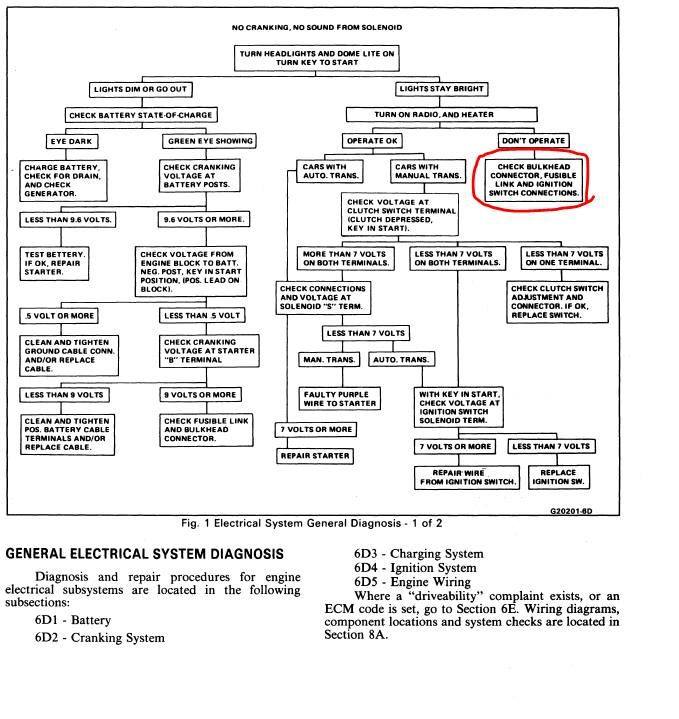

Re: 91 Camaro won't crank?
Originally Posted by Cam_RS
Hey guys I am new to this thread.
https://www.thirdgen.org/forums/tech...formation.html
whenever I tried to start the car nothing happens.
The fuel pump is suppose to prime and the starter should make a clicking noise. But neither of these works?
If the pump is not priming then you have power supply problems ; VATS only effects starter operation
Check the Ign switch operation
https://www.thirdgen.org/forums/post...71-post19.html
You might want to pull the codes and see if a VATS fault is showing
https://www.thirdgen.org/forums/tech...s-dumbies.html

You have to learn to read circuit diagrams like the one I gave you here
https://www.thirdgen.org/forums/post...34-post61.html
You test for power on the yellow wire out of the Ign switch and in and out at the enable relay and the clutch switch

Update, I got the car cranking by jumper wire from starter enable relay to clutch switch (purple) connector wire.
I've done the resistor trick thing, but the car wouldn't crank still. I have the right resistor reading 3.73 compare to my keys value 3.74

Not sure how old this post is but I just bought a 91 with the same issue. After some research on YouTube and other forums it's a very easy fix. Just take the panel off under the steering wheel and find the plug with a orange jacket and 2 white wires. Now I don't have a store that sells resistors so I took a couple out of an old Xbox 360. Just put two resistors together and jump both the white wires. It will bypass the security.
Hey guys I am new to this thread. I need help figuring out about my 91 camaro RS no sudden crank. I bought a new battery, replaced terminals and new fuses. But the problem is, whenever I tried to start the car nothing happens. The fuel pump is suppose to prime and the starter should make a clicking noise. But neither of these works? Although my headlights would work, needles in my cluster gauge would tend to move clockwise whenever I start the car. My cluster gauge wouldn't light up at night, except for INFL rest which the only thing that blinks in cluster.
For anyone else trying to diagnosis this problem, first check your battery is not dead. The 1988 Camaro Shop Manual contains the following diagrams to help diagnose your issue:
https://imgur.com/a/gyjJIuT
