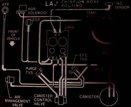

And I don't know what piece you may (or may not) need to replace to improve emissions, but it's probably the switch (threaded into intake manifold) or the just-smaller-than-soda can device with 4 or 5 hoses. See attached; should be close to your 83. Good luck.
edit: added another pic.
Attached Thumbnails Carborator help!-82catalyst.jpg   Carborator help!-cam01368.jpg
