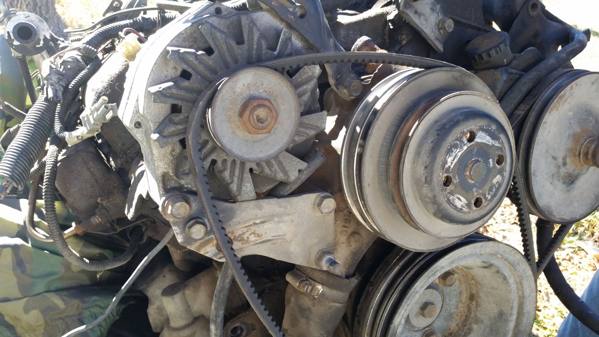

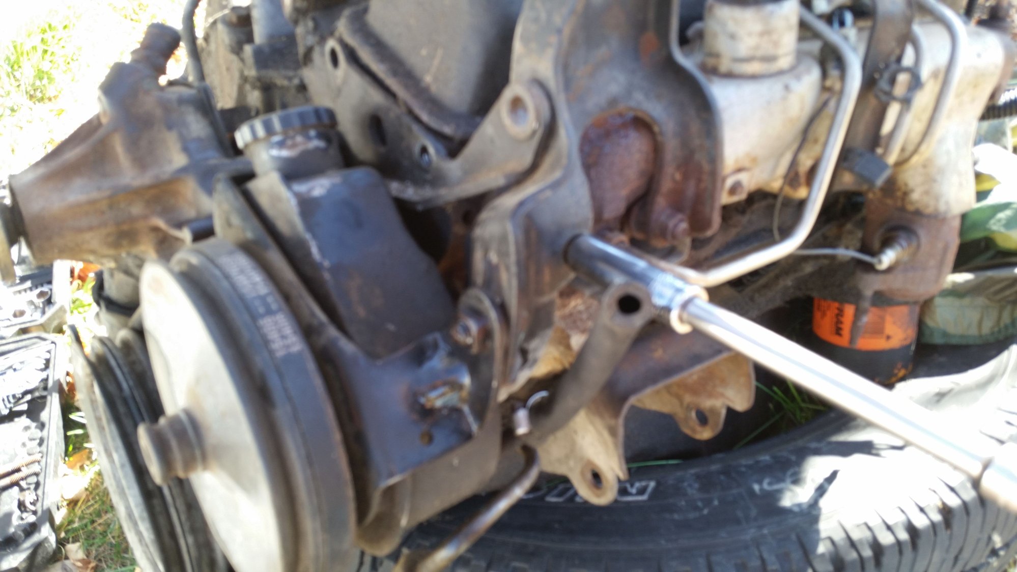

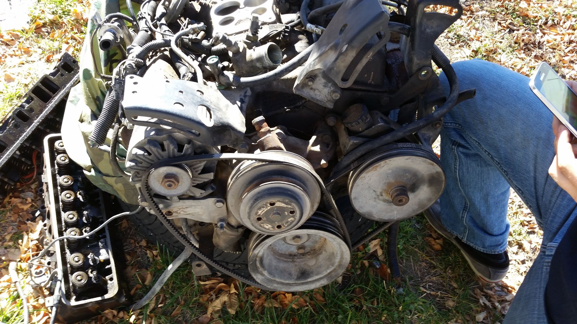

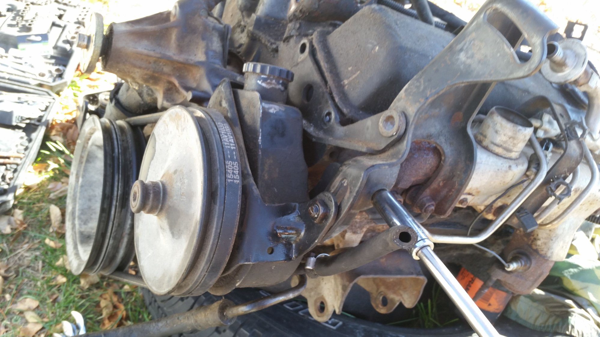

These are all my accessories mounted on the old 305. Now that I look at the pic I realize I was using a different water pump pulley yesterday. :/

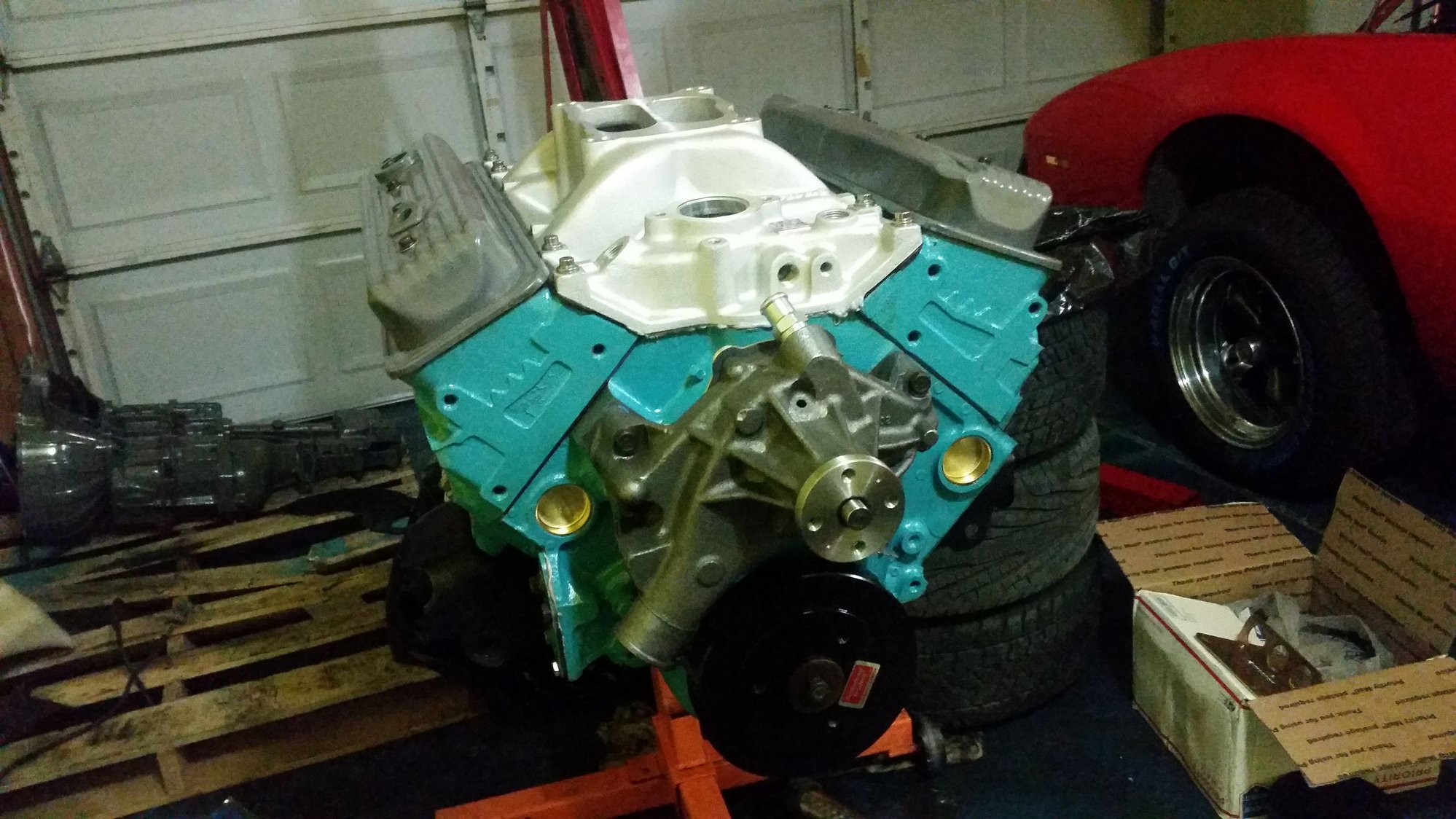

New engine. Trying to remember how the bracket under the alt mounts near the water pump.

The water pump for serpentine setup is reverse rotation (driven by the backside of the belt) GM changed the bolt spacing on the pulley so it cant be used with a v-belt pulley. As far as the belt alignment goes there is about a thousand different setups you will have to rummage pulleys till you find one that works.

Ok so I'm retarded - had the water pump pulley on backwards so I should be good once I figure out how the bracket to the left of the pump bolts on. Any suggestions? My water pump bolts are too far recessed for the bracket to bolt directly to it. Now that I look at it, I'm guessing there was an ac compressor mounted on the top right so I should be able to take those two brackets off as long as I'm able to have everything spaced correctly so the belts/pullies line up.
