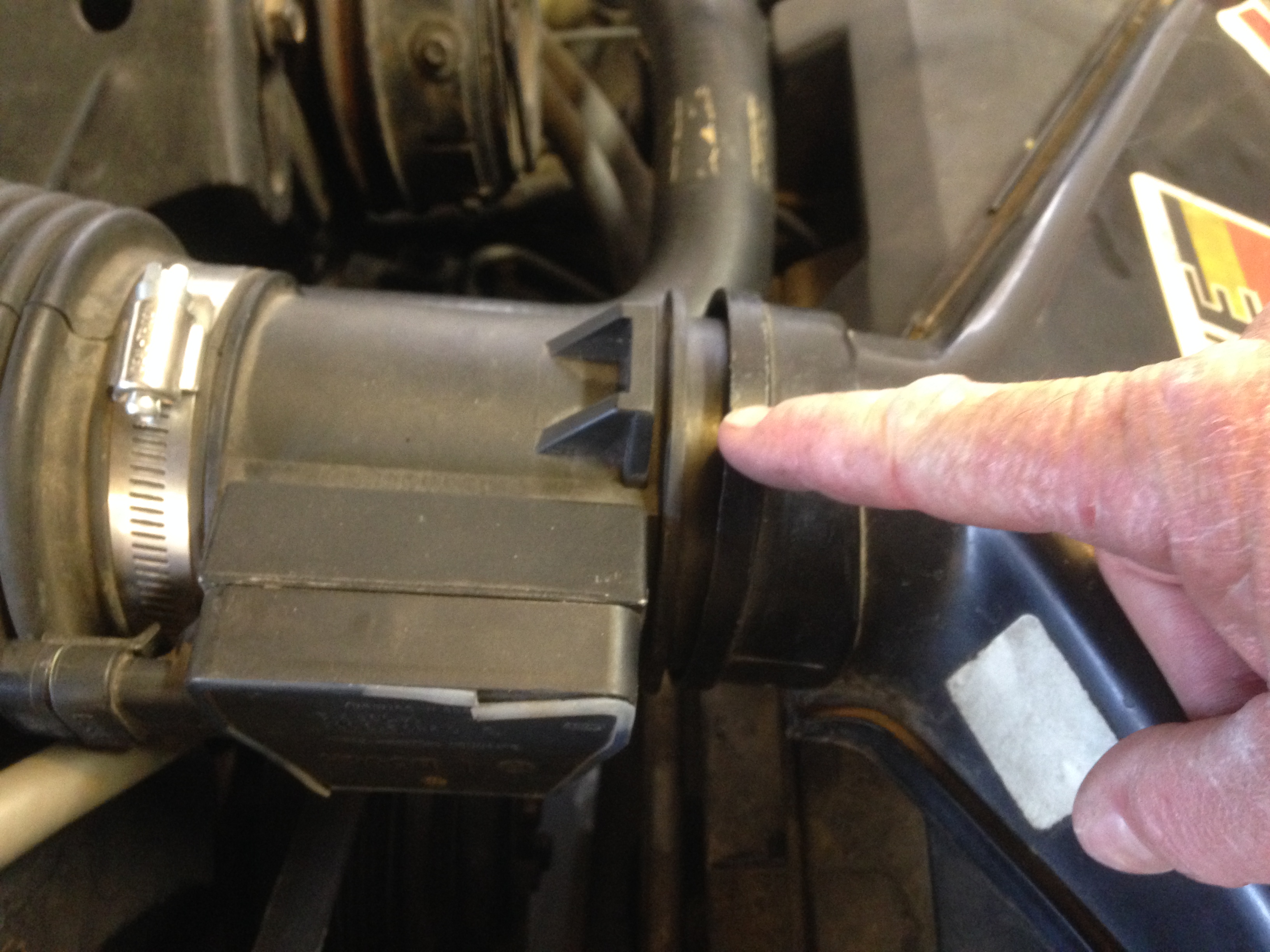

Here's a picture of the vacuum gauge at idle. Rev the engine to about 1200-1500 and it goes into the green.
I played with the timing a little but will try again after the valve adjustment. About to check the compression. Any idea where it should be? I know I want them all about the same but don't know what a good reading is.
Also a pic of the connection point of the MAF to the air cleaner assembly..

Was that vacuum gauge needle fairly steady while idling?
It's tough to call what compression should be, I'd be hoping for roughly 160 on a stock motor. It's relatively trivial, though you wouldn't want anything lower than 140ish across the board. Make sure you pull all plugs, open the TB, and disconnect fuel somehow so you don't flood the chambers.
I think there was a specific clamp made for that connection of the air cleaner. I may have a spare one...I'll check for you.

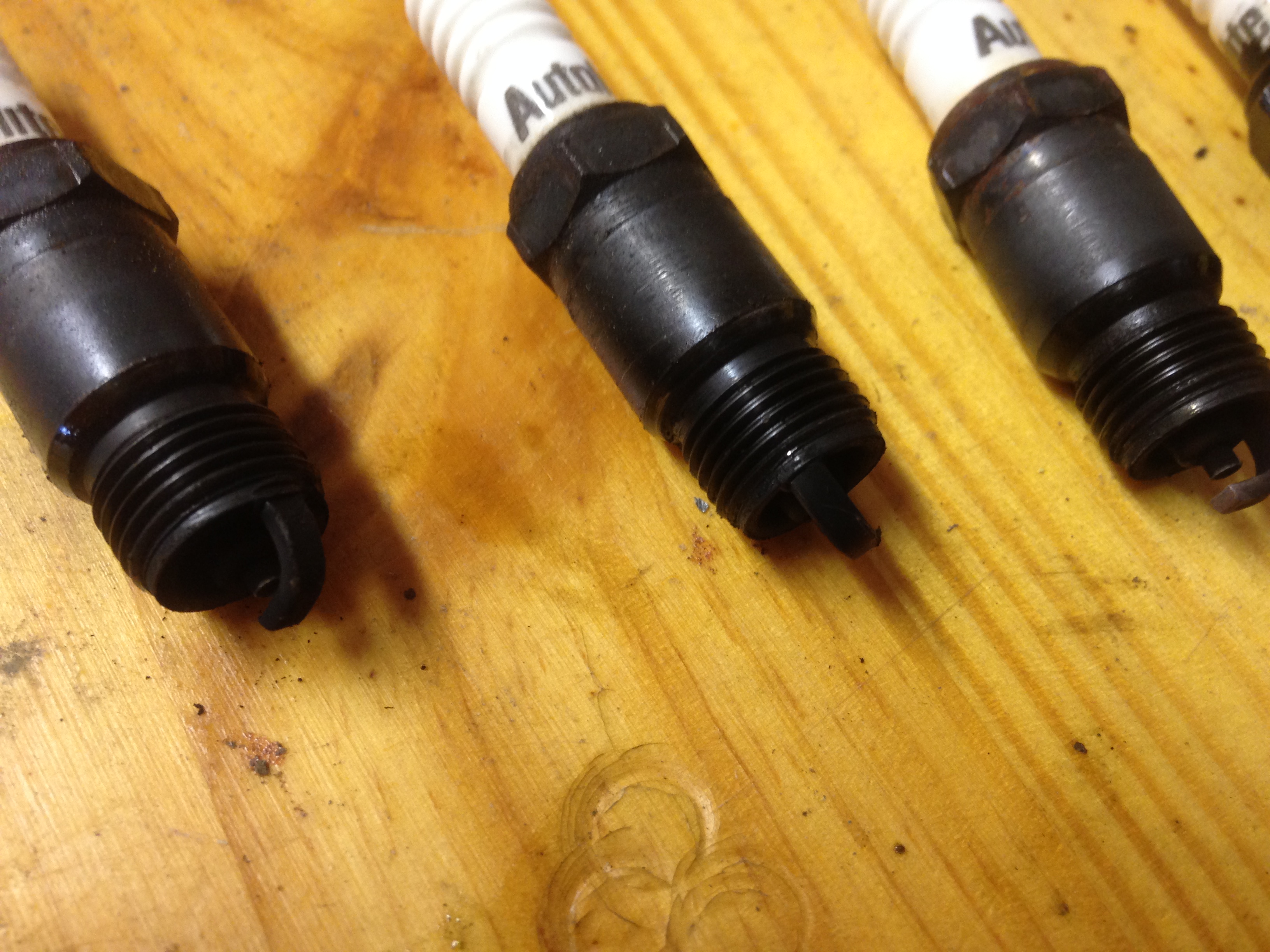

The machinist told me sold the guy an "RV" cam which is not stock but very mild. How could I have 7 of 8 cylinders so bad? Can't all have bad rings.?
Here's a picture of the plugs. All 8 exactly the same. Black soot all over them. Not wet at all and it does not smoke.
Help guys...

Possible all but one cylinder's valves adjusted wrong(too tight, valves stay open)...poorly built or poorly broke in engine causing the rings to never seat...gauge not seating correctly to give accurate measurements...valve events off time (cam, timing chain)...

I agree with aliceempire. If it were mine, I would readjust the valves and see if those compression numbers come up.
I readjusted the valves yesterday and they were super tight. The guy never drove the car cuz he never got it running good enough to drive it so the rings may have not seated properly? Also make me wonder since the valves were so tight the ones left compressed could have gotten some rust on the mating surfaces. (I did see some rust in there when switching out the intakes) Going to try a leak down test per my new buddy in Oregon. He says pump about 100PSI into each cylinder and see if it leaks out the exhaust or intake valves. He also suggested I squirt a little oil into each cylinder then re-try the compression test. If compression goes way up, got a problem with the rings...
Good news I guess is that I think I finally found the problem. Would rather it be a sensor or something easy..
