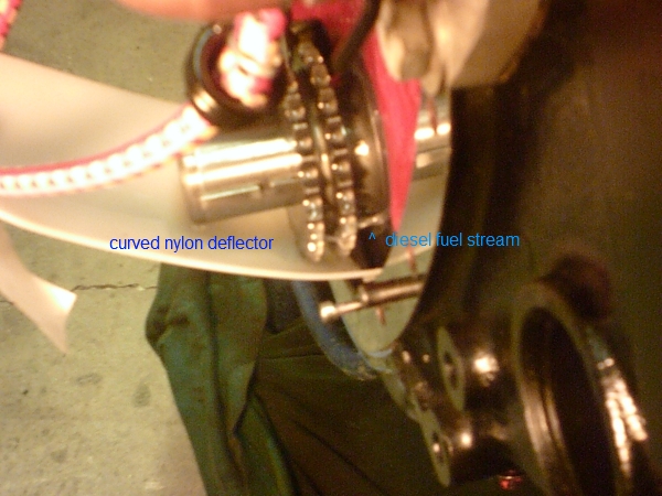

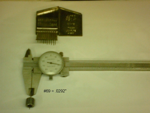

What was your reasoning for holes in both lifter galley plugs?
You will have a flood of oil flowing under the timing cover.
The reason I ask is that I had a problem with my 334 SBC where the lifters would not pump oil to the rockers. I ended up completely troubleshooting the oiling system by using kerosene and running the oil pump with a preluber shaft and drill motor. Also to flush all the oil passages after a cam lobe started on its way to becoming circular. Here is what I learned in the pictures.
The pictures are not the best, I know. But notice the diesel oil streams shooting out from both parting lines in the front main bearing. This alone would be plenty of oil to lubricate the timing set. So the extra holes in those plugs is not needed, and I replaced my drilled plug with a solid one after witnessing this.

Holes in the lifter gallery plugs are for increased oiling to the timing chain. The chain is normally splashed lubed. Drilling those small holes allows pressurized oil from the lifter galleries to sprat lube the chain. Hole are very small. Usually less than 1/16".
The gallery holes also limit the amount of oil going to the lifters, pushrods and rockers. On a high rpm engine on a dragstrip, it's easy to pump so much oil through the system that the valve covers are full of oil at the top.
Those valley screens in the above picture also slow oil flow back to the pan. In my engine, I have no screens. I want the oil to get back into the pan as soon as possible. I also have drain hoses at the back of the heads which allow oil to drain straight back into the pan without having to flow through the lifter valley and down onto the crankshaft.
