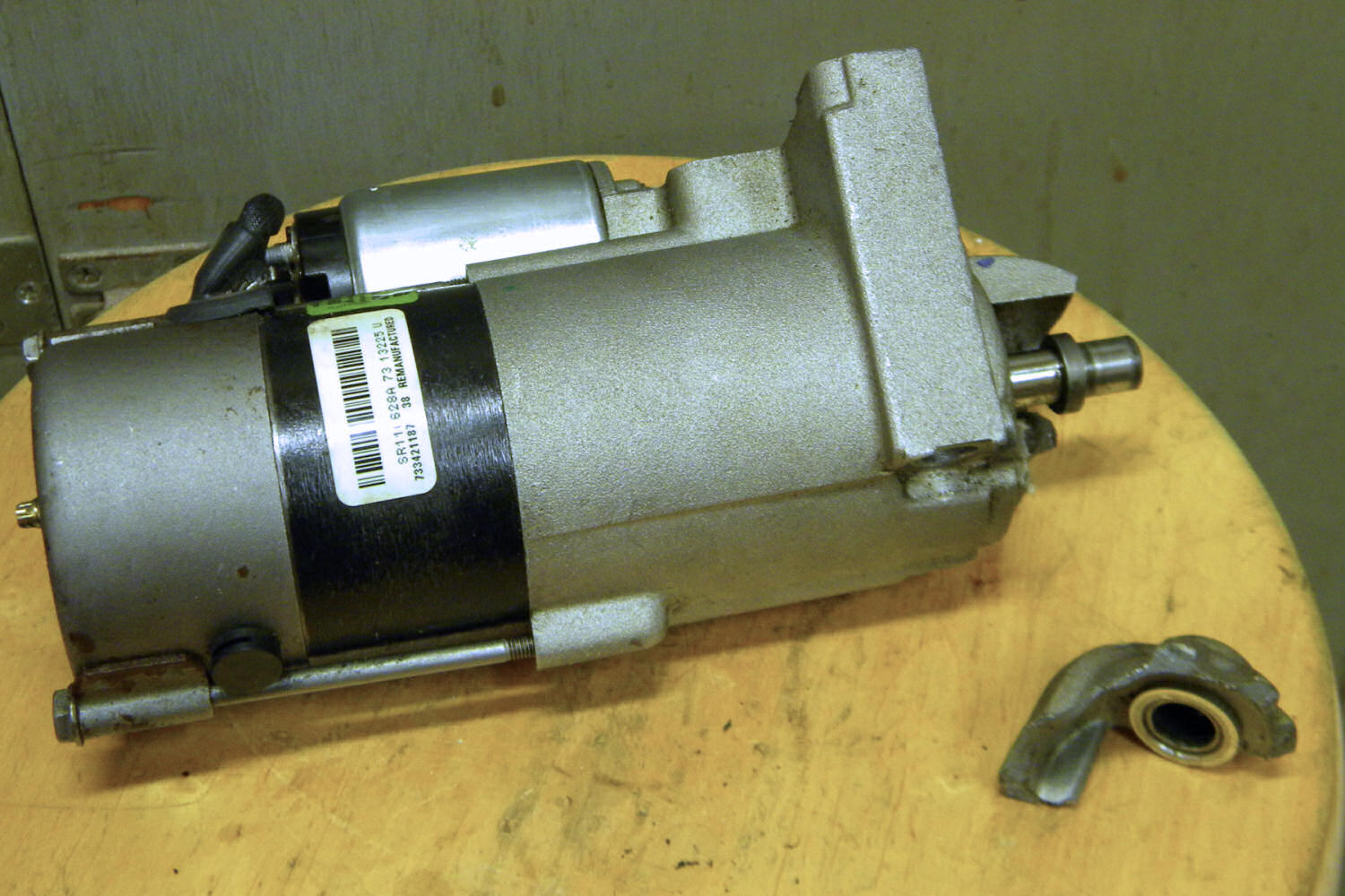

Wtf. What the frick did I do wrong
I guess I now know why I was gettinggetti "no start"
This starter is less than 6mo old from autozone

Three questions come to mind here .
#1 , are you using proper starter bolts that were in fact tight ?
#2 , was the bracket that mounts from the back of the starter to the engine in place ?
And
#3 , was it properly shimmed ?
If yes to all three , maybe it can be blamed on cheap metal , AKA "Chinesium" ?

Prolly bolted it onto a block that has The Starter Bolt Hole Problem.
That's one of the things that that particular Problem does.
70s 350 block? 010 casting? got an INCREDIBLE deal on the block? was running when you bought it, but you didn't ACTUALLY hear it run, but the story that came with it didn't make ANY SENSE WHATSOEVER? (yf wanted something that got better gas mileage; cost too much to run in the bracket I was in, wanted to drop back one bracket; numbers didn't match my Vette; something like that) ???

Proper bolts,
no rear bracket
No shims, didn't seem like I was having a problem
yes it's a 010
Just strange to me. I was just trying to set the timing it had a small backfire and then the starters was just spinning then it stopped spinning. I climbed under it and this is what I found

As to broken starter nosepieces... that's caused by The Starter Bolt Hole Problem, wherein the starter bolt hole pattern is drilled too far from the crank centerline. Obviously if the block is fornicated that way, there is NO HOPE that a starter will EVER align properly. It will always be too far from the flywheel or flex plate. Adding shims will just make it worse. It will always crank slow and make that horrible grinding noise that you can hear from 400 yards away in a busy grocery store parking lot. An easy way to identify it is to put a 1/8" shim in it: if it gets MASSIVELY worse, then the diagnosis is inescapable. 70s blocks in general are afflicted. It seems that the factory had about 3 gang-drilling machines that were used to install the bolt holes in blocks at that step of their creation, and one of them was allowed to drift WAY off, starting in around 70 or 71, and wasn't noticed until about 79 or 80. It affects small blocks, big blocks, and 6-cyls, apparently all of them in that foundry went through that same machine. I have a 74 454 for example, that has it so bad, that I got the car in about 86 or 87 for $1600 (it's a Caprice convertible... robin's egg metallic blue, white top, white interior, 454/400, BEAUTIFUL absolutely maxed-out car, I've rented it out to people to use in movies and commercials... think on that for a minute) because it would only just barely start in the used car lot if they hooked up a booster and another car to it; then I put a 3560 (cast iron nosepiece) starter on it, and it broke just like the pics up there, and fell DOWN TO THE GROUND. I put a 4347 starter on it, which started appearing in replacement catalogs around 73 or 74 for non-existent applications like Checker taxicab with 454 and Powerglide, but was NEVER an OE part, and it's set up with the starter motor shaft about 3/16" closer to the crank, thus giving room to shim it out in a normal fashion. No idea whether that part # is still around, last time I bought one was in the early 90s. Same starter "motor", just a different nosepiece. And of course it'll replace that 3510 (aluminum nosepiece) like in the pic, as well.
So yeah, The Problem isn't the starter, and can't really be fixed at that level, at least not with another stock starter. These days, might be best to move directly to one of the mini-starters that use a gear reduction. I'd recommend one based on a Nippondenso motor rather than a Hitachi motor, for this situation, even though it's not quite as friendly of a retrofit.

Well, actually, there IS one way to rectify "The Starter Bolt Hole Problem" but it's not especially easy.

And starters sometimes break even without being loose or misaligned. This is the third one (including the original) to have failed on an LT1:

DING! DING! WE HAVE THE ANSWER WHY!
(quote) I was just trying to set the timing it had a small backfire and then the starters was just spinning then it stopped spinning. [/QUOTE]

....... I was just trying to set the timing it had a small backfire and then the starter was just spinning then it stopped spinning. I climbed under it and this is what I found
(quote) I was just trying to set the timing it had a small backfire and then the starter was just spinning then it stopped spinning.
[/QUOTE]
If it was truly just a simple backfire , and not Sofa's misdrilled block that caused the fractured starter , I'll go out on a limb here and say that if the rear bracket had been in place I'd bet the starter wouldn't have broken in the way that it did . Sure I know what your thinking , It likely would have broken at the next weakest place (stripped the one way cogs in the Bendix perhaps) , but , every broken nose cone I've ever seen on a starter was on a starter that the rear bracket had been absent (Thankfully I haven't yet run into one of Sofa's misdrilled blocks) ...

Vortec truck engines break starters all the time due to bad dist caps jumping spark to the wrong cyl..

Said that the problem was that he never worked on an engine with vortec heads and in his opinion they seem to be inferior so whAt I needed to do was buy his modified camel humps valued probably around about $1500 and he could make the car fly. He would have to pull engine out a 3rd time and then he would finally have the cam degreed and will have to order another $300 in head gaskets (even though these have been changed twice both times with 0 miles on them) and like I said buy his heads.
Fellas I got the car home with the same setup vortec/xe268. And in less than 8hrs of tinkering its purring like a kitten.
I think the comp cam 292 along with the 750dp with all the cheaters/big squirter stuff is what the problem was.. and all the 100+octane
If I can get the starter on with the rear bracket and get the timing a little closer I believe I'll get more than 3.5yrs out of it. Esp since this time the cam is broke in and the everything was line honed and made true. Not a track car just a weekend cruise and play with car. 300+ is just fine for me
Next year I would love to find a mint dash pad have to mount tach somewhere else or a whole new gauge cluster to make it clean/stock. Ooh yeah! and get a decent (not show quality) paint job car has almost no rust or dents. Finally minitub and some black chrome grandsport staggered 9/12 front/back

You have NO IDEA how much of what I tell people on here, is intended to improve just exactly that... to try to get them out of that fear of the unknown, and reason through whatever situation they're facing, and to TRUST THEMSELVES instead of falling for the "fabled lore" of the Friday night McDonalds parking lot monkey-spank. It's harder for somebody that's been brought up in our force-feeding educational system to do, than it should be; especially for people who've been told all their lives that they're "not good at" intellectual pursuits like reading, writing, math, science, etc. where you HAVE TO think for yourself.
Congratulations!!
found it!!!!
I had wires 6&8 were crossed. Then my ignition module went out, I changed it and the coil out for one in my 78c10, I grabbed a piston stop and found out that 0 on my harmonic balancer was not tdc.... in fact about 9 degrees afdc on the balancer was true tdc... I lined it up with 8btdc on the timing tab and checked the dizzy. Found out it was a tooth off. Took dizzy out turnee it a bit. Started wiring with that cap tower 18436572. Checked fuel pressure GAUGE got 0 psi. Took lines loose realized fuel pump is running but not pumping ( raggedy after market $18 pump) I ordered an ac delco itll be here in a few days. I hit it with starter fluid and voila.
When I change the pump I'll be good to go. Thx everyone I really appreciate it!!!!

....... I grabbed a piston stop and found out that 0 on my harmonic balancer was not tdc.... in fact about 9 degrees afdc on the balancer was true tdc...
.....When I change the pump I'll be good to go.....!
Er , not so fast there budget builder , it sounds as if you owe it not only a pump , but a new harmonic balancer as well . You have described the classic balancer failure , the rubber has deteriorated and let the outer weighted part slip in relation to the inner part that holds it to the crankshaft .

Brand new balancer!!!!!! But of course that means nothing!!!
Update!!!!!!!
THEY DRAINED MY FRIGGIN TANK!!!!!
all that's wrong with my fuel pump is it didn't have anything to pump. If u only knew the things I've been thru. U would know why I'm pissed. They were trying to get me frustrated so I would sell the car for peanuts... but they didn't know I had thirdgen.org. thank you all and I will piwiup another balancer. The car so far doesn't have anything else wrong with it. They asked me what was the bottom dollar I would take for the car I wondered about the question but I think now I know
Trust yourself, learn, and put in the work dont make a $4800 mistake like I did. Thank u all

7:30 this morning,, purrs like a kitten... once warm I can stand outside and just tap the key
