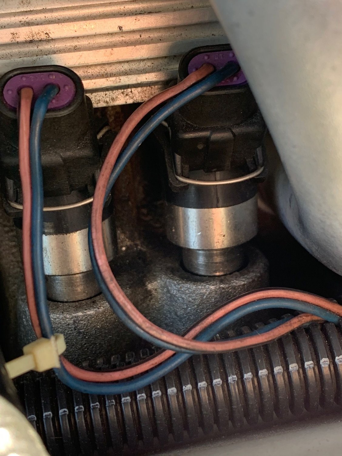

Kinda look like it, any part number on the top body of the injector ?
Re: 5.7L TPI Bad Fuel Injector...what size is too big?
I will have to pull the connector off and check. Are they prone to failure like the Multec? Not sure if these came stock on 91' but if so they are almost 30 years old and probably have had it. The car sat for a long time I think before I got it.

they look like the Rochester/multecs.
Sofakingdom...no need to grind down the fuel rail mount or add any type of spacers. The bosch lll injectors are shorter than stock however that's why we designed a custom adapter and oring that fits on the bottom of the injector which makes it a direct fit on stock set ups. We've been using them for many years.
