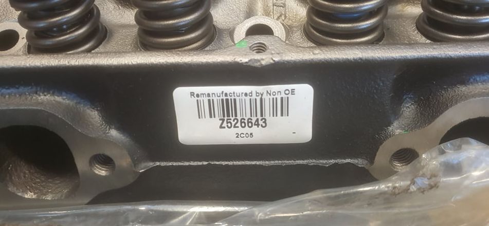

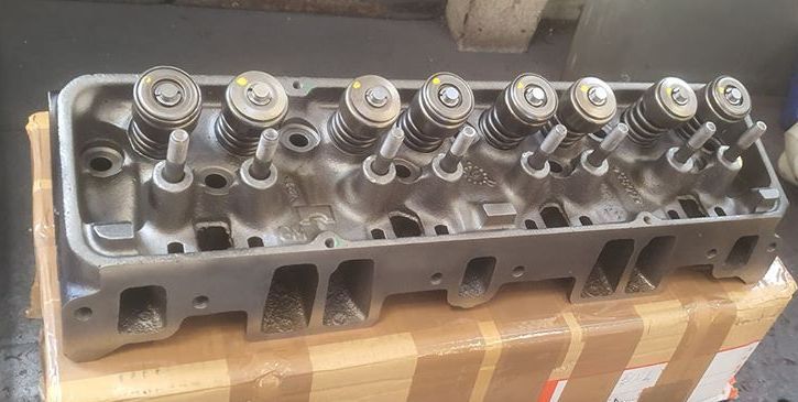

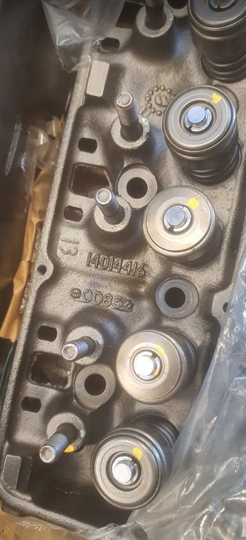

Can you help me ID these heads ? says they made in Mexico but cant find white sticker number anwhere
Do an internet search for the casting number - 14014416. You should get specs; chamber volume, runner volumes, valve sizes, eyc.
I thinkt hey're the same as the 081 heads but with perimeter bolt VC's.

Those are 416. VERY common on early-mid 80s 305s.
They are different in several respects from 187.
  • Perimeter valve cover bolts, compared to center bolts
  • Slots in the casting for the push rods to guide the rockers, as opposed to large holes in the heads and self-aligning rockers
  • All 6 intake bolts are parallel and perpendicular to the surface of the head, as opposed to the center 2 being more nearly vertical and not perpendicular
  • Reasonably good intake ports, as opposed to the ultimately crappy (for performance) swirl-port design of the TBI heads
The white sticker came from some "rebuilder". No doubt, whoever cleaned them up and put them in a plastic bag. It means nothing as far as identifying them.

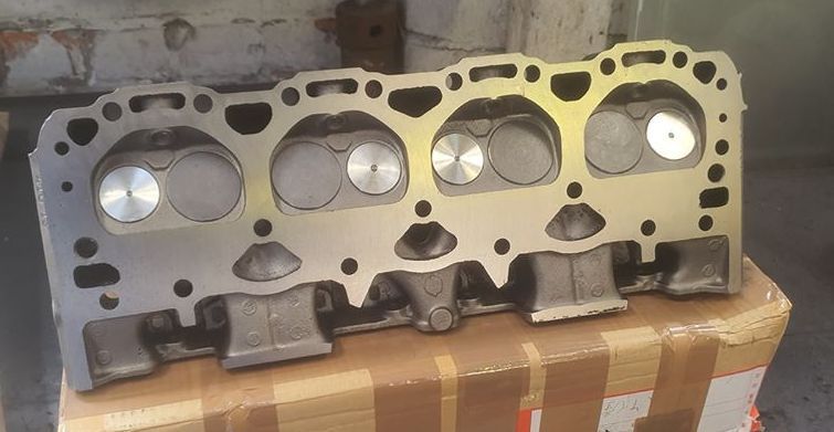

Thanks guys, i understand about the 416 heads but wasnt sure about the remanufactured part and made in Mexico ...
So they flow a little better due to no swirl port ? on a 305
there are so many mixed comments one site says "prone to cracks" are they the light heads.....
if the swirl heads are ok under 4000 rpm im ok with that vs cracking heads,

MANY GM parts are made in Mexico. Costs are MUCH lower down there than in the US or Canada. Many parts get "remanufactured"; they hardly ever are very much improved by any of it however.
416 doesn't have a "cracking problem" any more than any other SBC casting. That's not something to get all worried about.
The intake bolt angle and the rocker alignment mismatches are FAR more significant matters.
On a 305, I doubt you'd be able to detect much difference between swirlies and decent heads in any case, especially with an anywhere near stock cam.

Can the intake holes be slotted to sort that out if needed ? and rocker missmatch....is the not sitting out the valve head

Yes the intake holes can be slotted.
Yes you can change the rockers. There are 3 commonly used methods of guiding them found in small block Chevy motors (well, 4, if you count $$$$$$shaft mount$$$$$$), of which ONLY ONE must be in effect at a time. The 3 are, the narrow slots that fit tight to the push rods, such as those 416s have; guide plates, which bolt on below the rocker studs (which the heads are machined for) and similarly grip the push rods; or self-aligning, in which the rocker tip has 2 little nubs, one on either side of the tip, that center it over the valve. One AND ONLY ONE must exist. If more than one is present, they invariably "fight" and try to align the rockers slightly differently, and SOMETHING will bind up, break, wear real fast, shed metal chips, and otherwise act unhappy and make the owner even unhappier.
187 heads generally came in motors that used self-aligning rockers and had large holes in the heads to allow the push rods to go wherever the rockers required them to. You CANNOT use those on 416 heads unless you enlarge those slots into holes. Or, you have to buy rockers.
That ONE piece of machine work or parts purchase ALONE can entirely overwhelm the difference between a "free" 305 and BUYING a 350 core.

@@sofakingdom I wish I could get junk parts like you say thats not possible here, no wrecker yards with chevy parts here nothing.....ever....zero....core 350 here are 2k +
why cant the 416 heads in the picture above be used as they have the self aligning pushrod hole and no guide plates.

They can be used.

those heads in picture the guy wants 650 bucks....more than a engine
