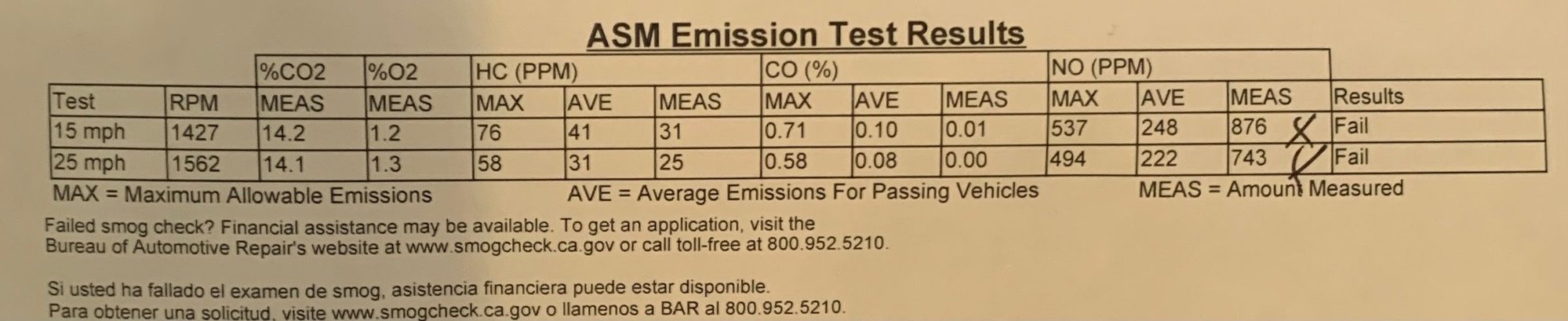

Need a little help passing CA Smog
UPDATE: Passed!! Wrap up at the end of the thread.
Stock 5.7 with a mild cam and BBK 52mm TB. Engine has 2,000 miles on it.
Cam:
Just missed the NOx. 650 vs 450 to pass. Last time when my EGR was not working, NOx was 1200+ so I am close.
I am buying a new Walker California Catalytic (not sure how old the one is in there but it looks fine), Scott Hansen sent me a slightly richer tune but said everything looks good and suggested I check/replace the EGR temperature sensor. My smog pump is hooked up, about three years old, and diverter valves functioning (last time I checked).
Any tips/tricks?

Here is the first run back in November- rebuilt near-OEM L98 B2T (mild cam) with old walker CAT. Timing 8deg BTDC.
Same with 2 gallons of E85 in about 10 gallons of 93 octane yesterday. I need to say that this was a different machine. My first guy's machine broke and it has not yet been repaired.
Interesting how the E85 did double the measured HC (still fine) but nothing for the NO.
I think my old aftermarket cat is suspicious. It's been through quite a bit. I ordered a new Walker 81124 and will have it installed next week and report back.
I am also going to take a deep dive to make sure my EGR system is working 100%.

But I'm failing on NOx. And those results are so clean it makes me wonder if your smog guy knew the difference between a tailpipe and a hitch receiver.
Old Jan 8, 2021 | 08:47 PM
84 1LE's Avatar
Joined: Nov 2002
Posts: 6,664
Likes: 414
From: Oyth
Car: 89RS vert
Engine: Erod
Transmission: 4L65e
Axle/Gears: BW, 3.27
Re: Need a little help passing CA Smog
Why the difference in RPMs from the first test. Did the tech leave it in 2nd gear the first time? Would the lower rpms make nox rise?

Holy grail recovered! Passed CA smog with flying colors.

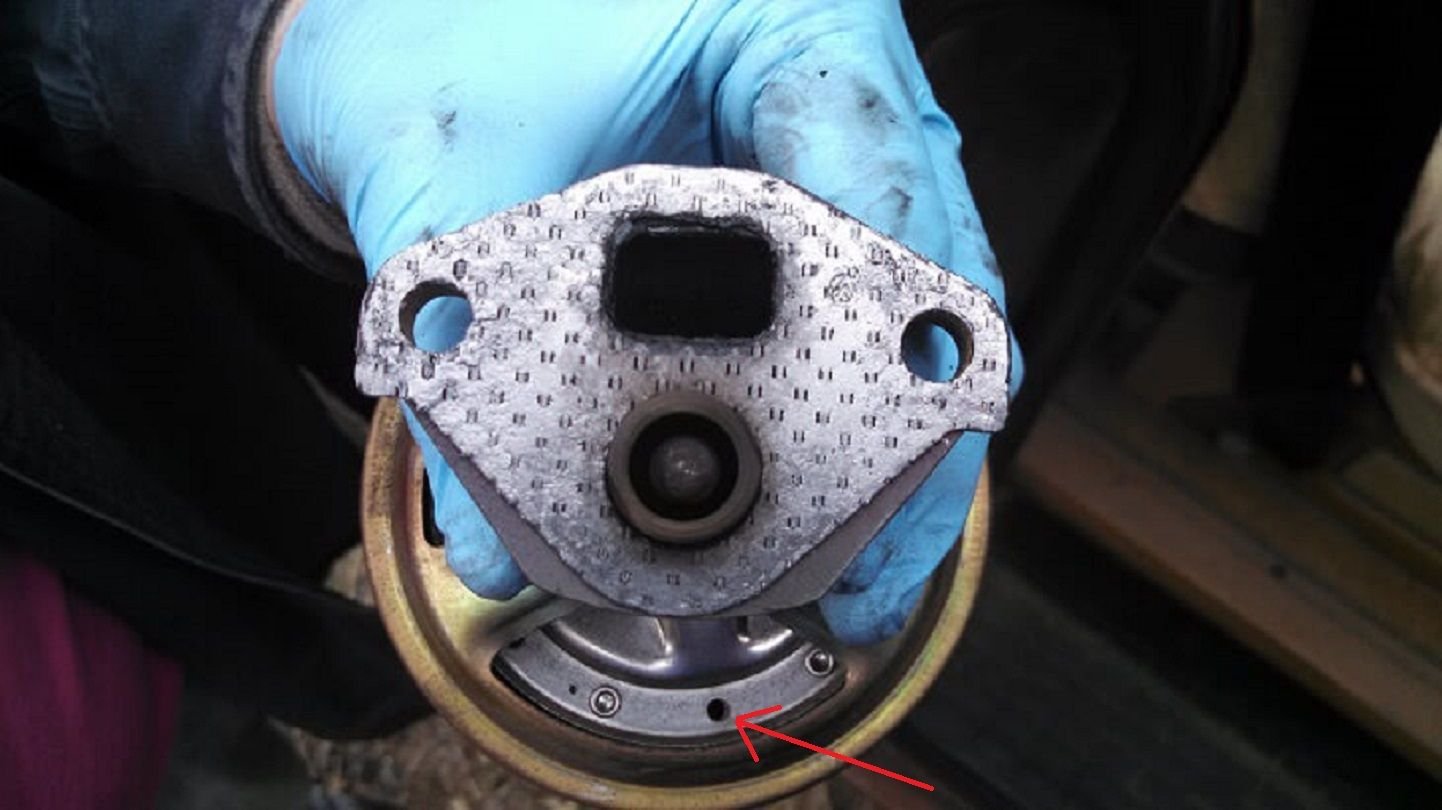

Put in a new Walker CalCat which didn't help.
Replaced EGR valve, checked EGR valve solenoid, replaced EGR sensor, replaced vacuum lines - Passed.
I studied the EGR valve itself a lot. It is a sensitive valve which is why it is so expensive. What makes it sensitive is the "negative backpressure" disabling feature. All it means is is that if there is no or too little exhaust backpressure, any valve diaphragm vacuum is vented and the valve will not actuate (remain closed, no EGR). This is purely a failsafe for a stuck solenoid and idle conditions. That is why for those setups that have very little backpressure at the CA test load conditions, a proper functioning valve may not function.
It was invaluable for my tech to have a vacuum gauge watching the vacuum on the solenoid. This watched whether the valve was open or closed.
What my tech found was that in the upper range of the acceptable RPM/load test range, he could see the EGR valve was open. On the low end of the range, he could see it closing. All he did was run that portion of the test in the upper range and it passed.
Dumb but critical.
Thanks for all the help here.
