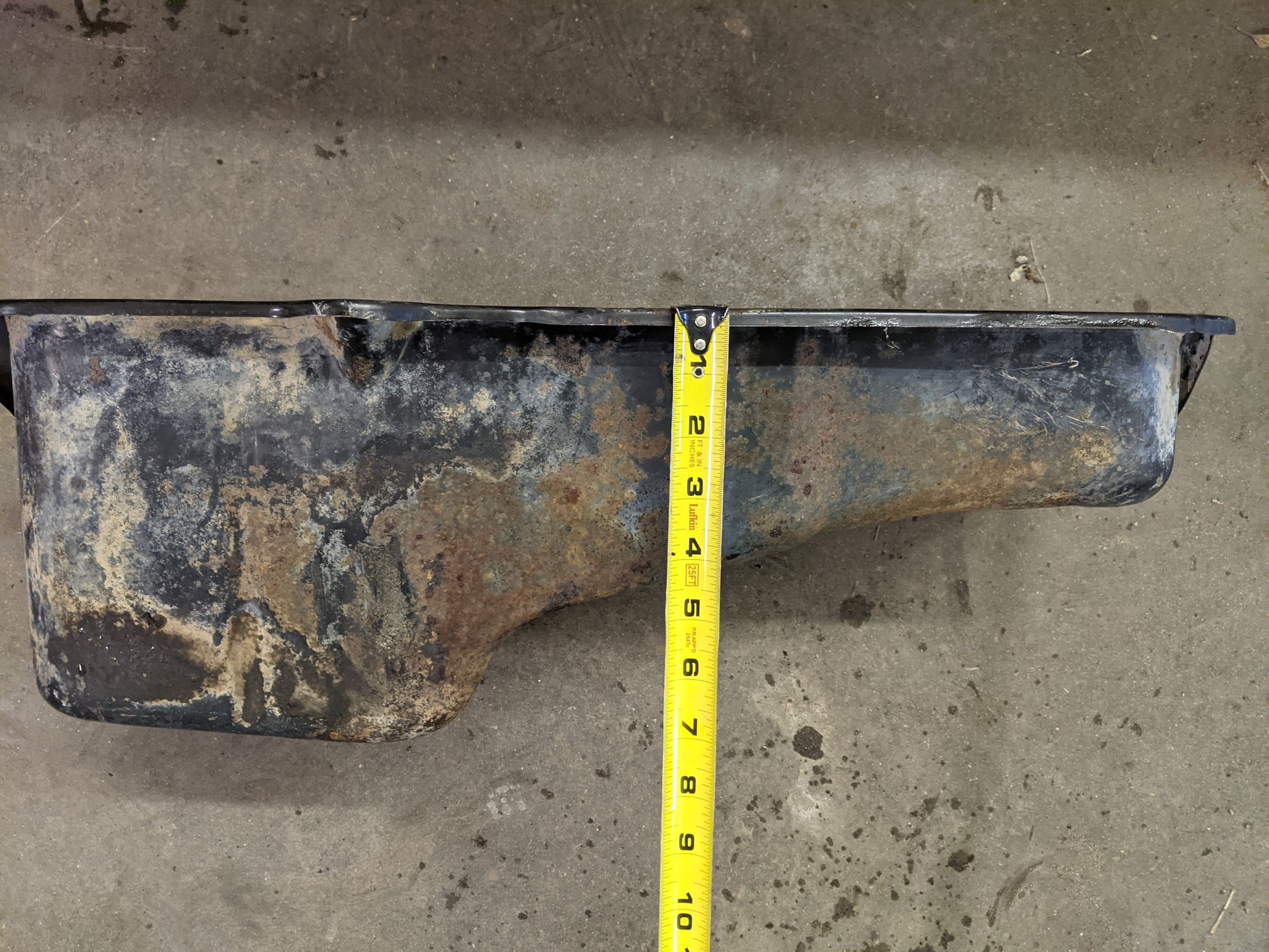

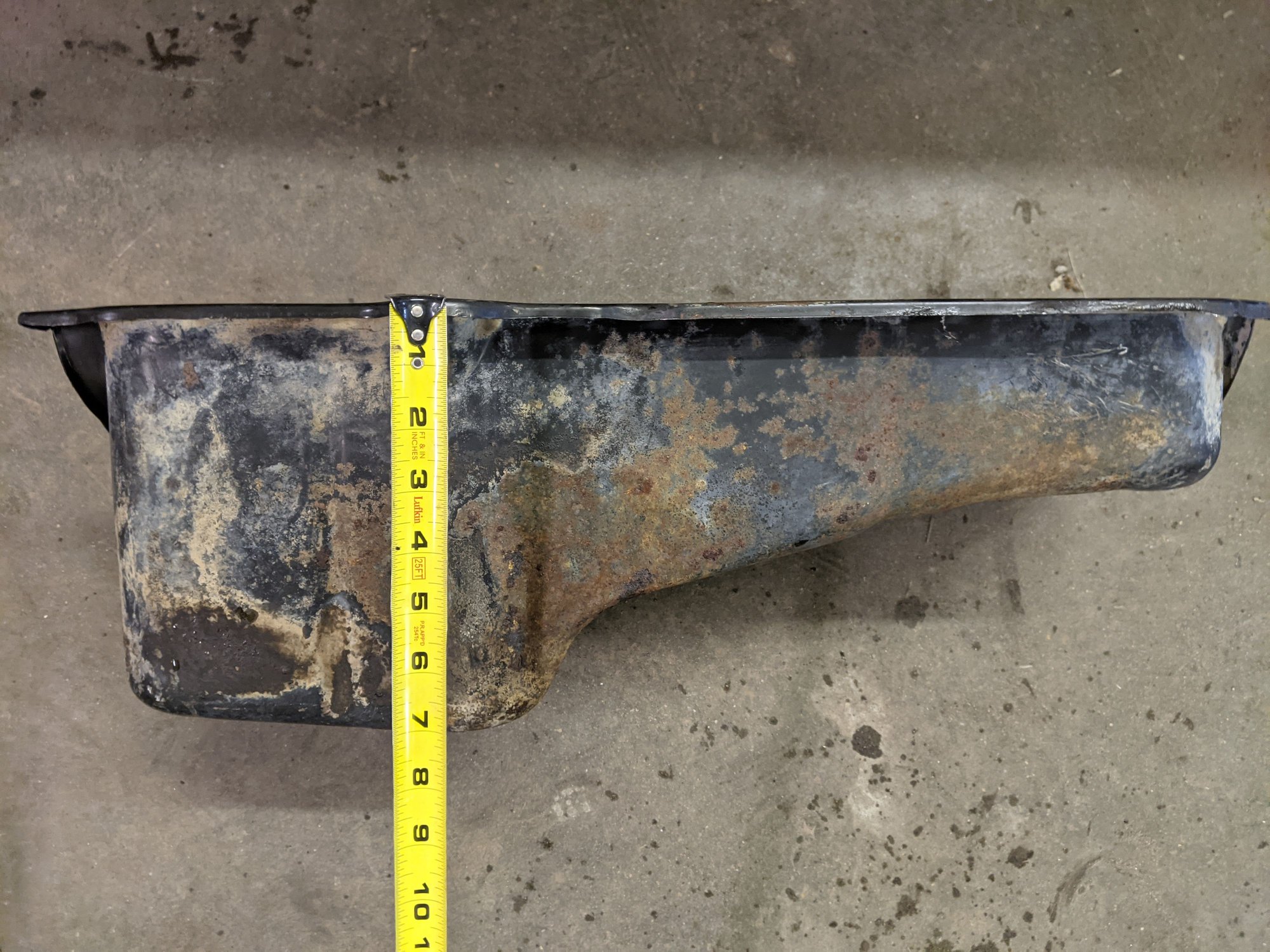

I pulled the L31 truck pan out and took some measurements. Before I clean it up, Does anyone know if this will fit in the 1987 Camaro for sure?

It's the 4" deep section that might cause issues. That's the area of the crossmember that might need to be modified.

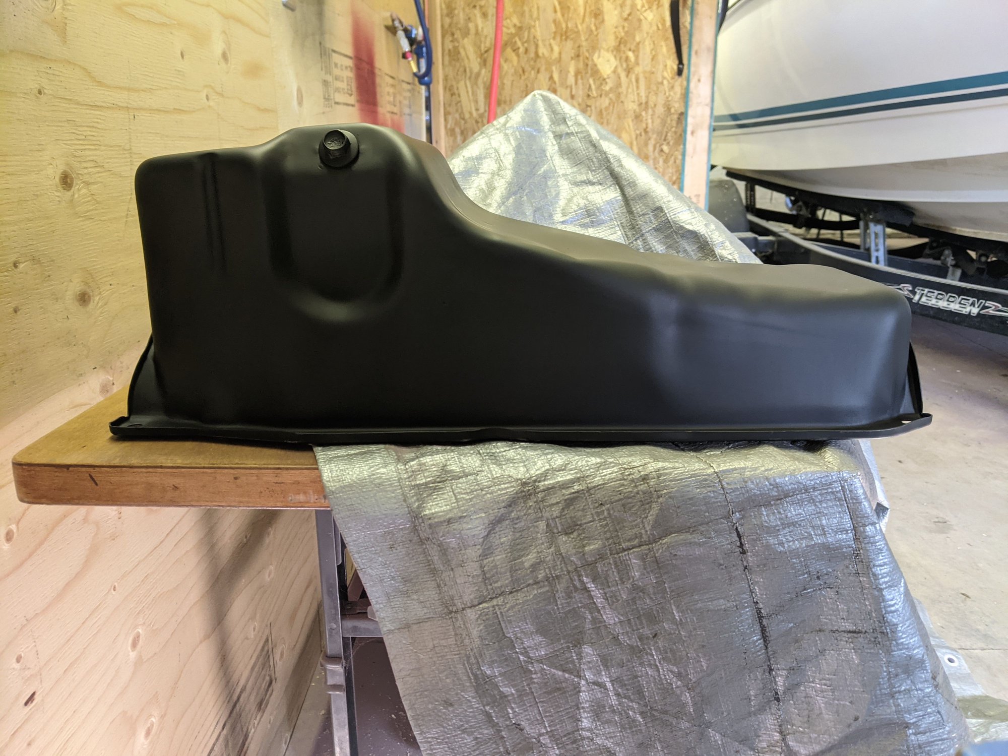

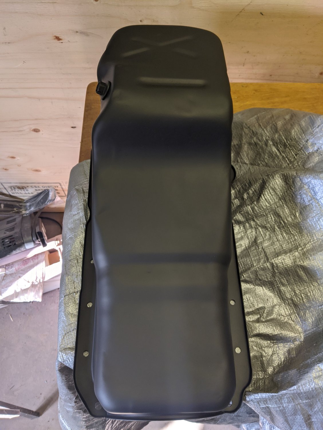

I was bored so I sanded and primed the truck pan. Still needs a top coat. Hope to find out if it will fit without mods. Lol.

Whatever pan you choose to use I’d say the 87 one piece rear main would be the best. Test fit and rotate the engine over. You might have to clearance the pan by the rails for a 383.

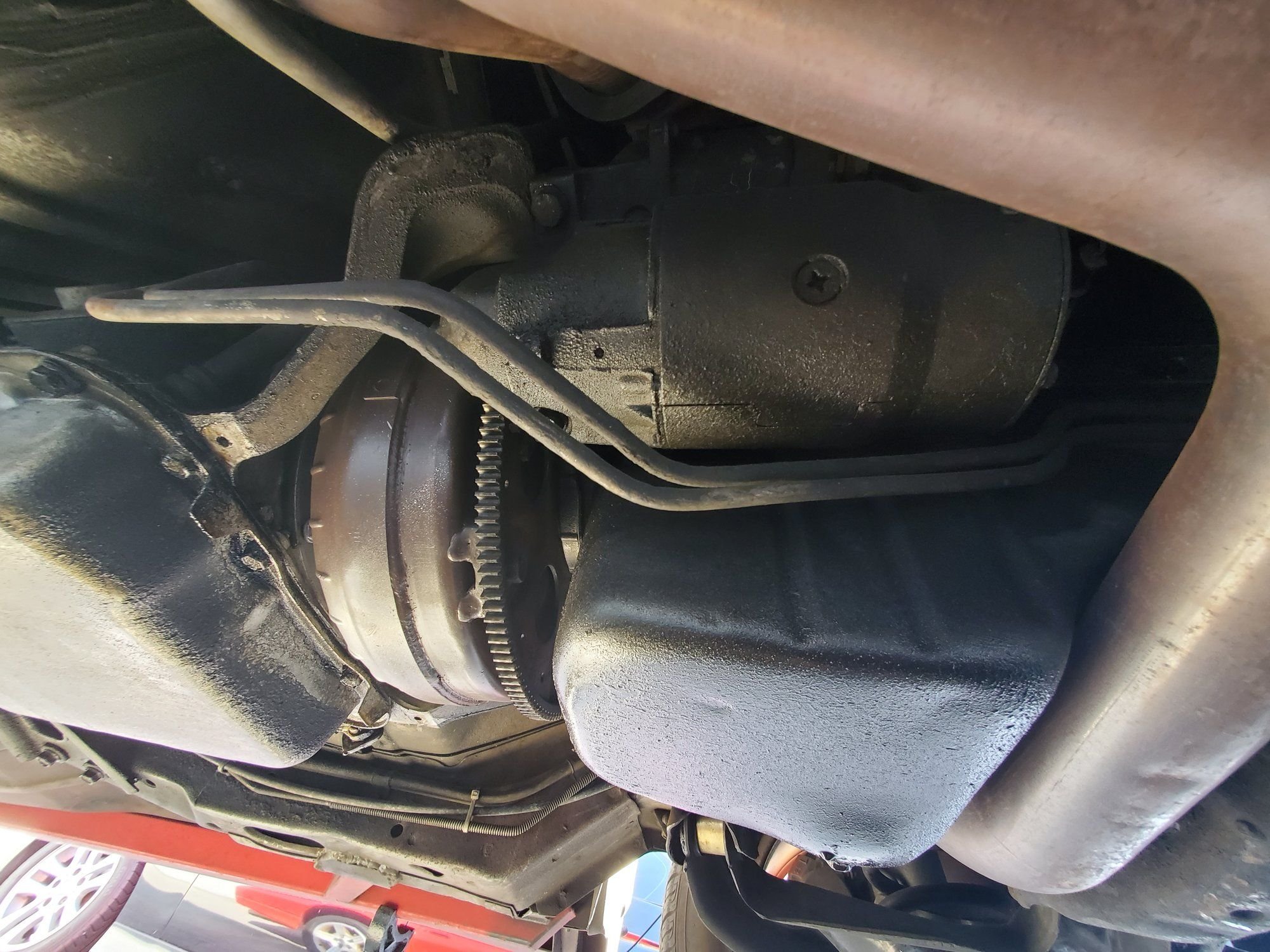

IIRC (If I Remember Correctly), I think that pan will clear the K member. However the other area to watch out for is the "notch" or tunnel for the y-pipe to pass through between the pan and K member. You don't want your oil being cooked because the oil pan is sitting on the exhaust pipe.

I have 2 vague pictures of the 305 oil pan. To me it looks almost the same as the 350 vortec truck pan. But I could be way off and like you said, the notch could be not correct. The bottom sump on the truck pan does look a bit larger.

What does that truck pan look like on the inside anyways?
