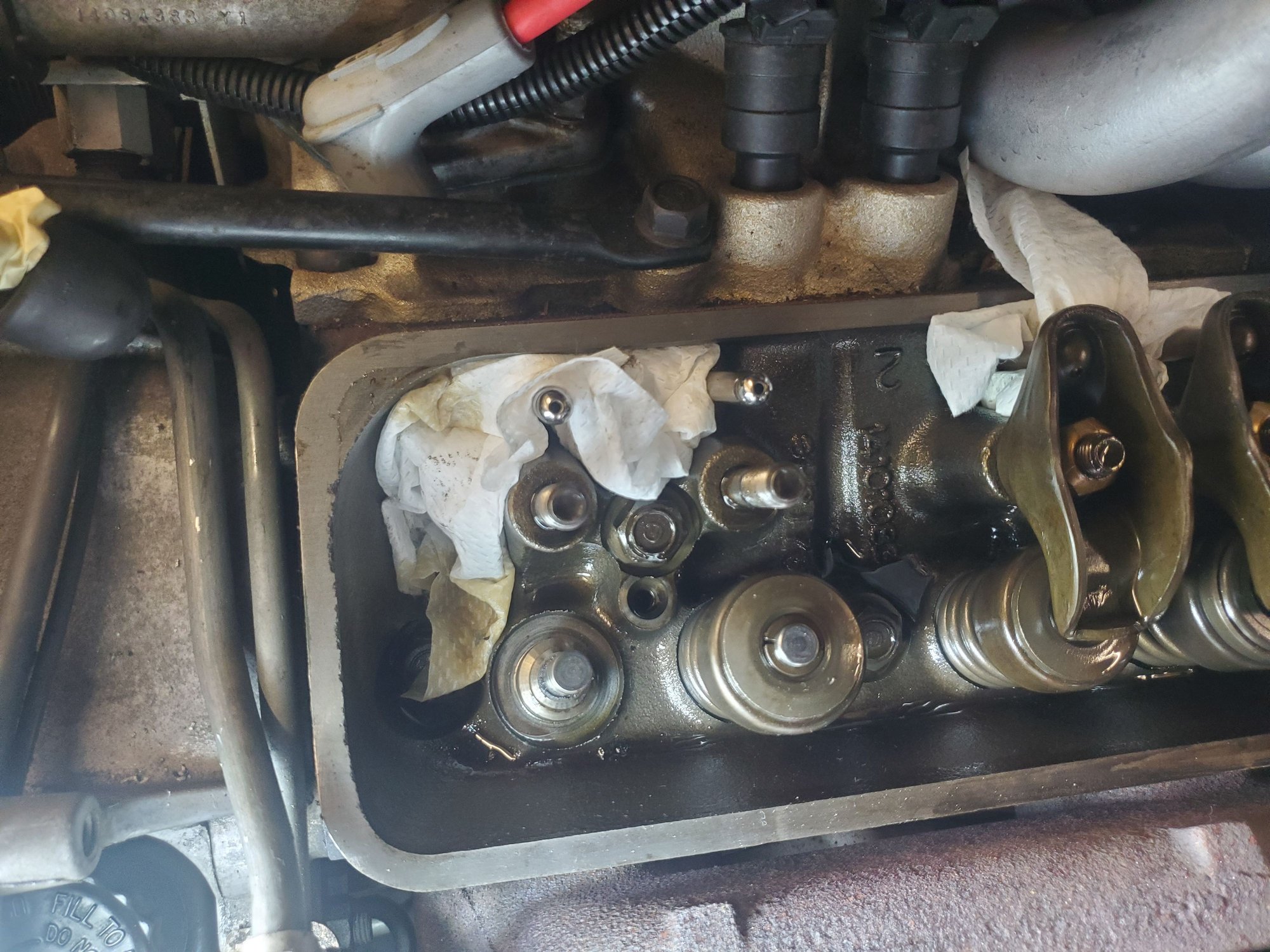

Well. cleared one hurdle... got the driver and passenger side valve covers off.
Next hurdle is removing the spark plugs.

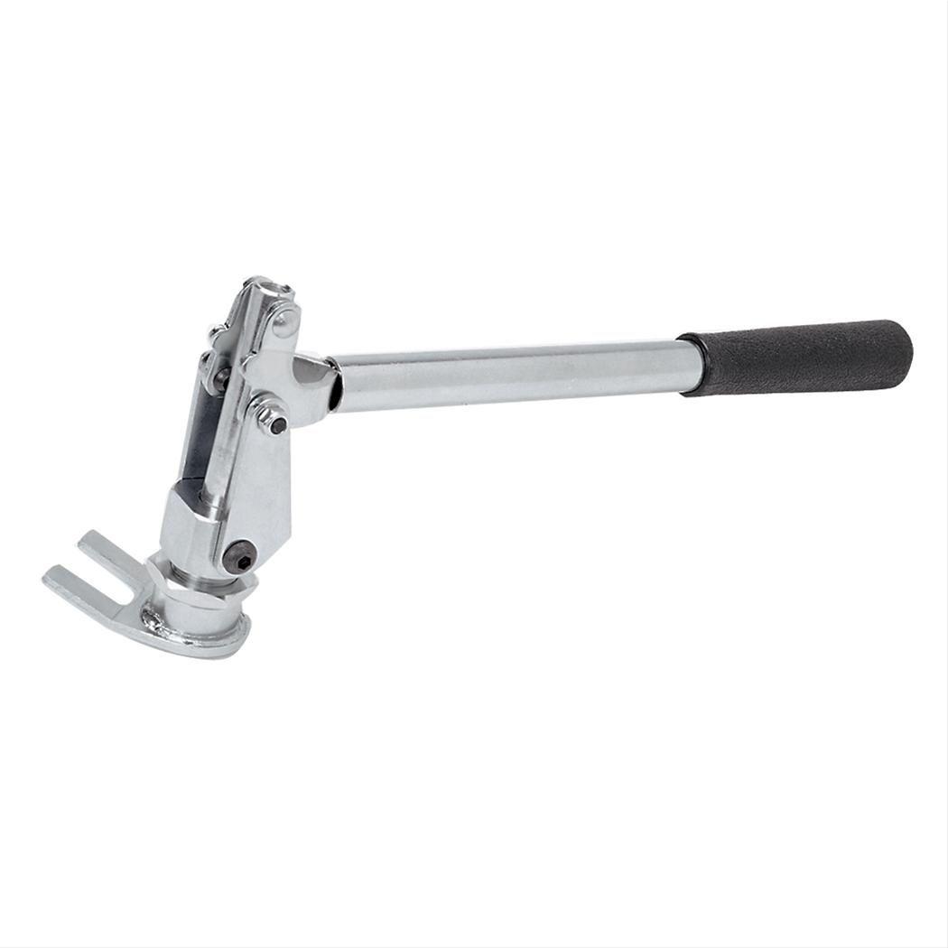

This is why I like ARP damper/balancer bolts with the square center, makes it easier to turn the engine over for springs/seals/lash. I have one of those tools the Summit version, used it for years after borrowing a friends Moroso tool(same thing) but these days I got a LSM tool. I never use rope, just get the piston TDC by feeling with a screwdriver and turning slow.

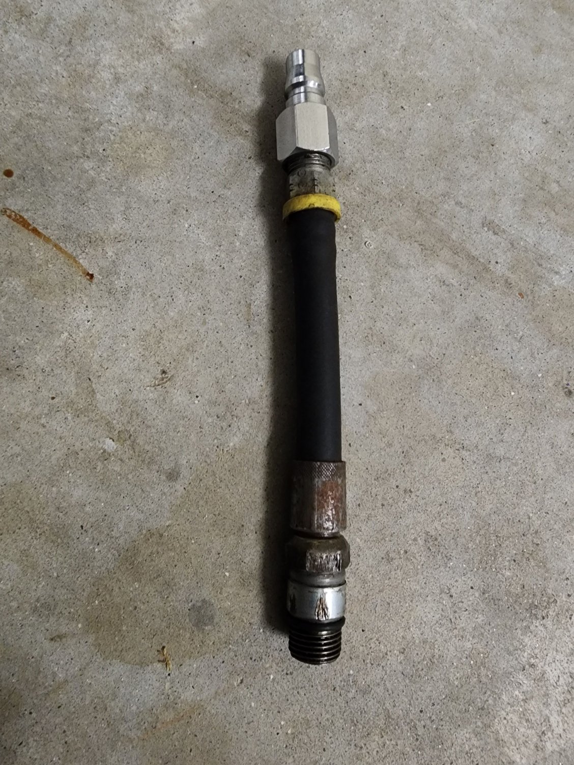

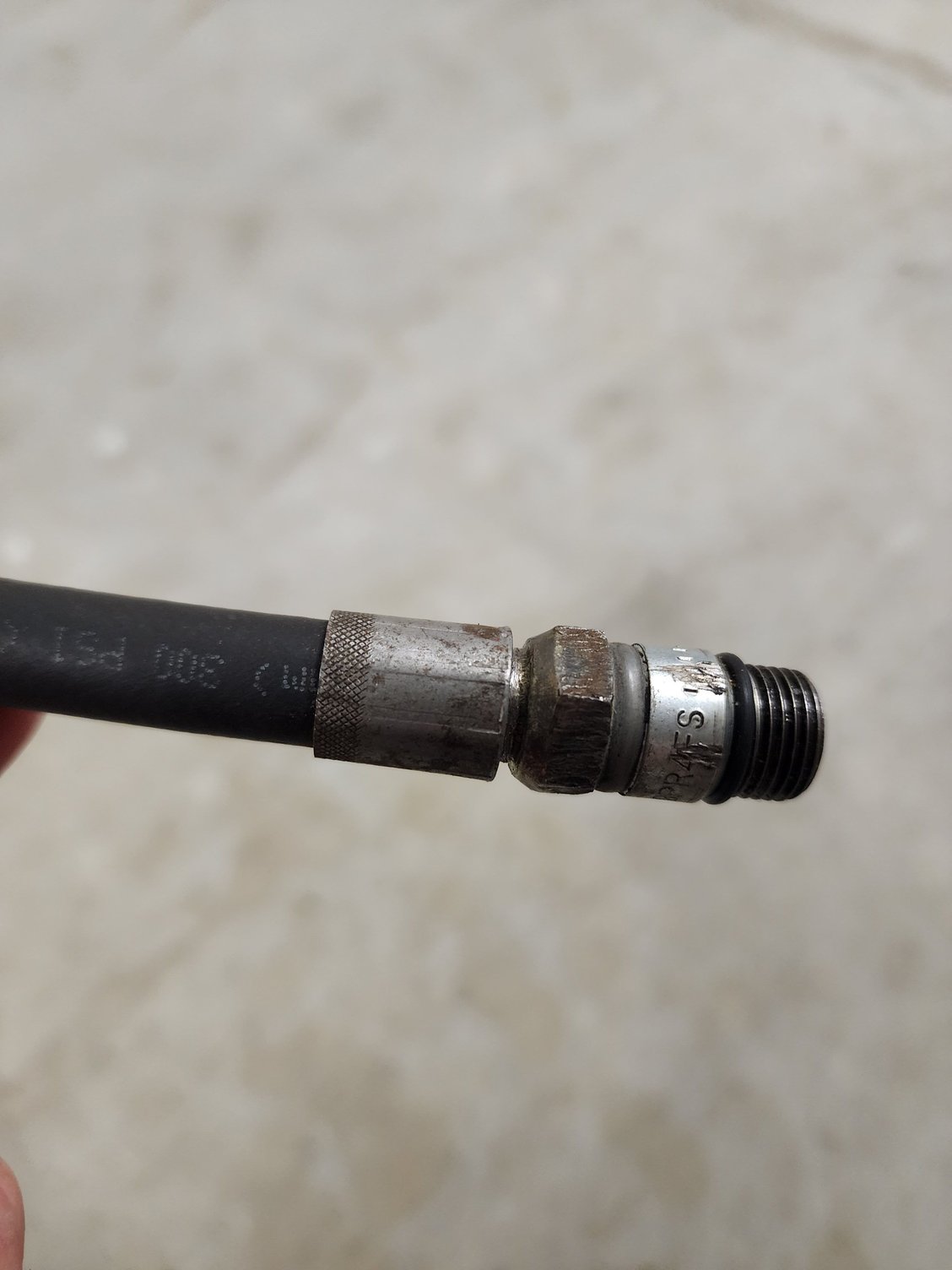

I took a spark plug and asked a guy I knew in a shop to make this hose for me, screw it into the spark plug hole and connect compressor hose. Worked like a charm.

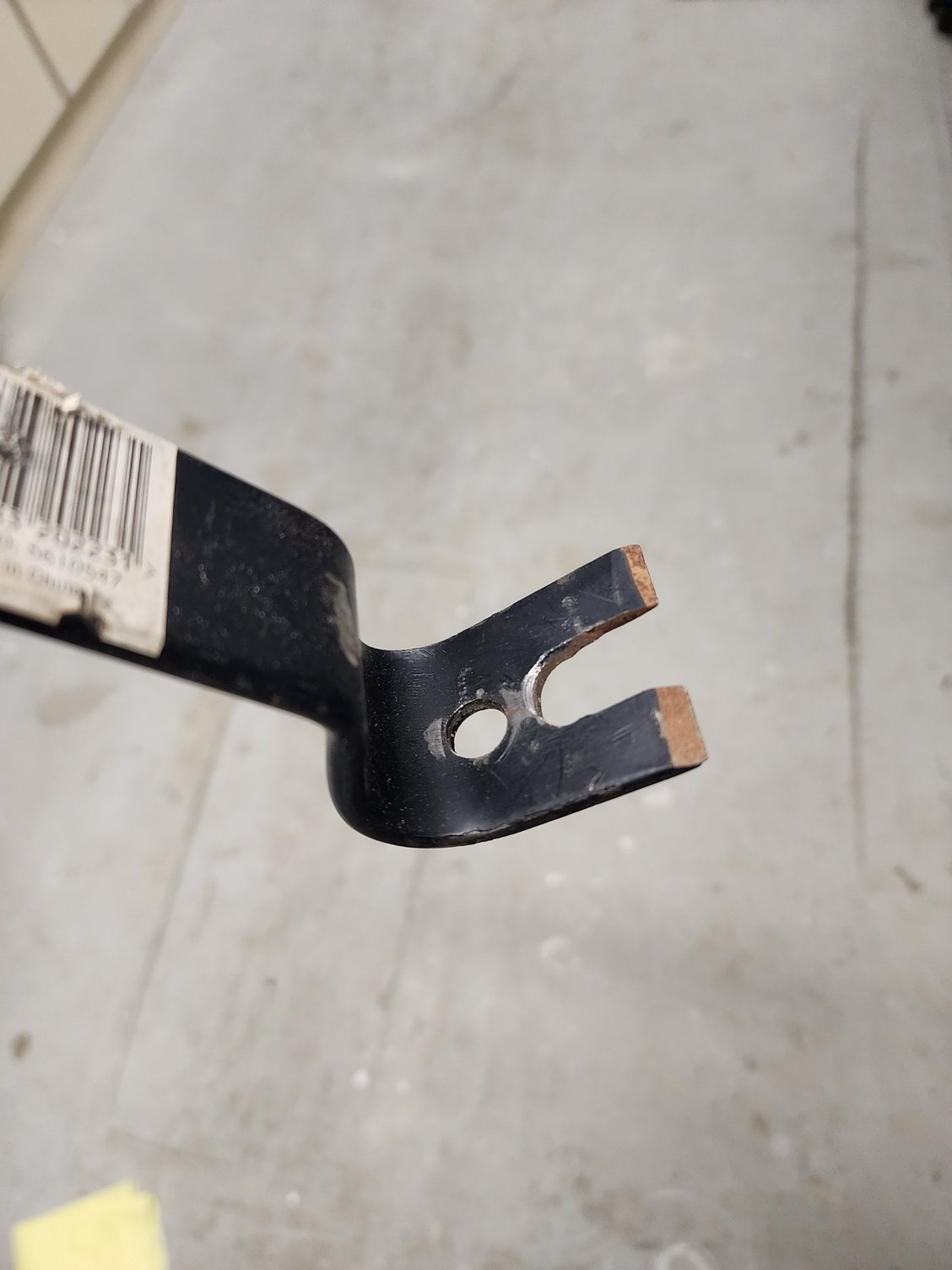

I tried the garbage spring compressors they sell in auto shops, broke on the first spring. So I made this from a wrecking bar, can't take credit, don't know where I got the idea, might've been someone on here, better than any "spring compressor".

It's just a bolt you can slide a 1/2" ratchet into or use a large socket that won't slip/round-off easy. If your doing it all the time it's handy. https://www.summitracing.com/parts/a...kaAlB3EALw_wcB
LSM is the brand of on head valve spring compressor I like, not worth it unless you change them a lot https://www.summitracing.com/parts/l...UaAm2mEALw_wcB
