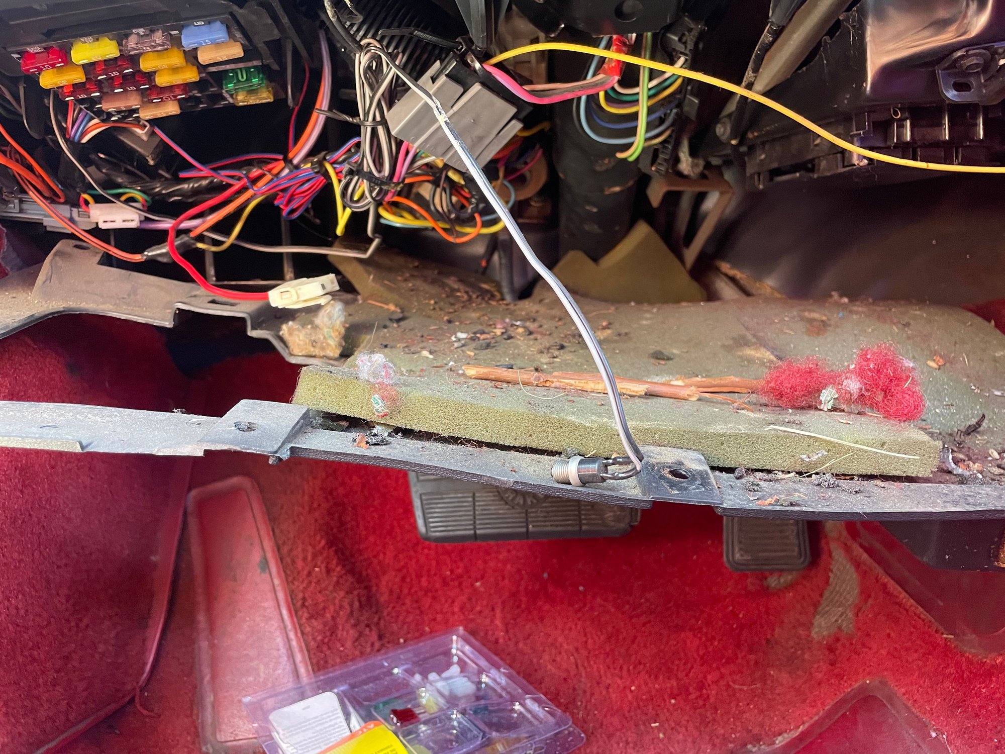

Update: sometype of rodent got in here because it was sitting for so long
