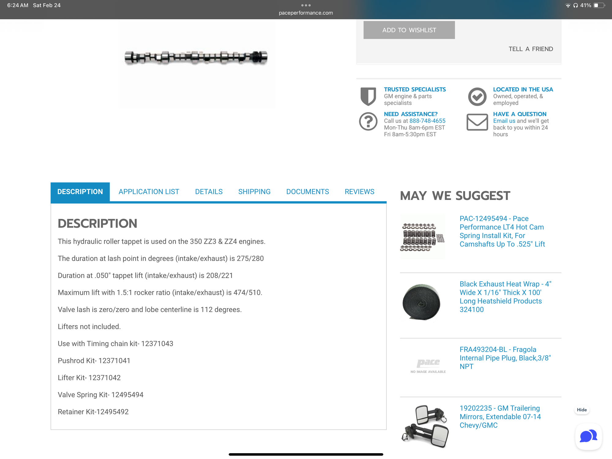

What are the differences? What would be better for a daily driver/roadtrip car?
Im doing a budget refresh on a 91 stock 5.7 car.

That TPIS cam from Hawks is the wrong one for your 1991 engine.

what is different the timing setup for the earlier cars?

I have a ZZ4 cam and think I'd rather go with that tpis super profile l98 cam.
We put it in a friends 91 350 tpi and its really nice.
the ad may show a LS cam but it's description is mostly right. Give tpis a call or shoot an email to get the correct cam. (Jim is super busy so give him a bit)
"This is a billet cam with a flat nose for the 55-86 SBC, and a cast iron distributor gear and is ground on a 112deg. lobe separation."
https://www.hawksmotorsports.com/sbc...ller-camshaft/
The version of the Super L98 cam shown in your pic is for a 1955 to 1986 SBC. It is a flat nose retrofit roller cam meant to be used in older pre 86 blocks that don't have provisions for a factory roller cam.
The version of the Super L98 cam you need for you 1991 L98 is the step nose cam for factory roller cam block made from 1987+.
https://www.hawksmotorsports.com/sbc...ic-roller-cam/
"This is a billet cam with a step nose for a retainer on an 87-94 SBC or LT1, and a cast iron distributor gear and is ground on a 112deg. lobe separation."

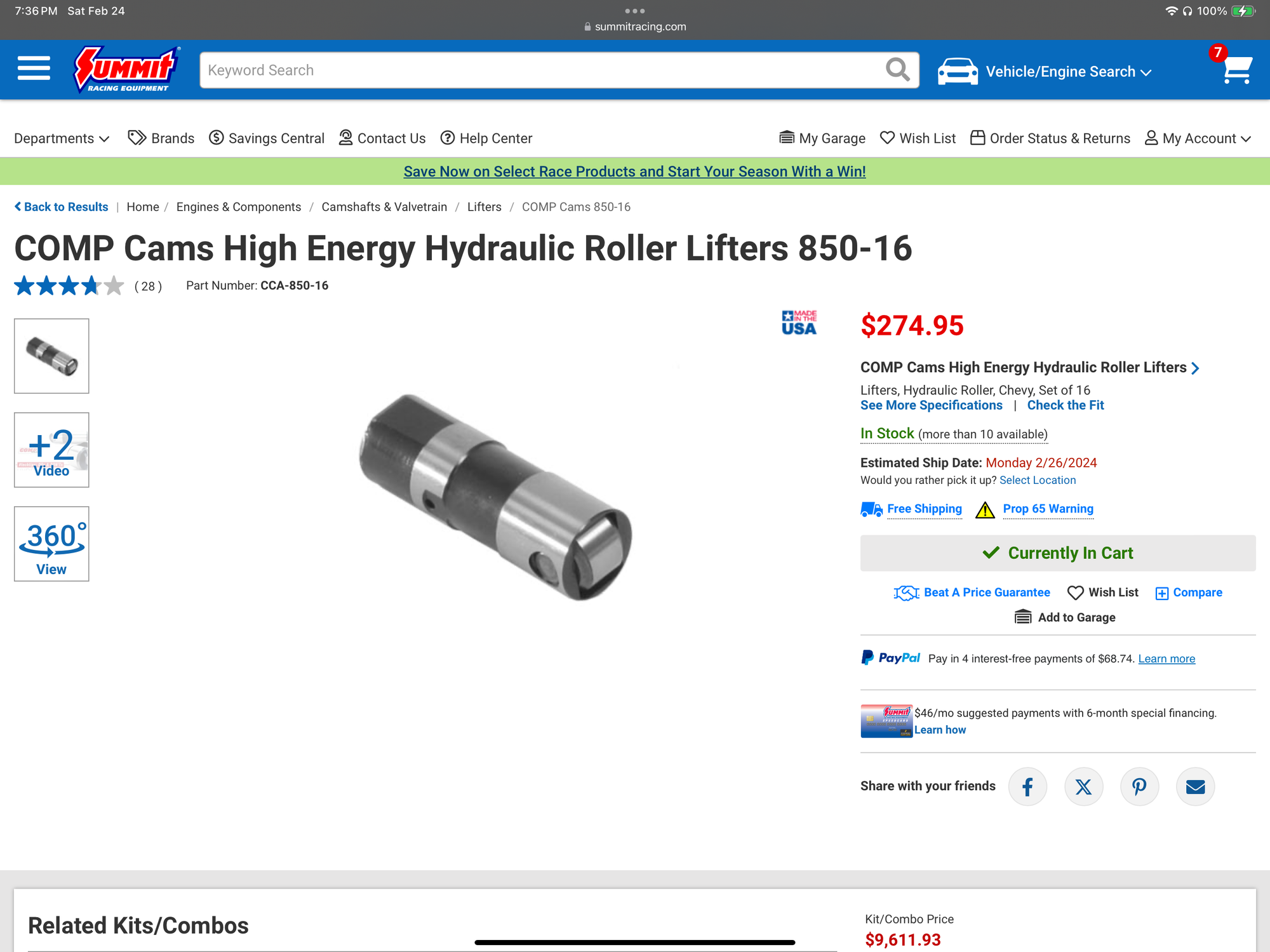

Anyone have thoughts on lifters the reviews for comp cams lifters is not great..are any reusable? Is it advisable if they have 150k miles?

As long as the lifters roll smooth, I'd use them. The new stuf is a crap shoot anymore
