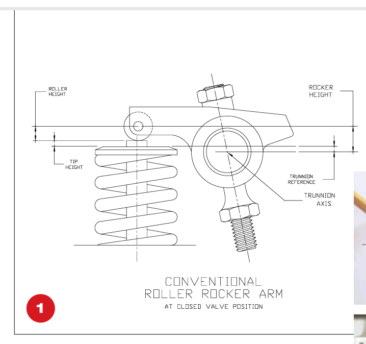

It will work good. Nice combo. Pushrods id measure once you set things up. I like the 90 deg mid lift method if the rockers geometry work with it, else kinda have to compromise to find min sweep.
id run an mls headgasket
x2 on the mid-lift method.

That valve train article is a bit of a tough read, going to go sit down and finish reading it now...

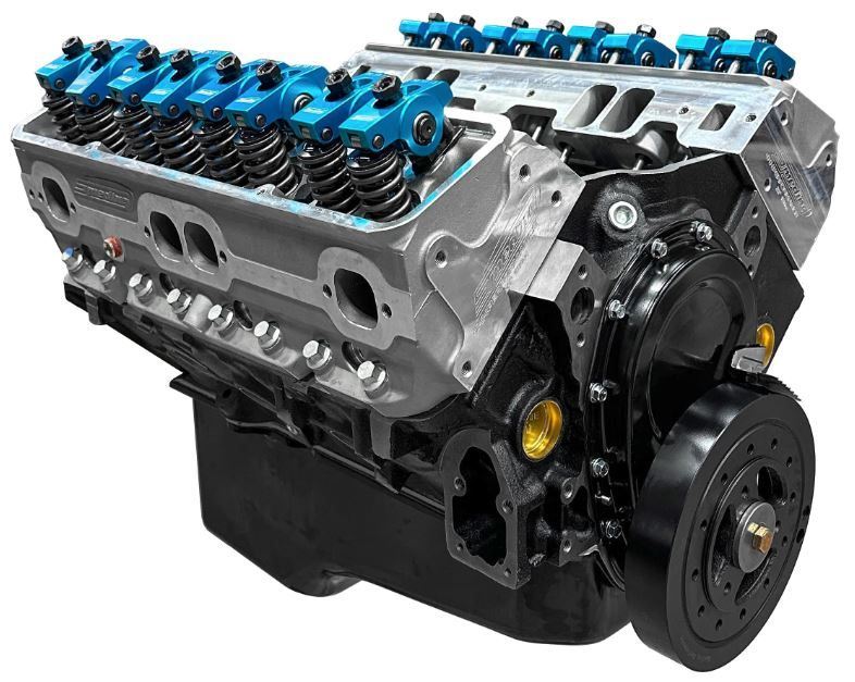

Regarding oil pans. I suspect the oil pan that is included in the seal up kit from Smeding is probably pretty plain Jane... This whole build started out low buck, but I have found certain details that were worth spending a few extra dollars on, so I keep upgrading incrementally. For autocross where I'm only doing one lap at a time, is a specialized oil pan really all that critical? Is there any way to modify a standard oil pan if you have a welder and some knowledge, or is that not worth the risk?
Here is a picture of the oil pan they include on the long block from Smeding, I suspect it is the same as the one I will be getting, but I can call to confirm. I was planning to call anyway, they are showing a 10% off black Friday sale, so I want to see if that can be applied to my order...
Listing for the long block: 383" Long Block – Smeding Performance
Listing for the short block I have on order: 383" Short Block – Smeding Performance
The key take away from that paper, unless the history of roller rockers is something of interest to you, is this diagram.
This is all measured with the running spring installed (no checking spring required) and the rocker arm sitting in the rocker stud. It doesn't require tightening. Simply sitting loose.
Reference is off the top of the retainer however this is assuming that the retainer top is flat and not contoured as mine are. That's a different matter although I've developed a work around if you need direction there.
Then measurements are made to the appropriate roller axis'.
You will require an adjustable pushrod for these measurements however.
https://www.summitracing.com/parts/cca-7702-1

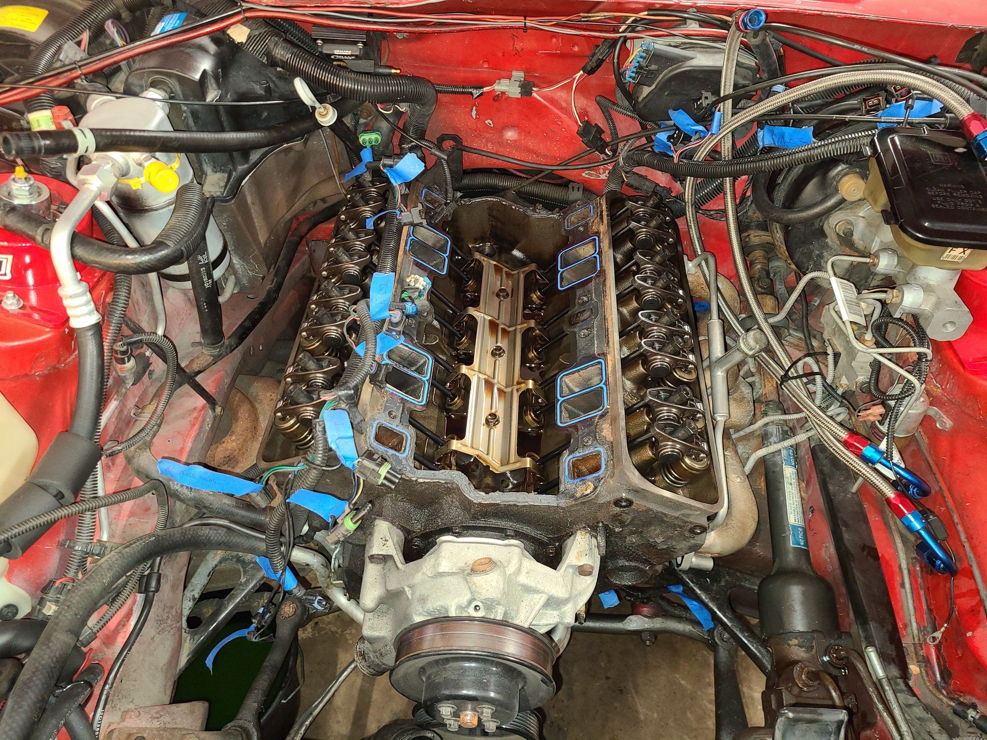

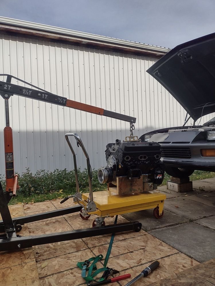

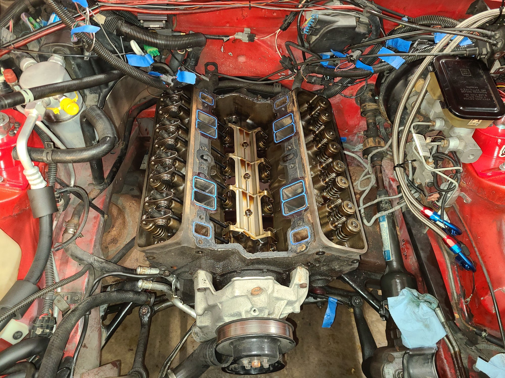

The build/swap has begun!

Making some real progress!
But how the heck do you fit the driver's side header out???
Old Dec 7, 2024 | 07:53 AM
aliceempire's Avatar
iTrader: (14)
Joined: Nov 2008
Posts: 2,093
Likes: 175
From: Milwaukee
Transmission: T-5, TH350, T-5
Re: Fuel Injected 383 SBC Build for Street and Autocross
simple. Leave it there. When you put everything back together, set the engine in place with the hoist still hooked up. Pick up the engine just enough and slide the header back in.
Old Dec 7, 2024 | 02:39 PM
raptere's Avatar
Posts: 790
Likes: 83
From: Northwest Chicago Suburbs
Car: 1991 Camaro Z-28 (Durango R/T)
Engine: 383 L98 W/ HSR
Transmission: 700R4 Tuned Shift 2600 Stall
Axle/Gears: 3.73 10Bolt Posi W/ Al Cover, Disks
Ha, I certainly had that thought, and may need to. I was planning to remove my air tubes before pulling the engine, but I dont have room to have the engine on the stand and my wifes car in the garage at the same time...

Ended up being able to get that d/s header out by disconnecting the upper end of the steering shaft. Came out quite easily then...
I think I have everything disconnected, trans is on my motorcycle jack ready to be lowered, next step unbolt the engine from the trans and lift it out. I'm hoping I can do it without having to disconnect the dtiveshaft and torque arm, that bracket is a pain in the butt...

You may have better luck than me however I found that the transmission had to be lowered substantially so as to gain access to the bellhousing bolts. I've got a 3 foot extension and a swivel socket for just this purpose.Then again, I've so much practice with these re and re's that my torque arm technique has evolved to the point where it's removal is now pretty straightforward. It's simple too in a way having an aftermarket arm. The arm can be disconnected from the rear axle bracket so access is somewhat more convenient.
That said, and having done this twice last fall, I'll say it's far easier to haul the engine and transmission out as an assembly.

Yea, I just dropped the trans last year to install my new torque converter. The long extensions and swivels are a must. I plan to go through about the same process.
Air tube free, is the way to be. Looks cleaner alredy, just have to prep a bit more, weld up the homes then paint it. I'm thinking about doing some minor port matching too, the inside welds protrude pretty far into the tube... the felpro 1404 I have fit the AFR exhaust ports almost perfectly.

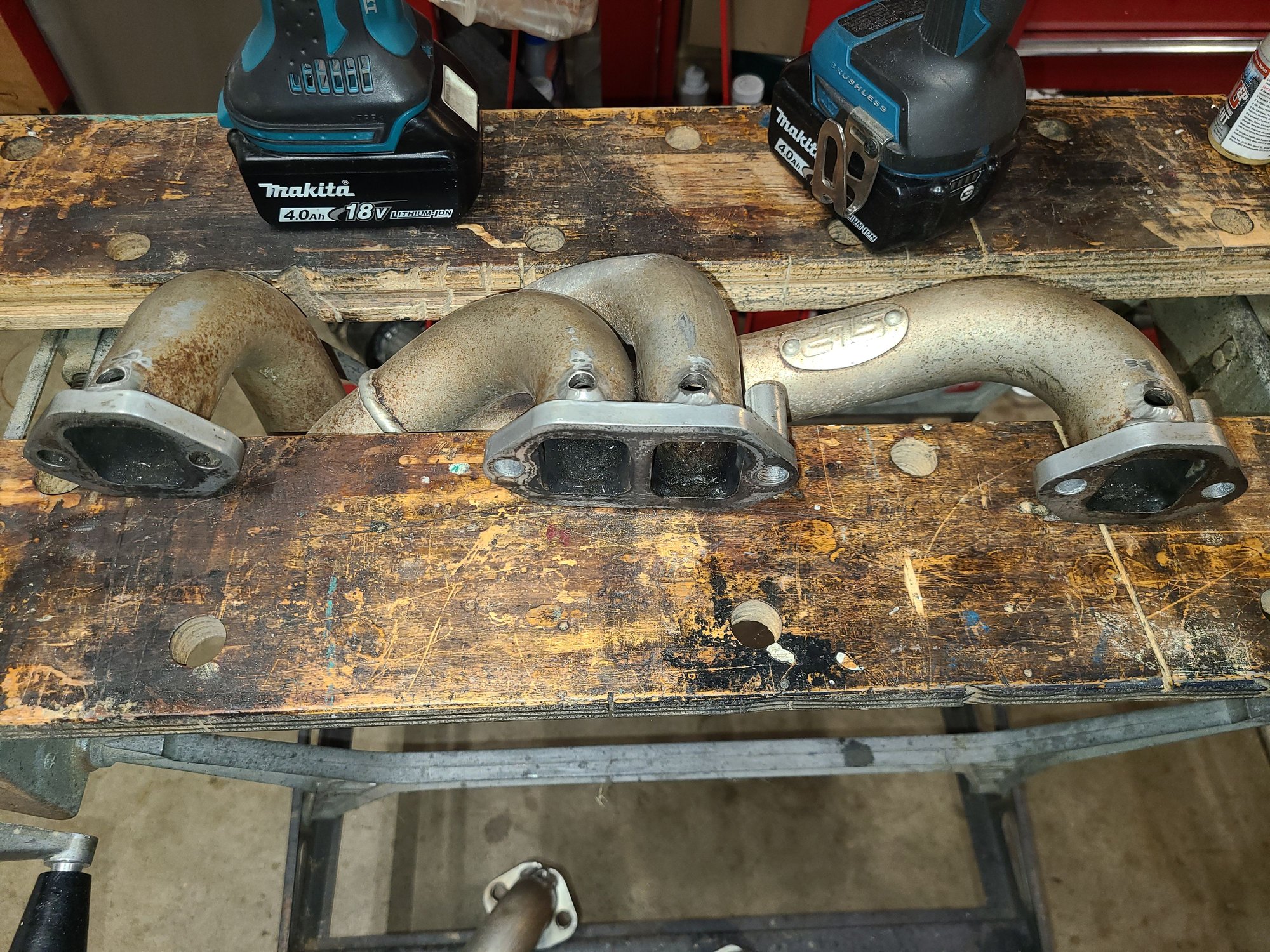

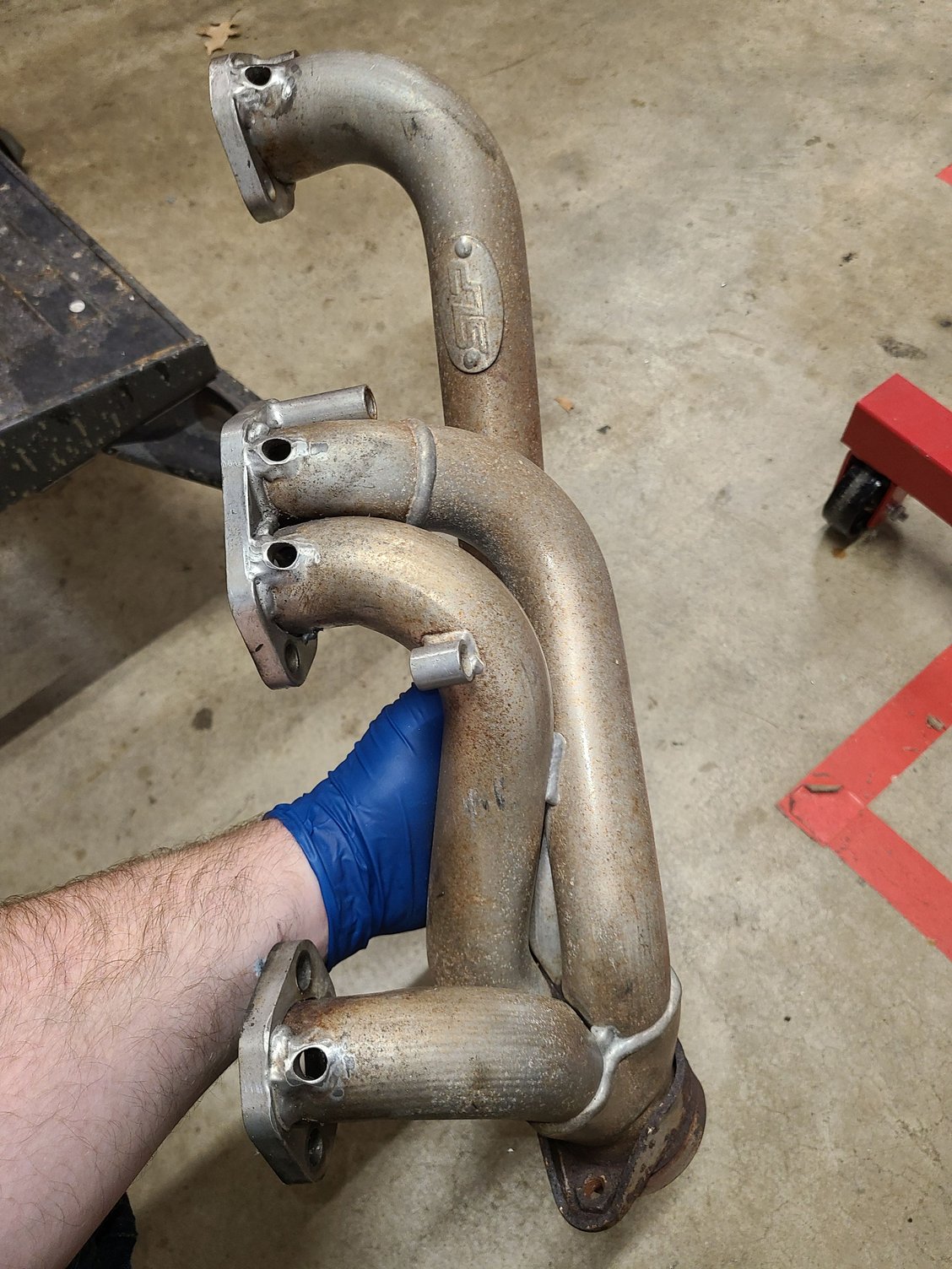

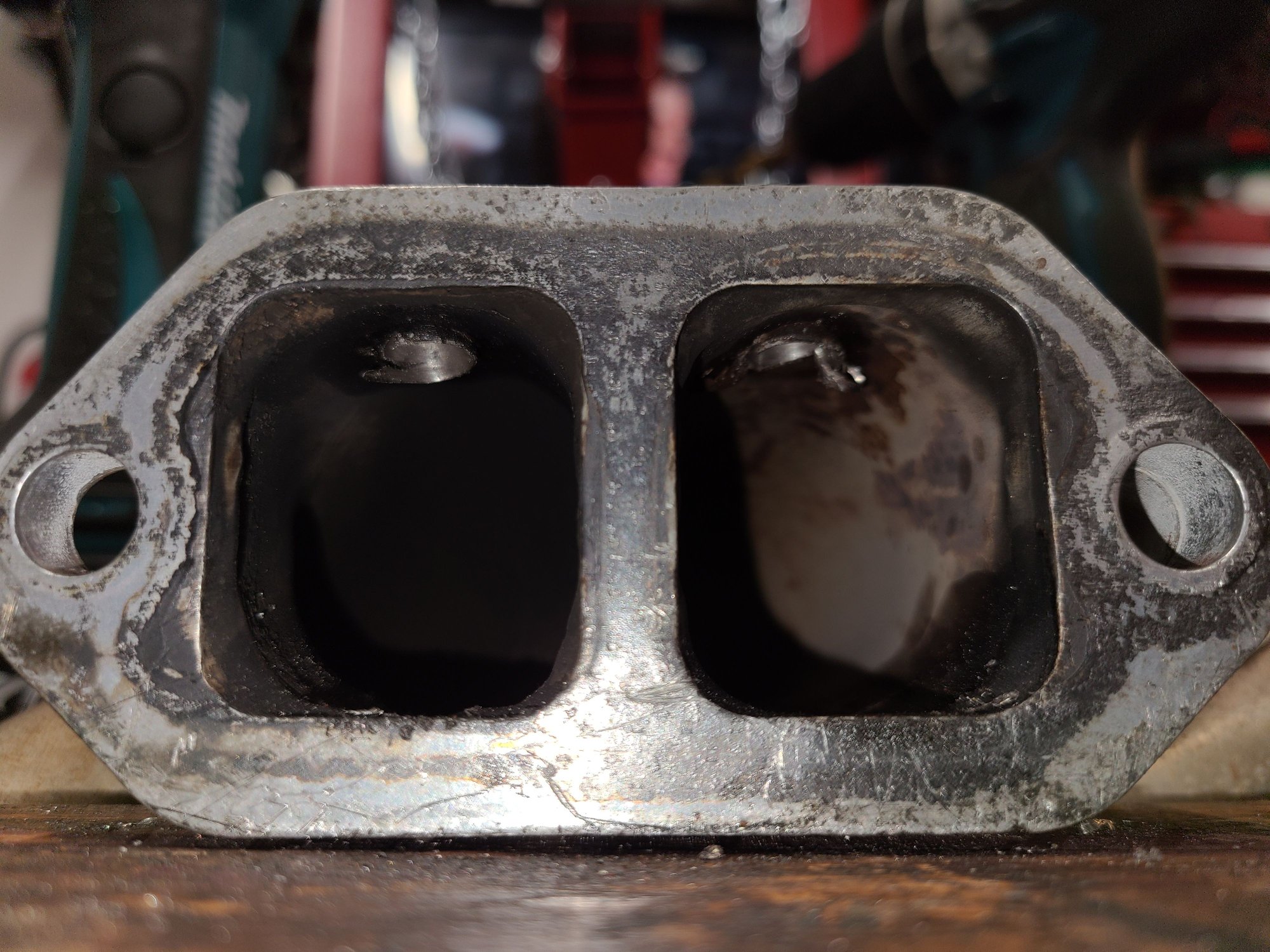

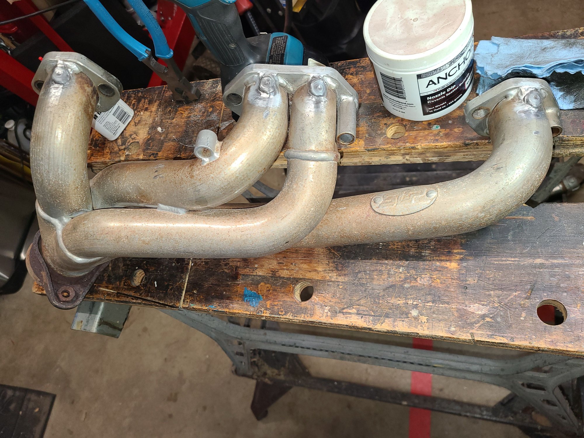

Smeding said it was itially on schedule for the 4 to 6 week delivery, but last Fri was 4 weeks, and they said they are still waiting on my special pistons, so hopefully those come in soon...
Headers are welded up, and I ground down some of the highest points on the interior welds between the tube and flange. The speed shop I had install the headers years ago had to "clearance" the drivers side header to clear the steering shaft... I think they did a lousey job of it. Think there is a way to make this look any better while I have them out, or do I just leave it, don'twant to make them any worse. I also only have a Mapp gas torch, no oxygen acetylene...

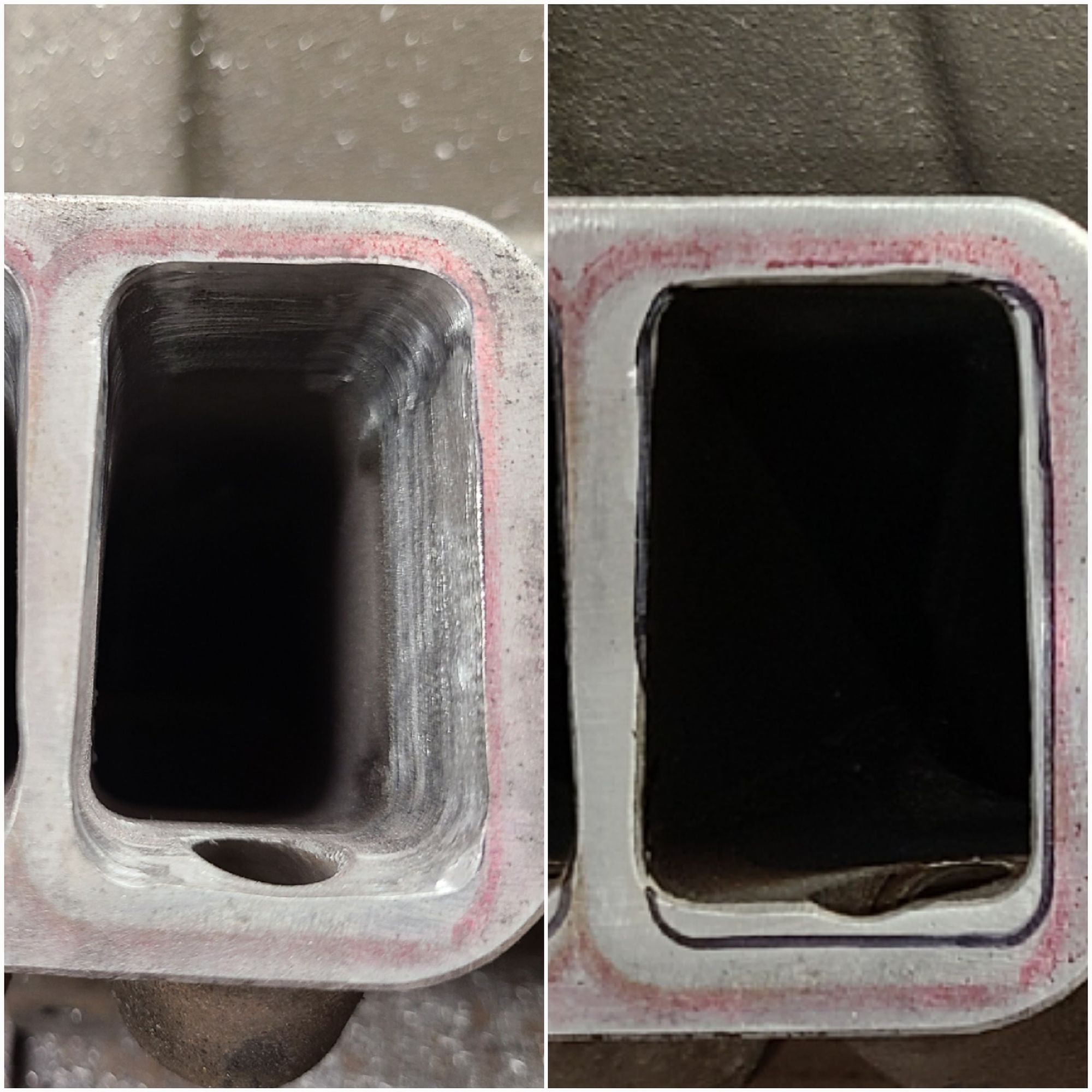

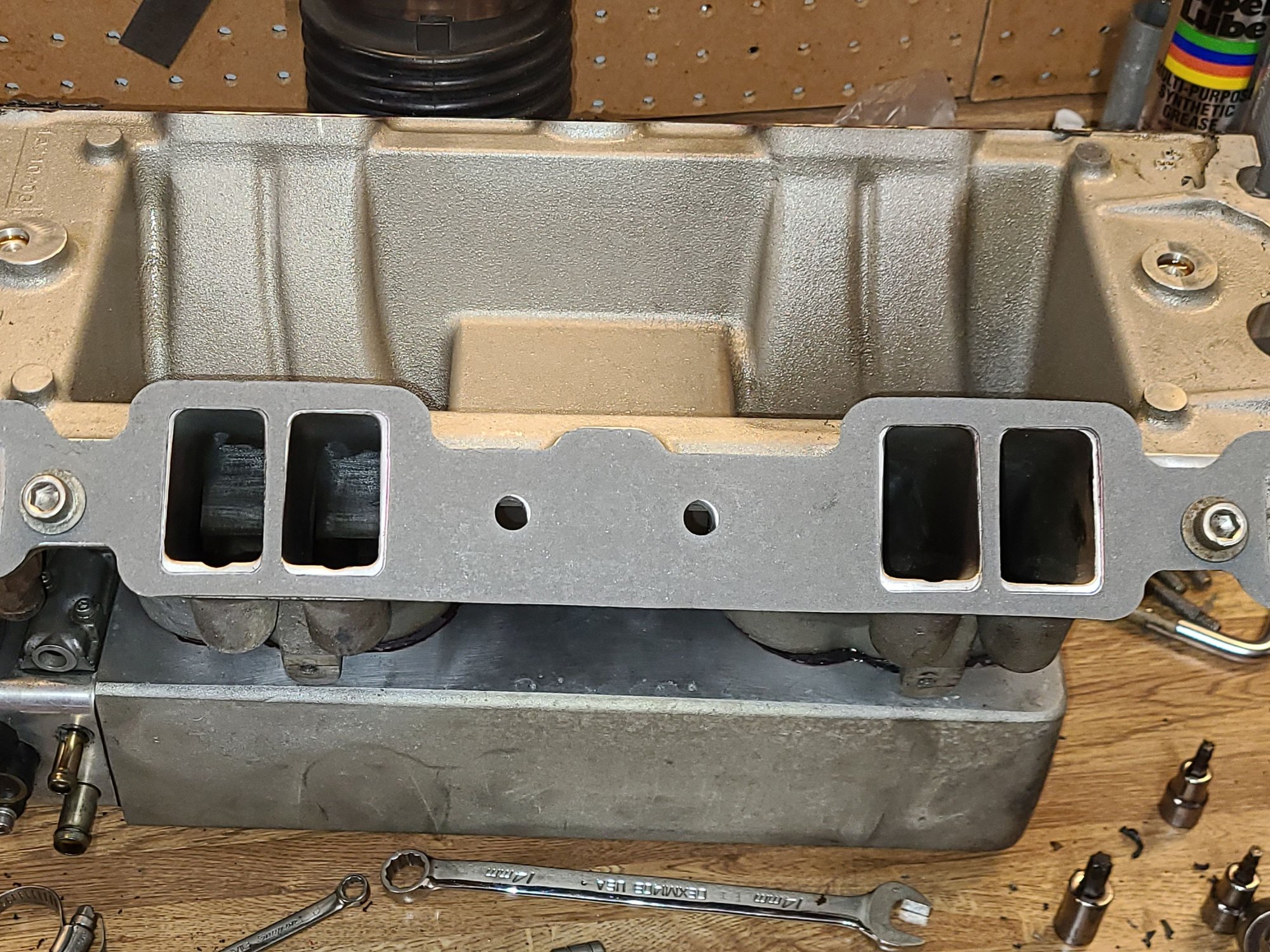

I've also gotten started port matching my intake base. Not beautiful, but it could be worse too... Should be functional.
That's surprising to me. The reputation of the old SLP headers is that they did not have these kind of fitment issues. I may be in for some surprises when I go to install mine.
every set of 1 3/4 SLPs have needed some clearance. I got the tube warm with a propane torch and massaged it with a deadblow. Not all that bad to do if you have a little bit of patience. My surprise was the p/s header had a flange that was warped from the original welding. I filed the highest spots but if it doesn't seal this time then I'll have to have the whole thing machined flat.

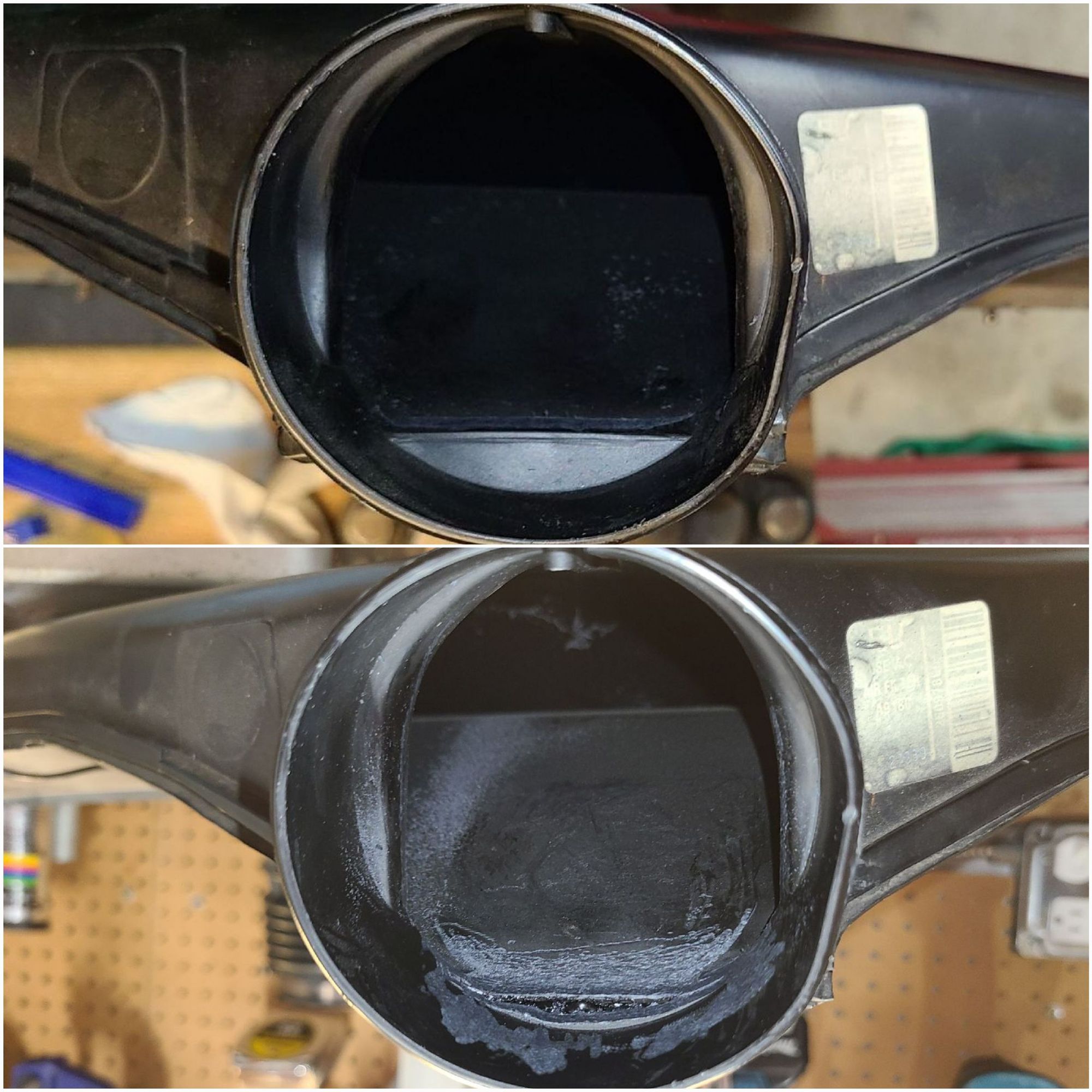

I'm planning on using the same air filter assembly, though I'm not sure how much HP it can handle. I did see on here somewhere you can trim this weird ledge in the air track of the filter y pipe, to improve flow. By cutting it away you end up with an air leak inderneith, so I did a little "plastic welding" to seal it off and reinforce it, with a soldiring iron and zip ties.

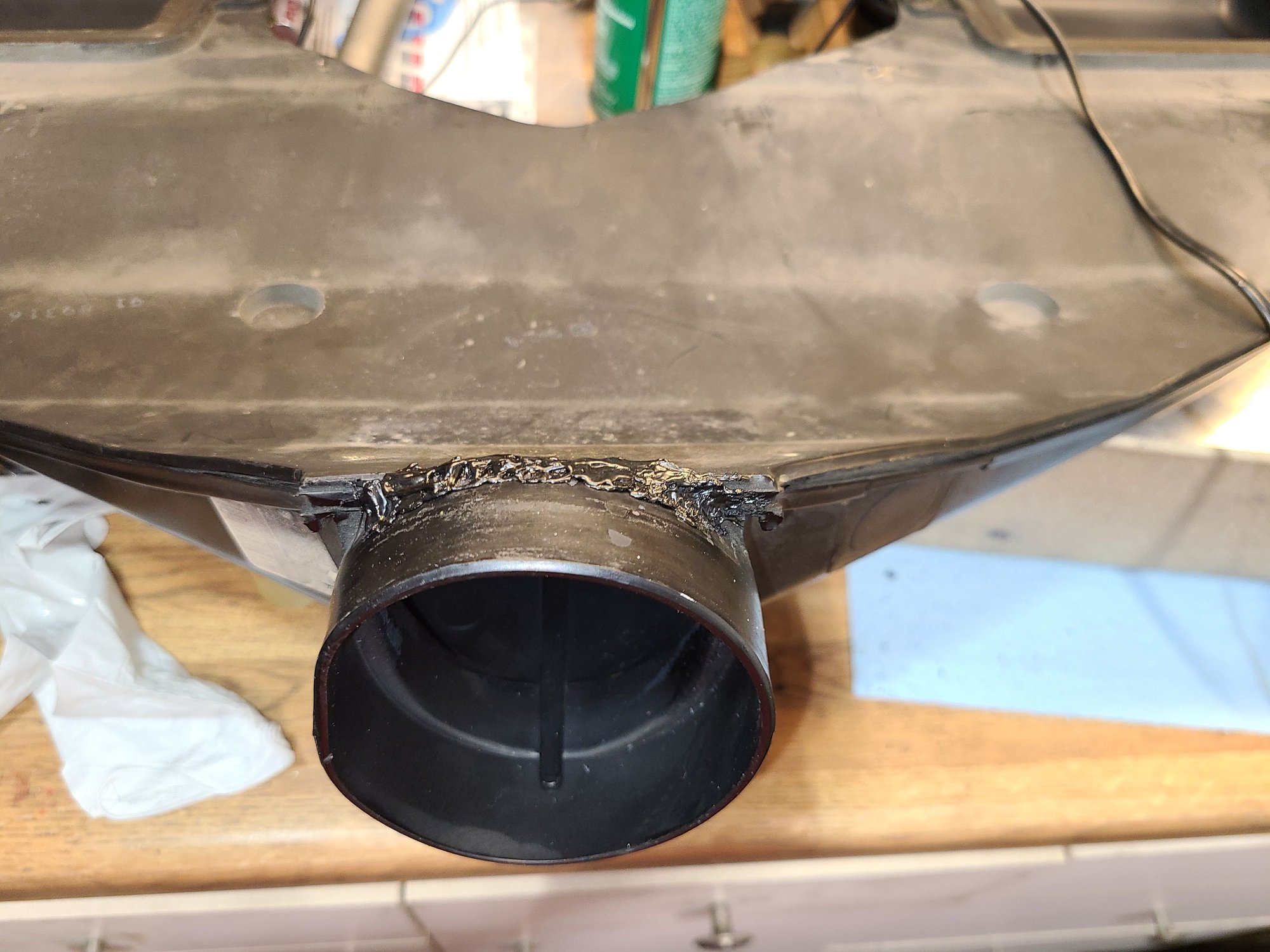

There a couple of threads about modifying the TPI intake assembly.
Most notably from Chad Speier (https://speierracingheads.com/index.html)
His rework is at:
https://www.thirdgen.org/forums/fabr...ir-intake.html
Another thread from many years ago was this one:
https://www.thirdgen.org/forums/tpi/...pi-camaro.html
The short story is to get the intake tubing to a 4" diameter which would be what you need for your HP expectations. Both threads demonstrate how the "box" gets dissected and material added to make it "thicker". That allows for the larger diameter hose as well as increasing the internal capacity.
The baffling that precedes the filters (below the rad support) is also cut away.
Speier said that he flow benched his creation and found no restriction with the OEM twin filter elements although K&N's were used. I was a little surprised at that but then again Chad is a cylinder head porter by trade and I suspect he knows a thing or two about CFM.
He went a step further and built his own ram air tubing to feed the filter cases. All in all an excellent project and result.
I will say that the OEM 3" intake tube and the restricted box are going to curtail your output. Potentially anyway. Much like the smallish exhaust won't let the engine really stretch it's legs.
More than anything, CFM notwithstanding, it's the supply of outside air to the induction that's vital. An effective CAI is worth it's weight in gold. This is something I'm presently wresting with. I've the old school 14" open element air filter and it's allowing air that's passed through the rad, and further heated under hood with the headers and is making for an unreasonably high inlet air temperature. I've a cowl induction hood that I've yet to seal up but I've also thought about how to get one of these modified TPI intakes to fit with a round filter case.

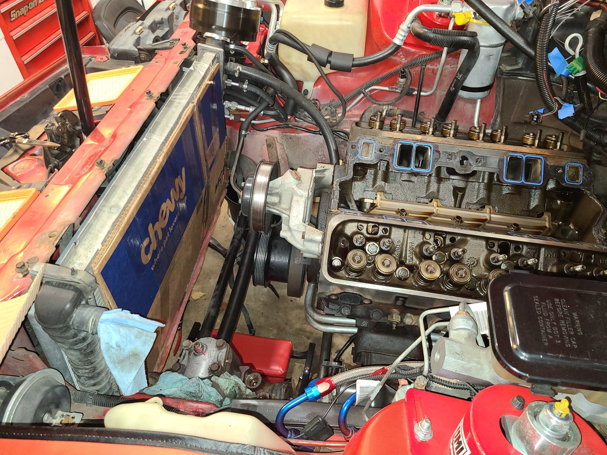

Got confirmation yesterday, they got my pistons and the crank is on the grinder. Should ship on Monday! Not sure what shipping is going to look like with Christmas though...
With everything being said I should be investing in umproving my intake filtration setup or exhaust, but looking in the engine bay and seeing the old rusty k member, made me think twice... plus it would give better access / room for my other work. Plus with the engine out it's right there... so I bought one of UMI's road race k members! Really nice looking part! And I think ~25 lb weight savings.
I pulled the electric fan assembly and put three layers of cardbord on the radiator. I may remove the water pump first, but i think that should be enough room to get the engine out...
Tonight I plan to rebuild my steering gearbox and swap all the lines and hoses. I'll have an all new front end by the time this is all done and over with.

You are NOT removing the water pump and crank pulley before you pull the engine?
I certainly can if it is advised, sounds like ypur saying it would be a very good idea to do... this is a learning experience for me. First time pulling an engine. Surprisingly I have not been able to find much in the way of a tutorial of do's and don'ts for pulling and reinstalling a whole engine.

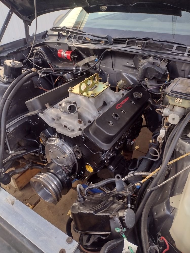

Well, there are certainly many variations of a theme here.
Personally, I've done it many ways.

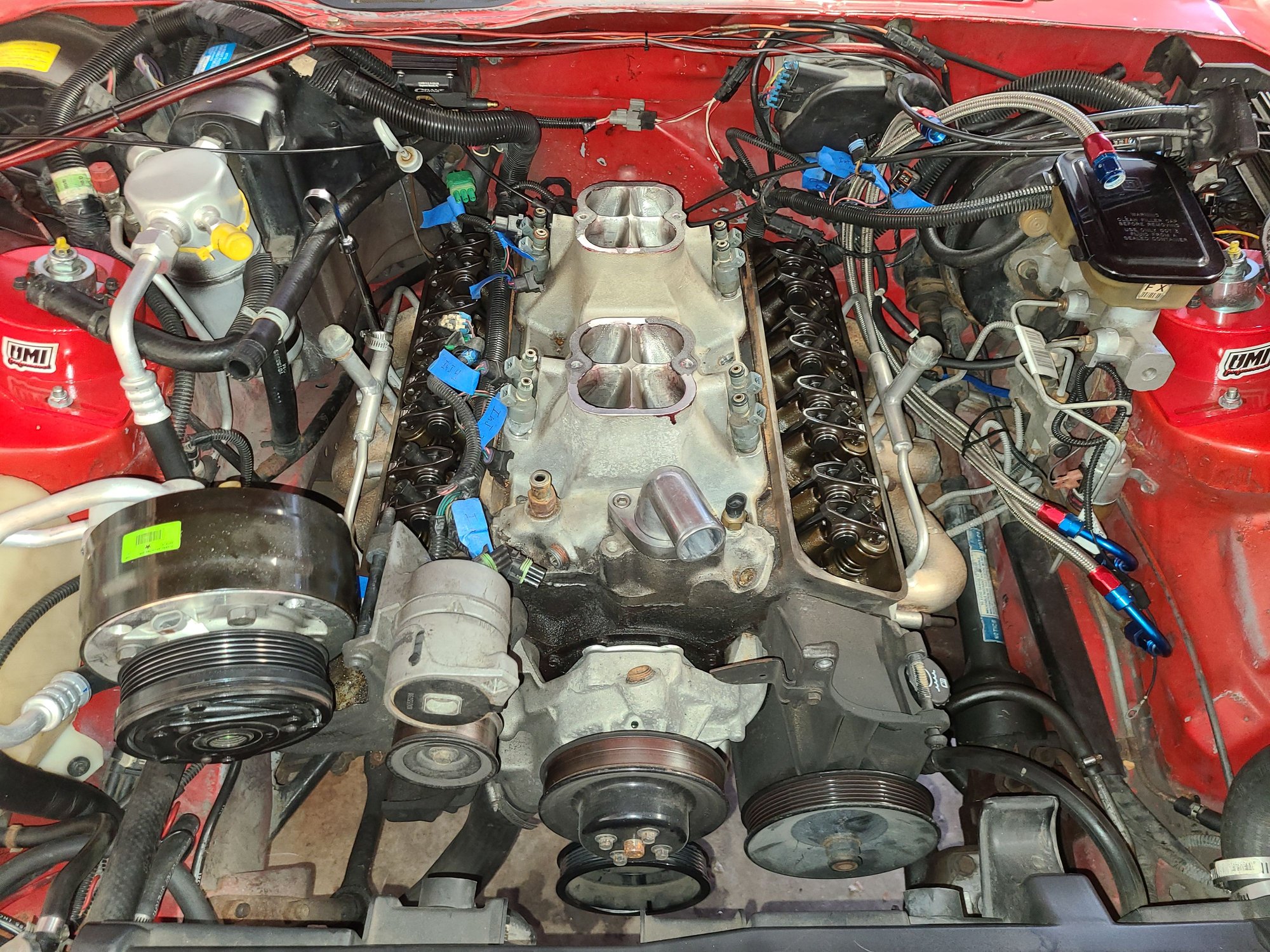

Complete engine and transmission as an assembly. Balancer, crank pulley and water pump fitted as access is so much easier while on an engine stand as opposed to leaning over the fender
Stripped down engine on its own.
And all points in between.
Last time around it looked like this. Not even a garage or driveway to work with!
As posted above.
All done with the hood on too although it was tight!
The biggest PITA was refitting the transmission and then getting the trans fill tube in place. This is one of the reasons I find the engine and transmission installed as an assembly much easier. It does however necessitate the removal of the hood and radiator to allow for an engine hoist leveler.
Your new engine is on the way. That means that you will be removing the water pump and crank pulley for reuse.
Why not do it now? You will gain extra room in front of the engine. You said that you are pulling the engine only.
What I see happening is the water pump pulley slamming right into your radiator and 3 layers of cardboard when
the engine breaks free from the transmission and torque converter.
Using this method, I hope you have planned ahead by supporting the transmission (once the engine and transmission separate, there is nothing left holding up the front of the transmission), devising a method of keeping the torque converter in place on the transmission input shaft (or that will fall off and slam onto the ground), and you had better have some kind of pan at the ready to catch the transmission fluid that will pour out all over the place, and right where you need to be laying on the ground.
Good luck.

Originally Posted by skinny z
These cars have long front ends. Notice in skinny z's pic, it looks like he has an extension added to his hoist (normally they stop at the end of the orange bar). That makes the weight of the engine past the hoist's front wheels, and I imagine that he has to have a couple of heavy friends weighing the back of the hoist down. Without that extension, that engine is definitely going to "pop" forward towards the radiator once it separates. Hopefully you still have all 10 of you fingers when you are done!
