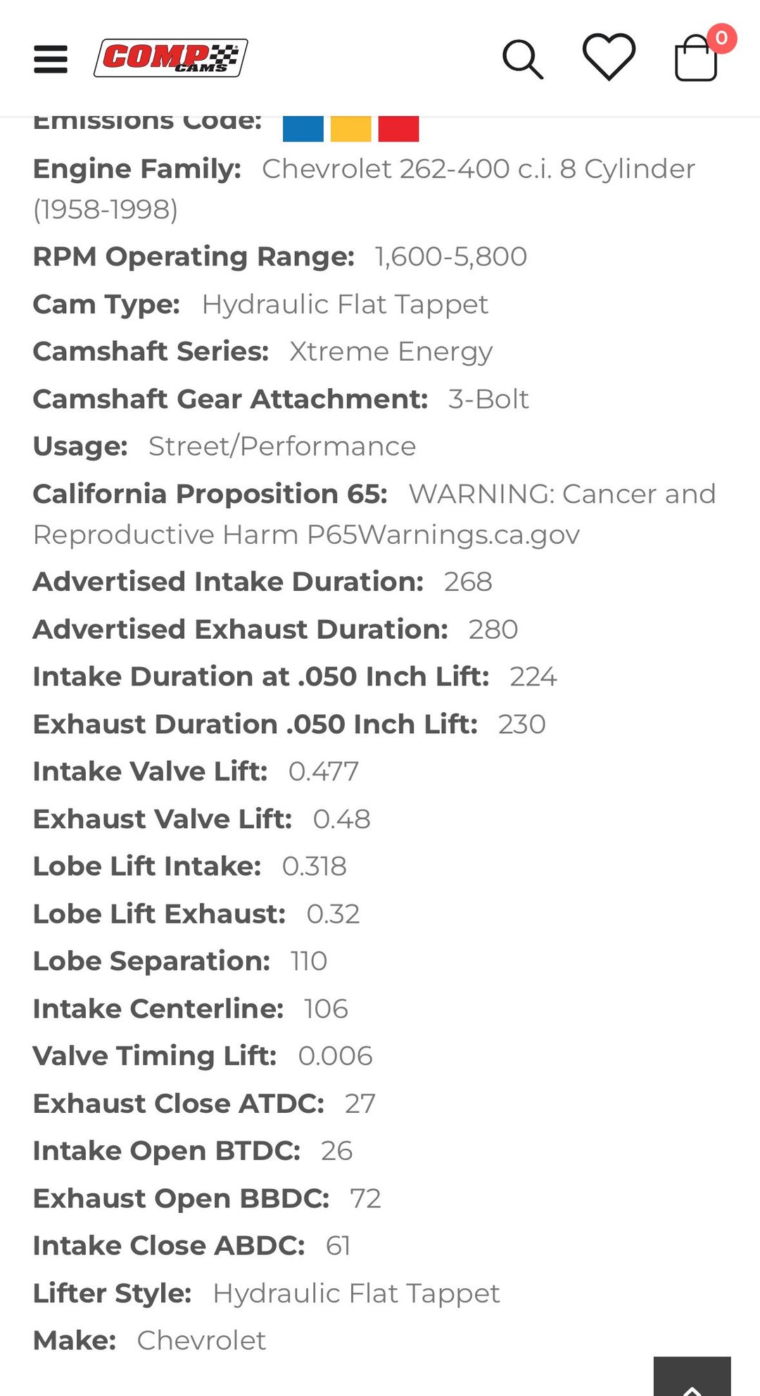

It痴 getting a flat tappet cam from COMP Cams no doubt. I値l put the cam specs below. Stock 305HO heads, 9.5:1 compression from factory, the 059 Vortec heads will maintain that compression too. Plan is to find cheap, decent condition 059 heads on Marketplace and taking them to get rebuilt, possibly put in stiffer springs to match the cam but not sure what I壇 need to get.

That's a lot of cam for a 305. Would be pretty aggressive in a 350. Plus, personally haven't had very good luck with Comp's Xtreme Energy cams.
I would go with something like a Summit 1102 (204/214 @ .50) will work with the stock valvetrain and be pretty nasty for a street engine with enough vacuum for brakes.

Not to argue with the Rockies Rocket, but that cam alone between stock 305 heads wouldn't make a night/day difference. It might not be too much cam on stock valve sizes, and might release 10-15HP with no other head/valve work - maybe. Since GnarlyBird mentioned switching to 059 Vortec heads, That resolves some of that question, and addresses it even better if those replacement heads get some attention first. Consider that the enlarged chambers are going to drop compression, and you might need to address the non-existent EGR to keep them cool enough for street driving. Before destroying your PayPal account, it might be educational to investigate the heads/intake used on the L99 engine as a potential template.
I am running a Comp 07-305-08 (220/230, 114ーLSA .510/.520") on a stock 350 and it idles almost as smooth as stock, produces more than enough vacuum for power brakes, even under enlarged valves/ports/runners with tight (54cc) chambers.

IDK....I hear you, but maybe we need to clarify what's a big diff and what's not? What's "worth it" and what's not? I've saw a full second drop in ET from a Summit brand cam & lifters ONLY swap in a 305. Sofa is cringing right now (and really, I do too when I think about it now). but 30+ years ago I swapped a flat tappet cam and lifters ONLY, and dropped a full second. That's more than 10-15 hp, IMO it was totally "worth it", for ~$89 bux. Was it the "right" way to mod? Probably not but it lasted over 60,000 miles, into two new owners and then the car disappeared from my awareness. Maybe I got REALLY lucky?
The combo the OP is talking about will probably be pretty soft and lazy down low, but it ought to have a fun kick up higher and make good sounds and feels.
