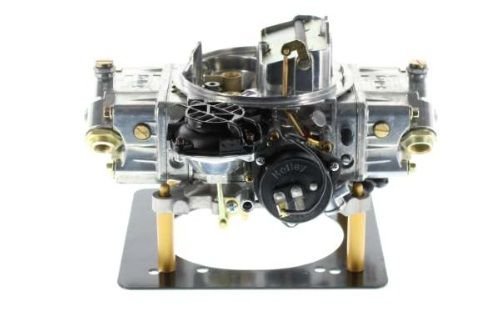

skinny z's Avatar
Joined: Dec 2005
Posts: 9,926
Likes: 889
From: 53.0907° N, 113.4695° W
Re: Fuel poured out of spark plug hole #8
Originally Posted by podiatra
Holley 670 street avenger. Does not have the small window to set the float. I set it up by removing the bowl and turn it upside down and making sure the float sat level across
The 670 Street Avenger I had didn't have glass sight plugs but it did have brass plugs in the bowls to set the fuel level.
Are you saying that yours doesn't? Or perhaps that's been overlooked?

Thanks! It does look like the one in the picture and I have removed the side plug to observe the fuel level when adjusting the float. In my current situation, I can’t get the primary bowl fill with fuel to adjust because the fuel goes thru the spark plug hole #8 when I crank the engine. Therefore, I removed the primary bowl (secondary is fine), turn it upside down, and adjusted the float level until it was fully horizontal. I was hoping that it would be at least a good starting point, but it didn’t work.
Old Aug 8, 2025 | 07:52 AM

Most Holley "performance" carbs are made like that.
Easiest way to set them and assure yourself (assuming of course that the carb isn't simply defective) is to lower the floats most of the way, like 5 turns on the needle valve or something (you can lower the secondaries even more, just don't bottom them out); crank up the car; and once running, slowly raise the floats until the fuel reaches the plug holes. The fuel should be slightly below the hole always. Primaries should dribble fuel when the car is gently nudged; secondaries should require more disturbance to get fuel to slosh out.
Are you saying that with the sight plug removed that you can't get the bowl to fill? And yet fuel is making its way to #8?
If that's the case, has this carburetor ever been disassembled? Sounds like there's something missing internally like the power valve.
