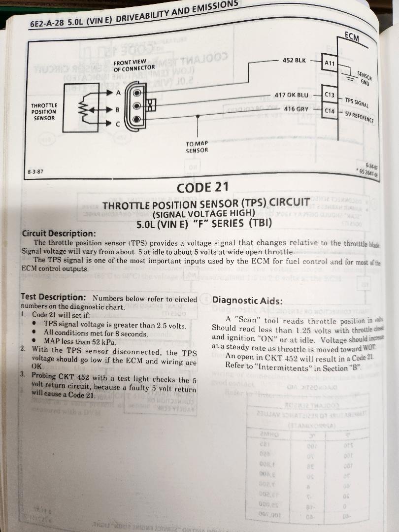

I just checked all the codes and the code 21 was on so I’m about to replace the throttle position sensor

I would check the voltage sweep on the TPS before changing it plus you probably would want to know what the TPS volts are at closed throttle.
Have you checked fuel pressure?

Light comes on with key in "ON", engine off = Normal, bulb check
Light goes out when engine starts = Normal, means no active codes (no faults happening at this moment)
Found code 21 = That's in system memory (otherwise the light would be on now), which means it saw an issue in that system at one point in time. Note it's the system...could be it's adjustable, but out of range. Could be a corroded connection, a wire chewed by a mouse, etc. It does not instantly mean a bad sensor, though it could be that.
Agree with the above....knowing the voltage with the throttle closed, and at Wide Open Throttle (WOT) would be a start. Watching a volt meter as you move the throttle and watching for a smooth change in voltage with no big sudden jumps or dead spots would also be helpful.
