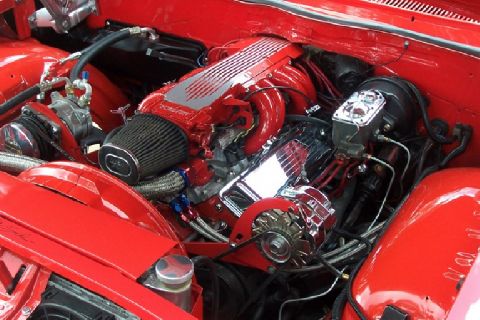

Have any of you tried putting the filter right onto the tpi opening, like they do on impalas and caprices, when making cold air intakes.

Re: HMM
You mean, bolt the filter to the throttle body diectly?
That's alot of hot air, if that's what you mean.

Yep
That's it. I'm up here in the Washington were sucking in water is more of a problem then hot air.
