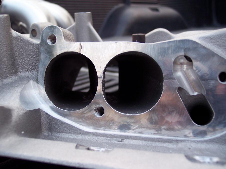

Okay, I have a decision to make. I recently won some stuff off ebay which included a ported plenum, ported and siamesed SLP runners and a ported stock base. My plan was to sell the base and go with a TPIS unit, but after recieving the parts I was so impressed by the port work done on everything that I'm wondering if it would even be worth it. I know I have read that a fully ported stock base will still not flow what a TPIS unit can, but how much are we talking about here? This sucker is hogged out, the runner ports match the SLPs and it looks like work was done throughout the entire runner length in the manifold. My combo will consist of a 383 with AFR 180cc heads, 224/230 camshaft with .510 lift, and I'm shooting for the 450hp mark. If I'm leaving 10-20hp on the table using this base I can live with that, but 40-50 obviously I'll go with a TPIS. Any advice?

Post up some pics. I just installed my ported base can't wait to see what that does.

I won't be heartbroken if i don't hit 450 on the mark. Any dynoing done would be on a chassis dyno anyways. Not only that but I'm still trying to figure out if I'm going to supercharge it with around 6psi or not. After reading through the infamous TPI shootout article again, the difference between an extrude honed base (which granted mine's not extrude honed but it is nicely ported) and the Big Mouth base was 10hp, and that was with larger port heads and a bigger cam. So I think I'll stick with this base.
Here are some pics of everything:

Those look nicely done, I would put them on if it was my car.
Here are some pic's you can use to compare them to my accel base and AS&M SS runners, might help in you decision.

I dont think thats been opened up like you think unless those pics are deceiving me. Looks like it got some minor sand roll treatment to the most restrictive part of the base in the middle, and most of the work at the ends where it meets up to the runner and the head.
A well ported stock base supposingly will flow as much as an unported aftermarket base, if that means anything.

A ton of port work has been done to that base, the the mid section is enlarged and the restriction where the base turns before entering the heads is now gone. It will flow quite well, probably very close to an aftermarket base. You might want to post some more pics of the ports where they enter the heads.

I see parting lines from the casting in the middle areas of the ports so... I dont think much of anything was done there.

I took a ton of metal out of the midsection of my intake and you could still see parting lines until I media blasted it.
