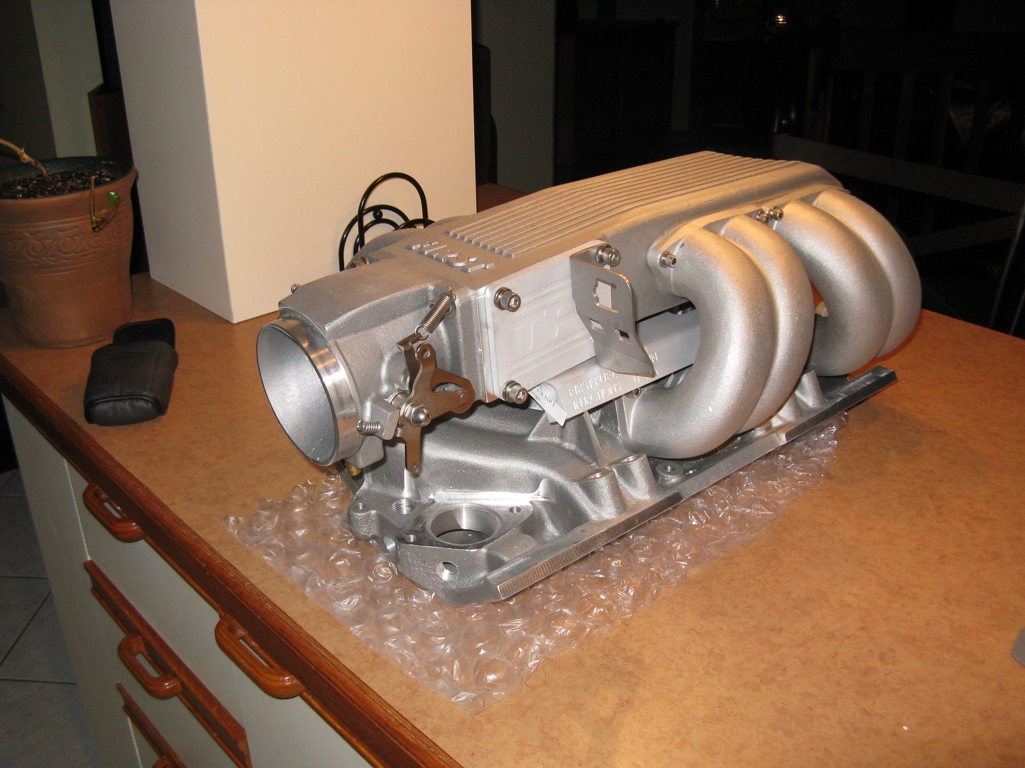

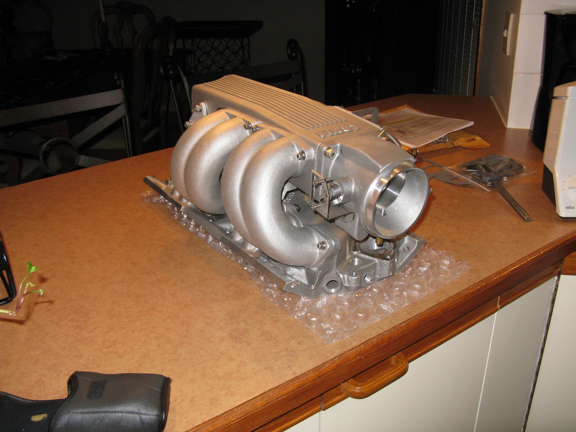

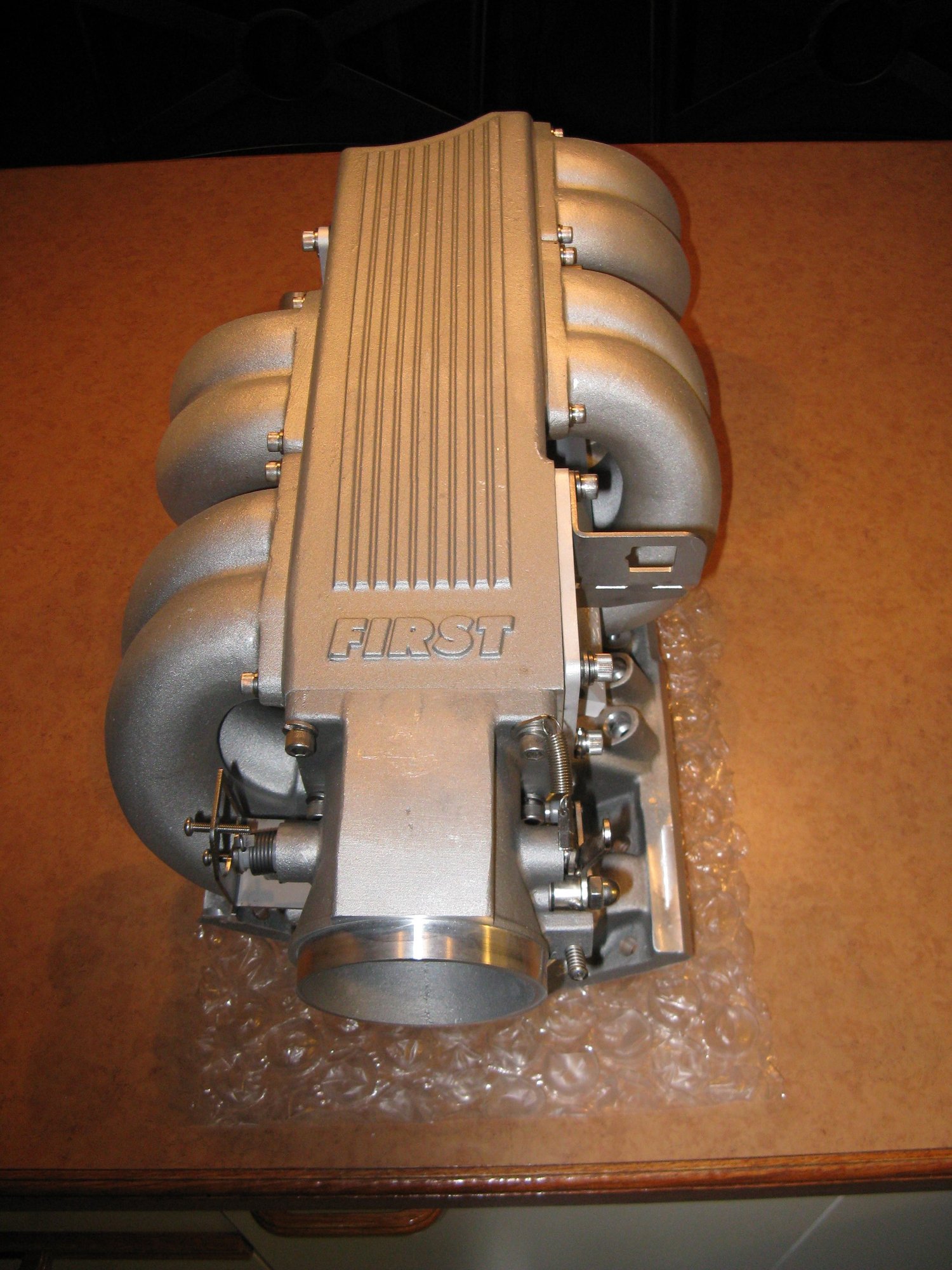

I'm running the FIRST intake on an SP383 and really like it. Runs like a scalded cat.
Keeps the same style as factory TPI, but flows enough to feed a 383.

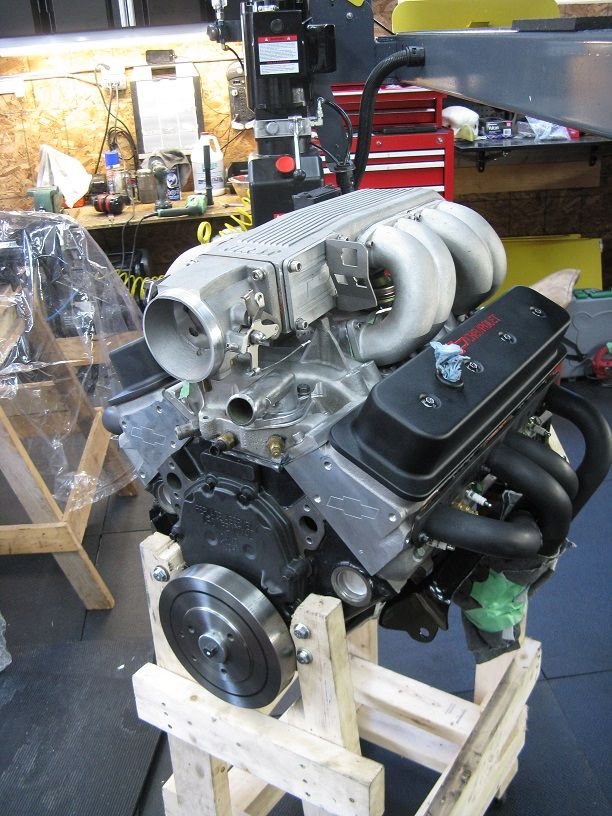

I used FIRST® TPI https://firstfuelinjection.com/
Bolted on a SP383 Deluxe. Vortec heads.
Love it! Not a track car. Street use and wanted to retain OEM look and hood.
