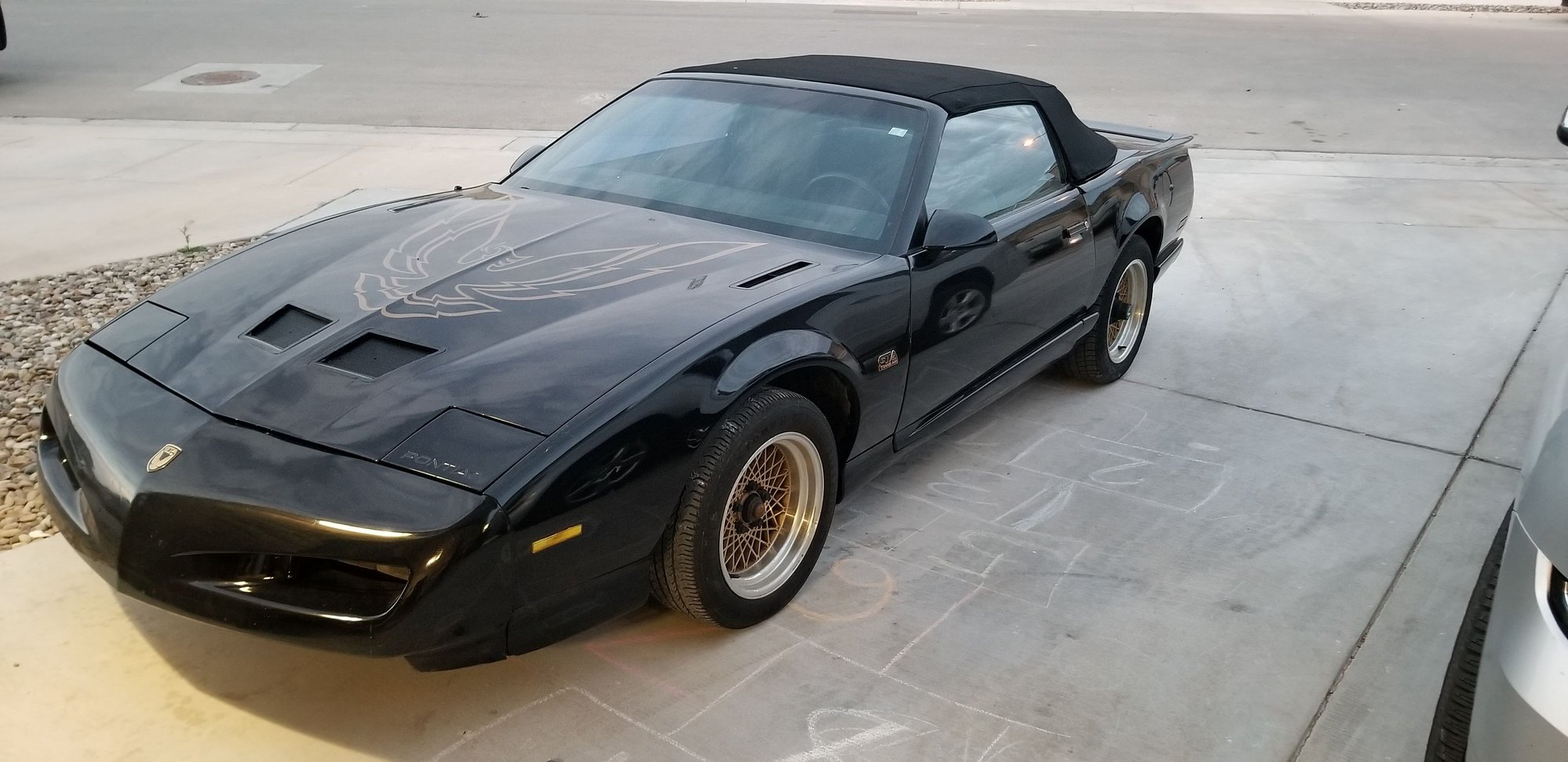

Hello all, I am new to the TPI world. I have owned 4 3rd gen trans am's and i am now on my first TPI. I have a 92 T/A convertible with the 305 TPI. I am looking into doing a heads, cam, and intake swap on it along with full exhaust. I have been reading many threads and trying to research things on my own and I am just getting confused and frustrated. This car is not going to be a race car, I am wanting something I can go cruise around town with all my buddies. I am wanting it to sound well and have a somewhat lopey idle but not sacrifice drive ability (I.E large stall). I have been leaning towards the trick flow super 23 heads but I'm not sure that will work with the Chevrolet ram jet intake i am looking at as well. I also have no clue what cam specs to go with either. I would love to get some input on what H/C/I combinations everyone else is running or for someone to point me in the right direction. I am a LS guy and have thought about swapping it but there is just something pulling me away from doing that. Thank you for the help in advance.
1992 Trans Am WS6. 305 TPI Convertible
