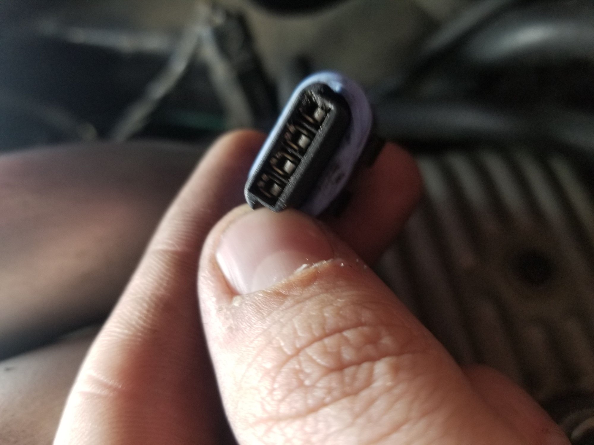

Purple with a white stripe is my guess.

Re: Not starting (help)
this ones connector broke off
It’s hard to see in your picture what broke. If you need a new connector here’s one.
