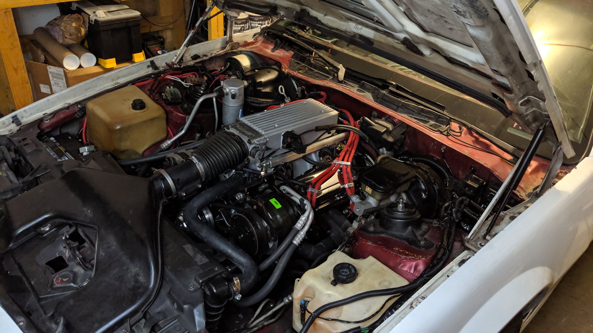

Originally Posted by scott1320
Thanks man Ill I was going to ask if you're hood shut with the HSR but I see your cross brace is cut. How's she run?
Yeah I had to cut part of the hood out because the hood was hitting the throttle body. The HSR not fitting might have been a combination of things such as my chosen engine mounts. However the hood wasn't cut much here is a pic. Still need to clean things up all over. So many little things...
It runs okay, not fully tuned yet. Sounds good though.
I need to swap the 42# injectors for 36# injectors tomorrow and retune it all over again.
Good luck with your swap! If you have any questions I may be able to answer, feel free to PM me.
