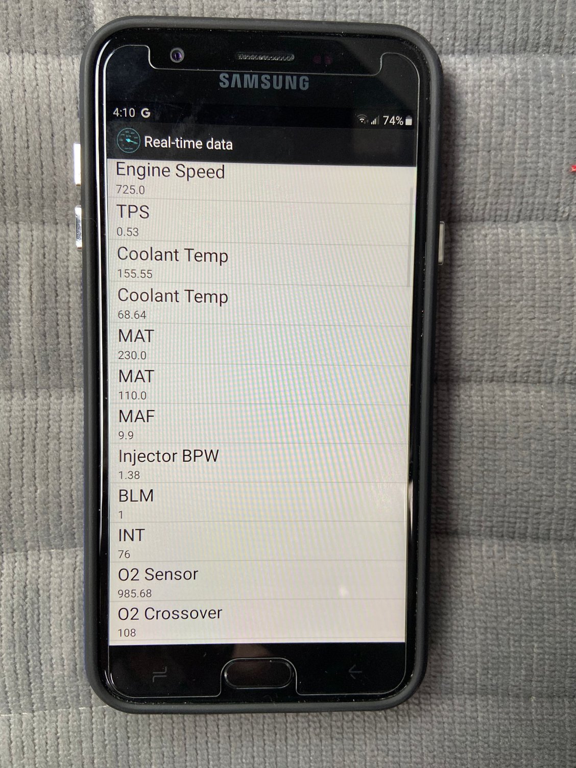

I’m starting to get frustrated after finally getting my car back together after installing a new big mouth intake, AS&M runners, and ported plenum. The car starts and wants to immediately die if gas is not given right away and if it dies will only start with hitting gas pedal. Also idle surges after letting off gas when idling, like hitting 450 and going back 850-900. My buddy and I almost think it’s off a tooth but we double checked it and timed it to 8 degrees BTDC. I am thinking the idle air needs to be adjusted to accommodate the aftermarket parts. I also looked at the L98 start up sequence and according to that it’s either vacuum leak, intake leak or idle air mixture on TB. The idle has never been touched either as evidenced by the factory plug in the TB.
After driving 30 miles the idle has improved with the re-learn but still does not want to start up correctly. The FPR is 2 years old as well as the Bosch 3 injectors and no check engine light. I also double checked TPS voltage and did the IAC reset. Fuel pressure is at spec around 43-44 with fpr line disconnected.
When it was idling with aldl droid

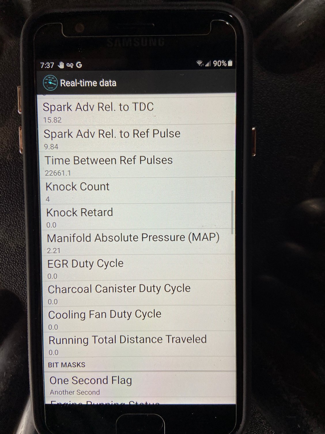

Thats an idea, this was my first try with aldldroid but couldn’t get BLM to read. I’m going to double check timing tomorrow. What’s odd is once it gets nice and warm the idle is better but still doesn’t want to start and stay running unless I catch it and give it gas (acts like it’s flooded almost). It had a massive vacuum leak before that I fixed and it’s idle was very high, over 1100rpm or more, but after fixing that I had this issue.

Still getting wonky numbers on aldldroid but I busted out my vacuum gauge and I’m pulling nearly 20 inches of vacuum...18 at idle to be exact at the FPR port.

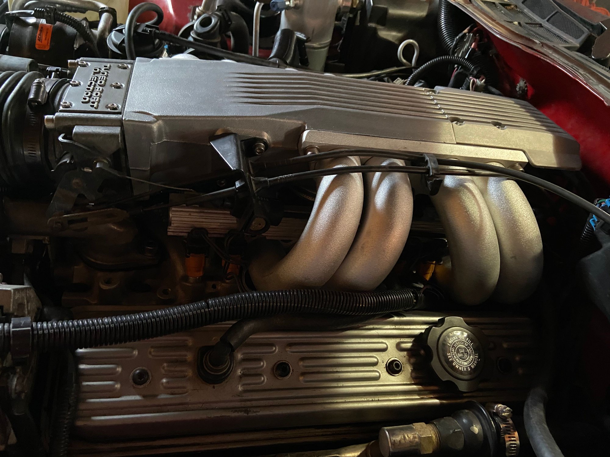

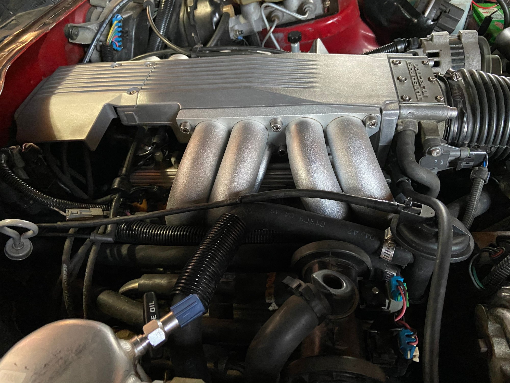

Do you have a good driver and pass side picture of the engine ? Have a few questions that are answered easier with pictures.
Also, I've noticed several after market lower runner flanges are larger than the machined area on the intakes and have to be ground on to fit.
Old Apr 19, 2021 | 07:08 AM
Reddragon88gta's Avatar
Joined: Apr 2017
Posts: 1,149
Likes: 445
From: Northern NY
Engine: 5.7 L98
Re: L98 starts and dies after new intake
Old Apr 19, 2021 | 07:38 AM
TTOP350's Avatar
Posts: 12,228
Likes: 1,156
From: Il
Engine: 4++,350 & 305 CIs
Hard to see in the picture but does your driverside have the small tube between runners? (like the small tube on the pass side)
Old Apr 19, 2021 | 08:09 AM
Joined: Apr 2017
Posts: 1,149
Likes: 445
From: Northern NY
Engine: 5.7 L98
Sorry the picture was lousy, it does and it’s blocked off by AS&M because I went with 89’ up runners because I had previously disabled the cold start injector in both the prom and on the rail.

IAC count seems really high considering you're in closed loop.

This isn't mine but it's how I do them. For the most part it's mix and match at will then.

Right there where I highlighted?
Any idea on how big a hole to drill? I see you that one is gone completely

I wound up going with the TB version of a fix by cutting out a groove in both sides of TB bores to IAC triangle, it worked great! Car idles right up and no more start and die. Thanks again for everyone who helped.

I realize that you think it's fixed but your data indicates the MAF at idle is much too high and that's also reflected in the INT and BLM being buried in the negative fuel trim - it's pulling out as much fuel as it can because your MAF is reading almost 10 grams per second when it should be closer to 5-6 grams per second. MAF or wiring is boned.

True, after seeing how rich it was the next day or so I put the Bosch MAF back and maf readings went back to 5 and BLM was almost right on 128 same as INT.
