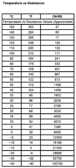

Use an ohm meter to check your coolant temp sensor. 2 pin sensor in the front of the intake manifold.
Then compare your reading to this chart
