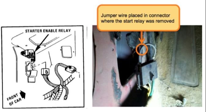

Have you bypassed the starter enable relay?

The car was originally equipped with vehicle antitheft system. The passkey module controls the starter enable relay located under the drivers side kick panel. Test fir power while cranking or bypass.

I bypassed the starter enable relay and she started right up.. Thank you. Now my question is what is my best path forward from here? How do i fix this issue? is it as simple as connecting those 2 wires together permanently? Is there a better, more professional way to fix it?

It would be best to determine whether the start relay has failed contacts or is not receiving power to the coil. There could be a problem with the neutral safety/clutch safety switch, VATS, ECM connections, or other wiring maladies.
@chazman did you try this?
