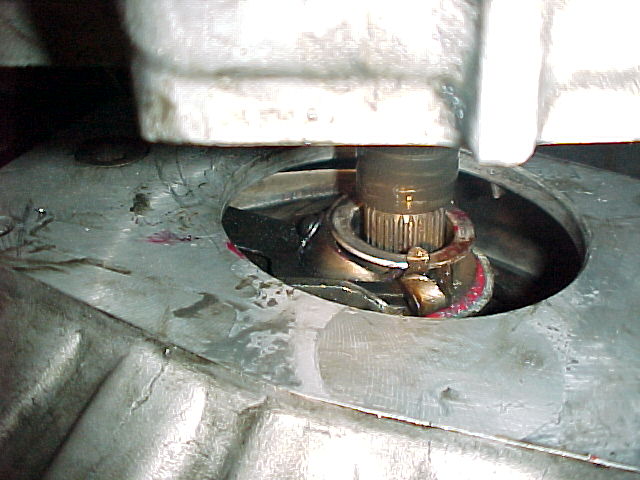

Originally posted by RB83L69
Maybe it should be a sticky..... I get tired of typing it.
Yup, Sticky those pics!!
Rb's nick name should be the "Throw out King"
in fact I'll even save him some time:
The ears on the fork should be on the throw out bearing like in the second pic.

pic:

so is top or bottom correct?

Originally posted by novass
The ears on the fork should be on the throw out bearing like in the second pic .

so i guess you arent supposed to clip the throwout bearing inbetween the two pieces of the fork. the pics are kinda blurry.....

Those little "ears" are the tabs of a piece of spring steel that's riveted to the fork. They're NOT supposed to "clip" over the lip of the throwout; they're supposed to be inside the groove int he throwout, along with the main thick piece of the fork. All that spring is supposed to do, is to take up any play between the fork and the throwout, such that the fork is always up against the business surface that it works against. If you "clip" the ears on the back of the bearing like the top pic, it pulls the main part of the fork to the REAR of the groove, and holds it there; so when you push the clutch, the first thing that has to happen, is you have to take up all that slack. It takes about 1/3 of the total pedal travel to do that. Which ends up, that your pedal is only moving the clutch about 2/3 as much as it's supposed to; so it never fully releases.

i'm having this same probalme. but i dont' under stand were the fork clips ar spouse to go. all i did was slide th TO in the fork so it would stay and thats what i was todl to do. so help

Wrong...
Old Sep 26, 2004 | 02:42 PM
RB83L69's Avatar
Posts: 18,457
Likes: 16
From: Loveland, OH, US
Car: 4
Engine: 6
Transmission: 5
Right....

ahhhhhhh...thanx rb i can see whats up now. the other pics were a little too blurry. and im glad my input shaft is cool. i did have some stiff shifting and reverse grinding so i guess im okay. the only problem was me not being able to downshift into 3rd but im hopeing (like you said in another thread) its only the pilot bushing.
