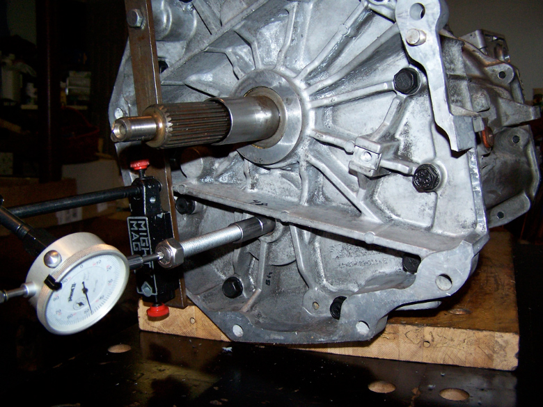

How many miles on the T56 ? (assuming it's used?) It sounds like the 5/6/R extension is not shimmed correctly, or the 5/6 driven gear is loose on it's splines. If the driven gear is loose, it can/will eventually shread the splines on the mainshaft, and you'll loose both 5&6.
You can check the 5/6/R shimming without opening up the trans, but you have to pull the trans and get a 2' piece of metric allthread to thread through the front plate of the transmission..
http://www.eecis.udel.edu/~davis/z28...e/102_7966.jpg

thanks for the link. what are the chances of a used tranny having that problem? when i bought it i was told it had about 79000 miles.
