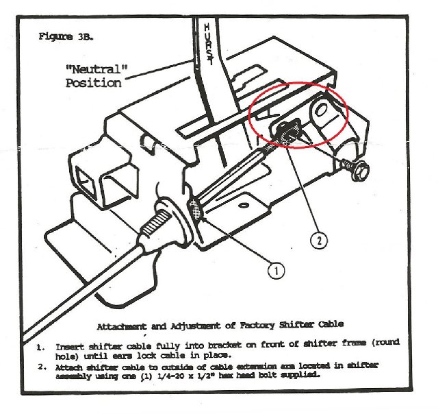

Oh, it changed. It had to have. There is zero chance of the stock cable reaching the bracket on this unit, it was the first thing I checked. It's also a specific step in the instructions, which are original and describe how this cable is supposed to wrap around the rear of the tranny. See Page 2 Step 3.
It does use the stock column lock cable though. The one I have matches the diagrams here EXACTLY, it's the one for our cars.
https://www.shifterdoc.com/Hurst_292...nstuctions.PDF

Skinny Z describes the cable routing. It might help to lower the transmission temporarily.
This is no help, but comparing the installation instructions above to the one that came with mine (dated 1990), this appears to be the only difference:
I don't know why Hurst would re-design the shifter that would require replacing the cable. Unless it was prone to failure.
