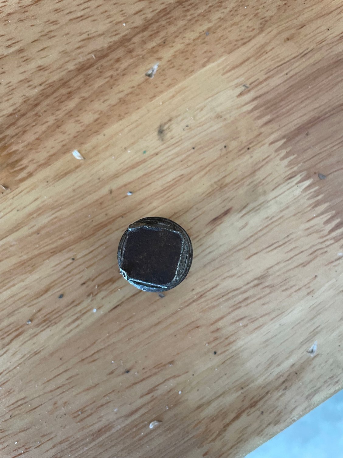

Attached is a picture of my drain plug. It is slightly leaking around but still have about 3 threads to go. I can’ t get it to rotate anymore with my vice grips. The only ratchet I can get to almost fit is 3/4” (6point) but stripped it.

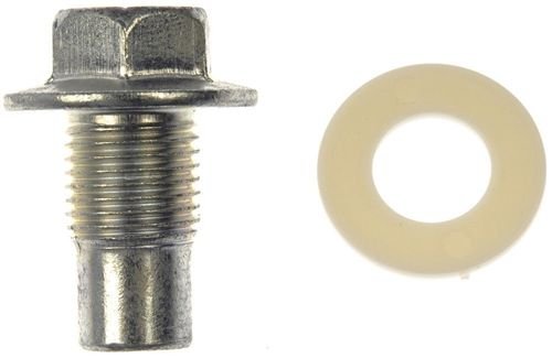

This is what you have for your oil pan drain plug???
That is not the correct plug. You are showing a pipe plug with NPT (tapered) threads.
Your oil pan uses straight threads with a sealing washer under the head of the bolt.

Re: Correct tool- T5 drain plug pictures
This is the manual transmission drain plug.
Reply 0
Sep 9, 2023 | 07:57 PM
Ok then, use pipe thread sealant.
search out a "recessed square," plug, which will take a 3/8" extension. Simplest and most commonly available.
