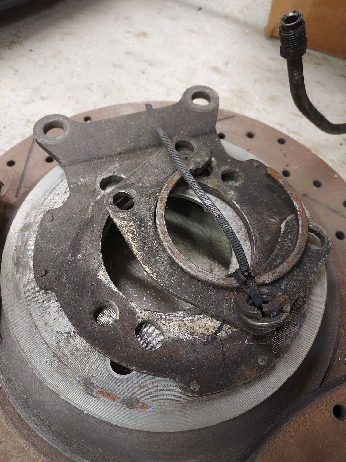

Posts: 12,228
Likes: 1,156
From: Il
Engine: 4++,350 & 305 CIs
Re: Aftermarket 9" with LT1 backing plates
This is the parts i used on my large bearing ford 9". The bracket is the factory 89 9 bolt bracket, have a ford bearing retainer and a ittle custom shim to put psi on outer bearing race.

Interesting, so you used both the 9 bolt backing plate and a Ford retainer?
Posts: 12,228
Likes: 1,156
From: Il
also drilled or elongated a few of the 4 bilt holes to fit new pattern.
