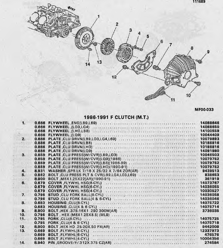

Also, you should (might) be able to track down all the specific bolt sizes using the parts and illustration manual: https://austinthirdgen.org/wp-conten...lustration.pdf
If this isn't the right page, it should be within a few pages of it:

Trans to BH bolts are yerbasic 10mm std thread (1.5mm? not sure) flange head. About 30mm or so long. You can get em at Autozone and the like, no need for $$$ARP$$$. Factory ones have an Allen or a Torx depending on year butt that's not necessary unless you're in the factory with automatic assembly eqpt, because one of em you can't get a socket on because it's behind some stuff. A wrench works fine butt the factory's takt time for each assy station on these cars was like 31 seconds, so yeah. No time for a wrench. Would have taken like 47 seconds which ... they couldn't slow the line down that much.
In the early years of these cars the factory used 2 starters. No idea why they did something that stuuuuupid, butt hay, It Is What It Is, now, in hindsight. An early manual starter will fit auto trans butt an early auto starter won't fit a T-5. At some point in the production run somebody that actually HAD neurons rubbed 2 of em together and one of them actually fired (!!!!!), and they abolished the stuuuuuupid one. Problem now is, cores that get turned in to be rebuilt, could be either; and there's no good system for identifying the finished starter built with whatever nosepiece. The starter proper is the same; it's basically the same old Delco direct-drive POS that dates back to before World War 2; only the nosepiece is different, and it's only a tiny bit different, wherein the auto one has a kind of a lump or thick place (it can be ground off butt it's a PITA) that won't fit in the T-5 BH; butt it's ALL stuuuuuupid. Stone Age. Neanderthal. I'd avoid it if at all possible. Virtually any later model reduction-gear starter will fit as long as it has the bolt pattern for the 12.8" wheel which nearly all do. Practically any of the aftermarket mini-starters whether built with a Delco GR motor, a Hitachi, or a Nippondenso motor will work; all of the LT1 ones, etc., can be used, whether F-body or Vette. The later LT1 ones (96-up I think; always order a 97 just to be sure, except that the Vette changed to the LS1 in 97, so don't order that, it won't work) are better than the earlier ones. Be aware that starters require starter bolts, which are NOT just regular ordinary bolts; BE SURE to get the right bolts for whatever starter you choose.
Shifter to transmission bolts are 8mm std thread. Length will depend on whatever shifter you use. Stock shifters are made of real thin stamped sheet tinfoil GARBAGE, so about a 15 - 20mm length will do. A better shifter will require longer bolts. I hope you're not planning on actually putting a stock shifter in your car. It feels like there's a bowl of oatmeal somewhere between the **** and the gears. It SUCKS.
For the speedo gear you need yerbasic speedo gear "bullet". Same one fits Turbo 350. Widely available anywhere transmission parts are sold. Don't EVEN hallucinate about getting a used stock one; they're made of cast chinesium, and it's such CRAP that the plastic gear wears them out. Replacement ones are steel. Get one of those instead. Gears are a different matter; obviously you need the right combo for whatever your rear gear is, and depending, that might be tougher than the "bullet".
BH to engine bolts are 3/8"-16 x 1½" or so. Can't imagine any benefit from buying $$$ARP$$$ for that in a street-driven car. Hell I have a truck with a 300ish HP 5.3 and the factory only even put 4 of em in there, and they're just ... yerbasic bolts. (except for the ones that have extra stuff hung off of em, which are studs with a threaded extra part) Once again, parts store stuff is ENTIRELY adequate.
