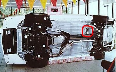

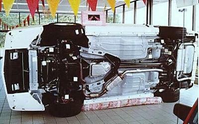

85SportCoupeto89RS: Where did you get that picture from? That kind of reminds me of when I went to Hendrick Motorsports in Charlotte. They did not have a Camaro there, but they did have a ZR1 Corvette that they claimed was the first one built.

Could you email that side pic to me?
That helps with many details I seek to see, without getting under car!
PS I see OFTEN that angle of a car, but with more fan fare and a police escort to boot!
