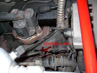

I'm curious as hell- Can someone who has trouble with their #1 plug take a picture of the situation and put it up here?

I will see if I can get you a pic tonight when I get home.
It's not really a prob getting to the plug, it's getting a hold of the frigging boot so you don't destroy a perfectly good wire.

Here's a pic of the offending sparkplug access if this works.
[IMG]sparkplug.jpg[/IMG]
