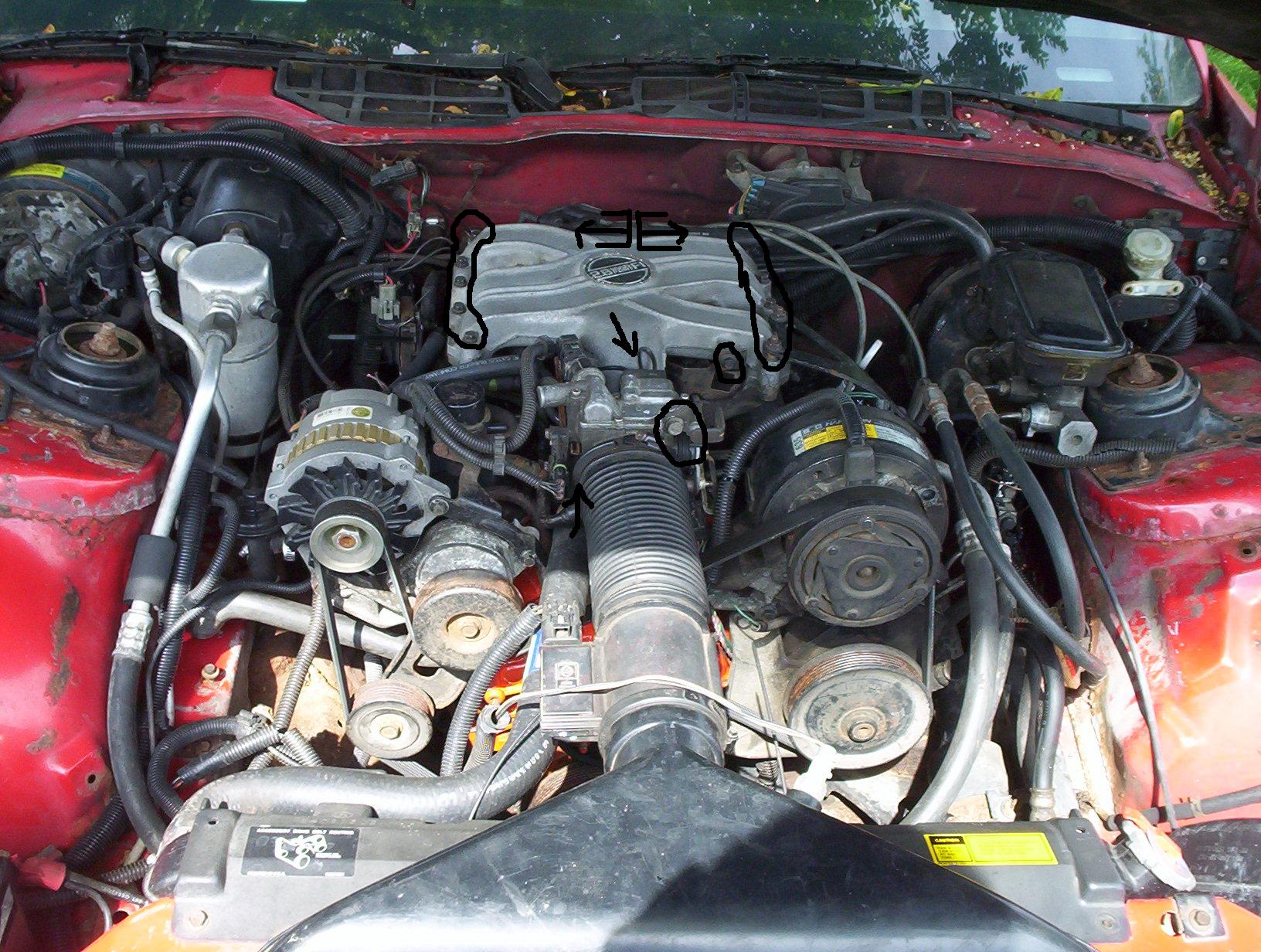

its not too bad. you have to remove the upper plenum (manifold) and the fuel rail. you might be able to get a fuel rail with injectors for cheap, but if you don't its no big deal. I'll post up a picture showing you what to disconnect to get the plenum off. at first it seems like a lot, but once you do it about a hundred times, its really simple.

got it modded. you'll have to remove the EGR tube also, but its pretty simple. take off the vacuum lines on the back, unbolt those 5 bolts on each side, unbolt the throttle bracket, 2 bolts on the front of the throttle body, take off the throttle cable attatchment on the throttle body. Its a clip, you can just press it down and it'll come off, I'm sure you'll figure it out. lift that off and the fuel rail is held in by 2 bolts. press on the screader valve to relieve pressure. disconnect the fuel lines and use a screwdriver to pry the rail and injectors out little by little.

forgot to upload the pic
i need to take out the fuel lines and injectors? to remove and insert the new fuel pressure regulator?

just unhook the fuel lines, the injectors will just come out with the fuel rail. you don't have to take out the injectors unless its to put them into the new fuel rail.
