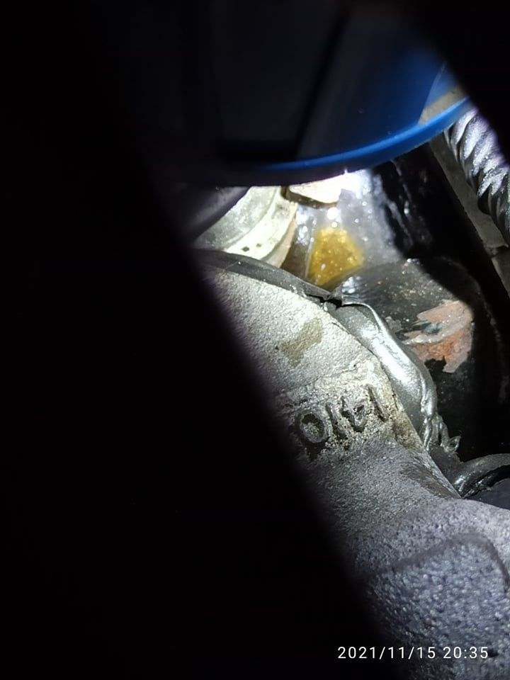

i thing i have the same problem . Can somebody tell me step by step how to change that o-ring ?? Do i have to disconect any cables or battery ? Why do i need that gun ? thx for all answers .

"Do I need the gun"? Answer: Yes, you need a timing light to set the initial timing on the engine. You can buy (or possibly rent) a timing light from most parts stores.
As far as a step by step tutorial, generally any distributor replacement tutorial on Youtube or any other forum will walk you through it. Also, you don't necessarily need a new distributor, just a new o-ring on it. The most difficult part, in my opinion, is loosening and tightening the single bolt that holds down the distributor. And yes, you do have to disconnect the negative battery cable from the battery.
