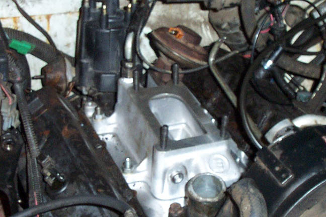

So, I'm not the only one who want no computer. Here what I did. I got a 2BBL. Carb off ebay from an 82 s-10, I also got a vacuum advance distributor off an 82 blazer. I replace both the carb and dist. along with a new Edelbrock Intake. I also got rid of my smog pump, AIR exchange valve which eliminates the need for the AIR tube on the cat and the lines one the exhaust monifold. My timing is set at 14° ingnital without vacuum advance hooked up. With advance hook up i'm running 20° at WOT with no pinging. I gained about 25hp just from the swap. I'll upload pics on here if you want to see.
Good Luck,
Robert

I have SMOG here, i'll pass

i'll post better pics tommorow
