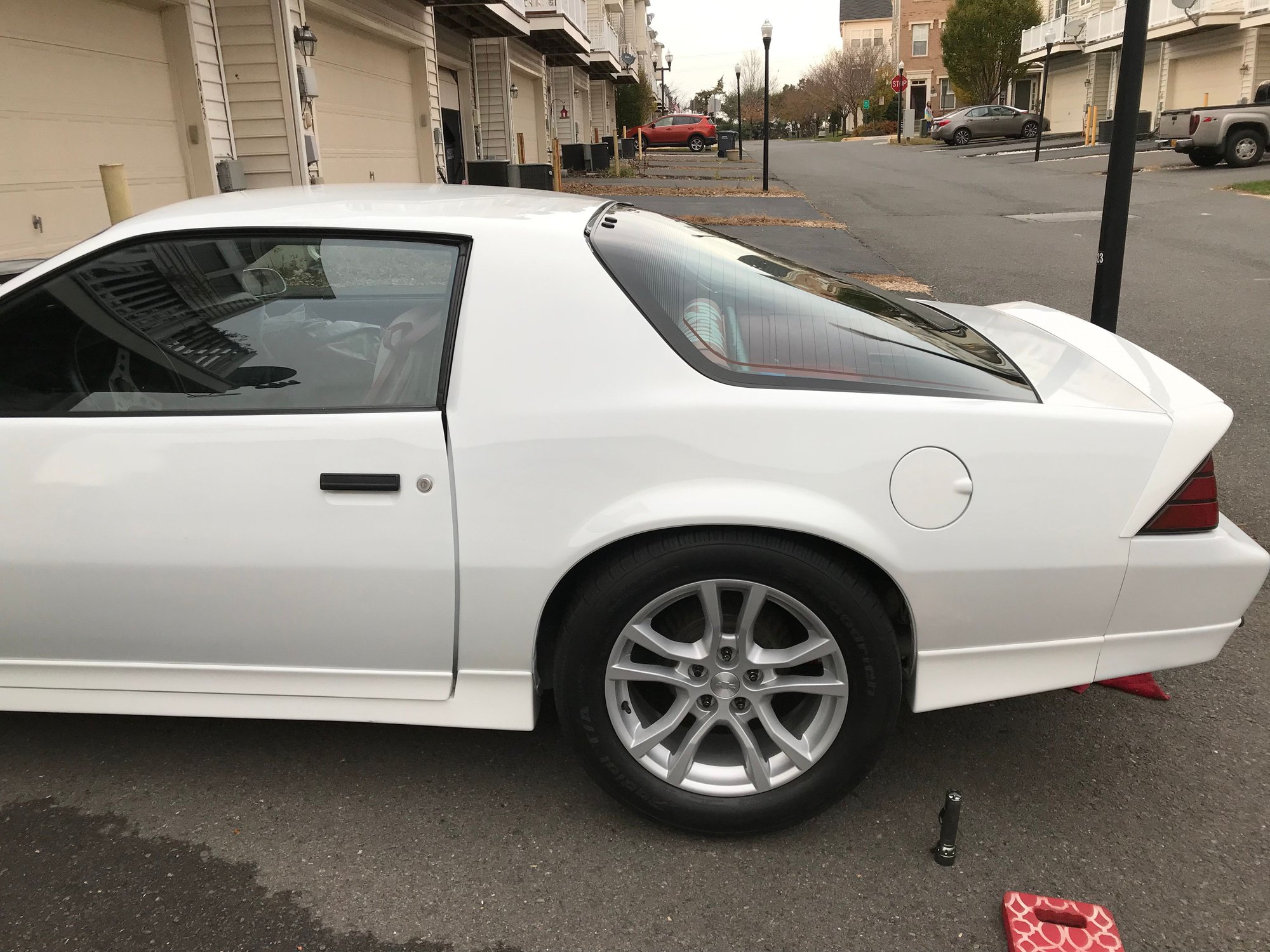

I did get the spacers in and test fit the wheels and tires. With the 1” spacers out back there were no issues as far as fitment. The fronts however interfered with the chin spoiler when turning with the 1.5” spacers.
I also witnessed that a 120mm and 4.75” lug spacing is different and did not feel comfortable bolting the purchased 4.75” to 4.75” spacer for the 120mm bolt pattern. I’ll be purchasing some 4.75” to 120mm spacers from EZAccessory at 1” and 1.5”.
Ive also decided to run my wife’s equinox 17’s on my car and have already swapped these 18’s on hers.
Will send pics once I have them installed.

You need shorter tires so they dont rub the chin spoiler. 30 or 35 series tires will do it

Old Dec 9, 2018 | 02:16 PM

Nice fitment. What spacers do you have? Do you know where they came from? Can you send tire size out front?
Thanks,
-Chris
