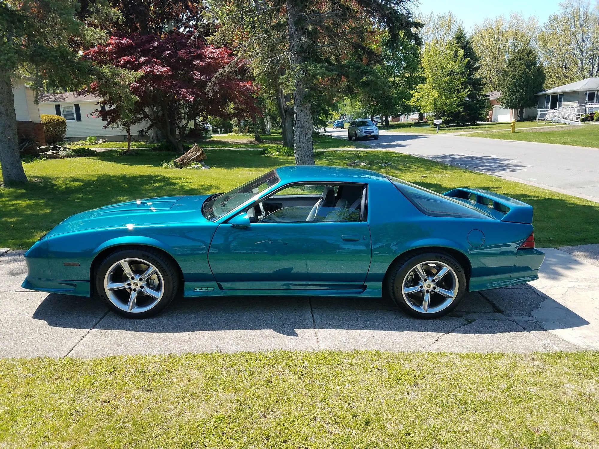

Still working on putting car back together but wanted to post a few update pictures. I did purchase the Michelin tires and ROH RT rims. Tires shipped mounted to rims which saved me trip to mechanic. In person the rims are amazing. The black ice coating was worth the extra money. The rims are angular and also smooth from varying angles. Picture up close of rim is with flash so you can get sense of the black ice coating. Second picture is without flash and normal shop lights. Also received Vogtland springs, had to wait a month for factory in Germany to ship them out! The tires seem really nice too, hopefully I can try them out on the road in a few months. I know rims are personal to everyone, just glad found style that I like.

Thank you! I took LAFireboyd's advice so all tires are about 26 inches tall which matches stock height. For some reason I did not think about the 255 tire size. Sizes bought noted below. Front rotor and caliper in picture are LS1 style. Would be nice to have bigger brakes to fill out rim but it looks fine. Not swapping parts now
front 18x9 255/40/18
rear 18x10 285/35/18

Had car together since last fall but have been working out gremlins to get on road. Someday I will post a full build thread but here are few pics with rims on finished car.
