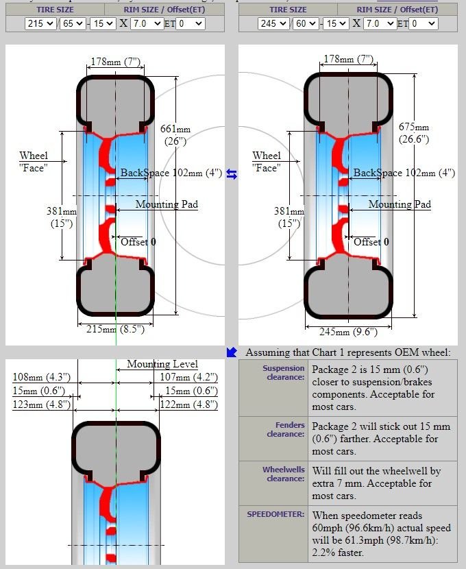

235/60r15 is the same overall diameter as the stock 215/65r15. 245’s will be taller, will cause the speedometer to be off and may rub in the front when turned full lock.

I just installed four 245R60X15 BFG Radial T/A on my '84 Trans AM today & they look great. 245R60X15 is 2.3% greater circumference than 215R65X15. Thus no need to change speedo gear.
