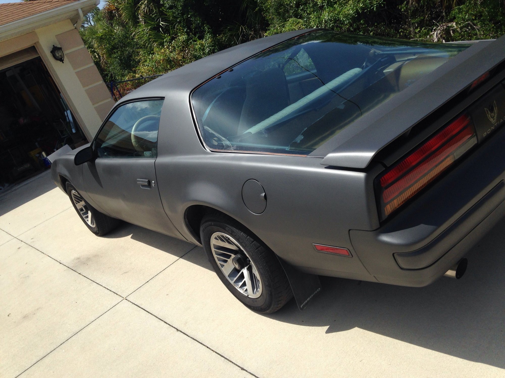

IMissMy86TA's Avatar
Joined: Aug 2007
Posts: 2,188
Likes: 50
From: Dallas

Old May 11, 2015 | 08:16 PM
  #273
spoazzy1's Avatar
Joined: Jul 2011
Posts: 42
From: SW Florida
Car: '89 Firebird
Engine: 305 TBI V8
Axle/Gears: Stock
Re: The Plasti Dip Thread!
Then you should have no problem. It would be way easier too cause you wouldn't need as much coverage coat wise (depending on color change of course) because you already have those layers down. They have tutorials on YouTube through dipyourcar.com if you want to see the prep needed, if you need them. They make it super easy.
