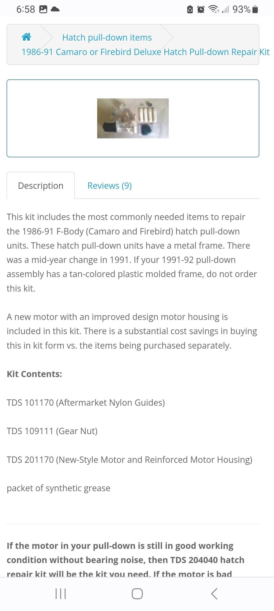

I did some digging at TDS
found this:
found this:
I think you just need the guides but I have used the deluxe kit to rebuild mine as it was broken, has held up really well.

I ended up ordering the deluxe kit from top down Solutions got everything put back together. got everything lubricated put the assembly back on the car. the striker on my hatch is now aligned perfectly it hits the latch dead center like it's supposed to. my hatch light turns off. my release switch unlocks the latch, with the key, and with the switch but the motor will not turn on and go down or go back up. and that's with the relay reattached both the black ground wires the small ones reattached. although I got some arching from the really small ground wire I don't know where it goes to but when I connected it to the body I got a little bit of arching. I attached the two wires that I had to unplug one is black and orange going to White the other is red and white going to Blue my unlocked solenoid for the hatch release switch works perfectly I have a big ground wire going from the hatch release solenoid to the actual body right up underneath the latch assembly and I have my wiring harness hooked back up to the motor and the motor plugged back in. I don't know what that is but I guess it's a computer board that attaches directly to the motor has a screw that keeps it in place. there are no fuses blown. I can't figure out why the hatch won't move up and down
