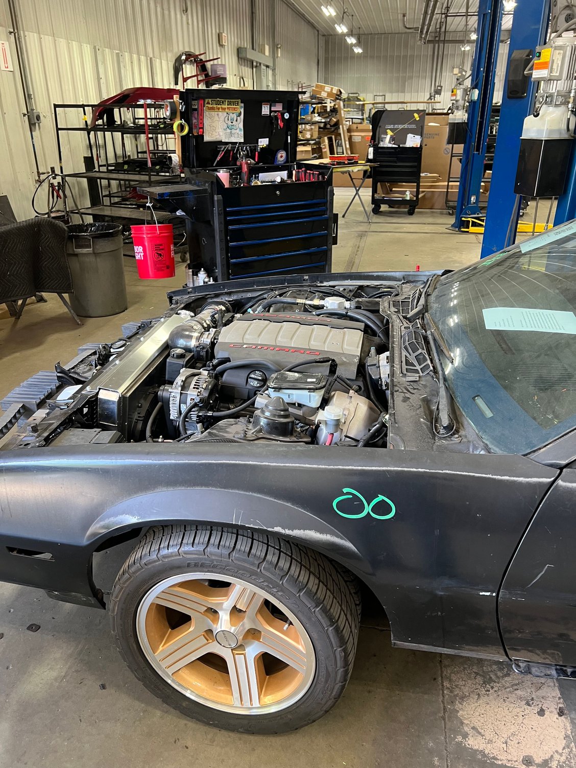

Paint Prep....What Else to Remove?
I'm really into getting the IROC ready for paint. I removed the door weatherstripping and glue, mirrors, front emblem, rocker emblems, rear bumper emblems, front side lights, antenna bezel, spoiler, ground effects along the door. I removed the tail lights and cleaned all around them. Should I remove the lock cylinders on the doors and hatch? Door handles? Should I remove the headlights? I verified that I could remove all the screws, none are frozen. I am leery to remove the front and rear ground effects. I have to drive it to whomever will paint it. I haven't messed with the hatch weatherstripping. Is it standard for painters to remove the hatch to paint that area?
Old Apr 25, 2025 | 04:33 PM
bk2life's Avatar
Veteran: Army
Joined: Jul 2016
Posts: 810
Likes: 224
From: az
Car: 91 WS6 GTA
Engine: 5.3
Transmission: 4l60e

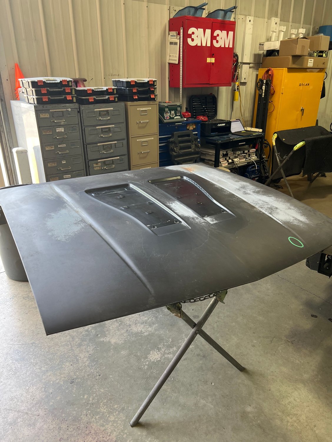

Re: Paint Prep....What Else to Remove?

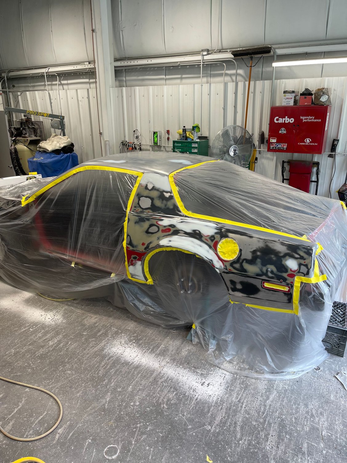

mine looked like this when it was being painted

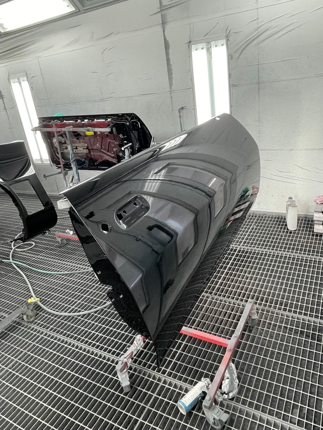

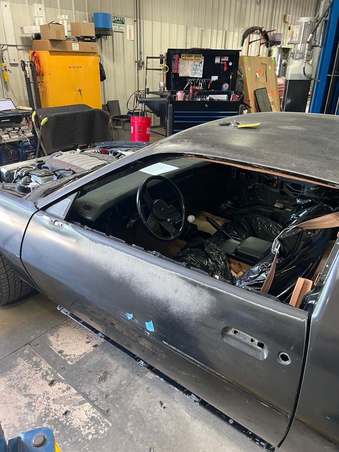

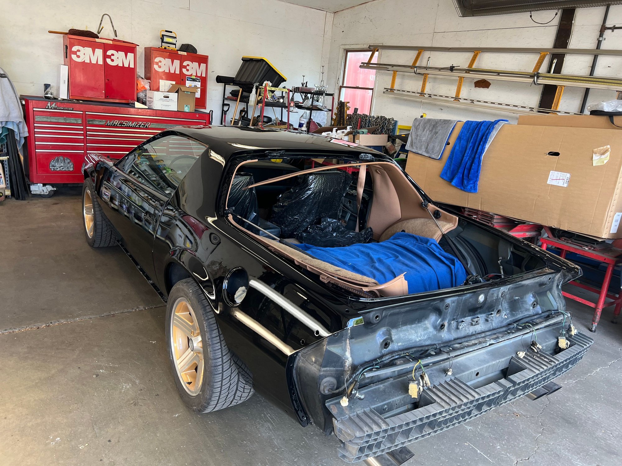

This is what my car looked like in paint. If you want a good job, it's got to come a part. Everything came off. All glass,parts -everything. You may as well do door seals/hinges and all the other little stuff while it's off.

I prepared my 1972 Buick GS for paint. If it was not welded onto the car it was removed - interior & exterior. Car was stripped including vinyl roof. I even removed the rallye wheels & installed old wheels & tires

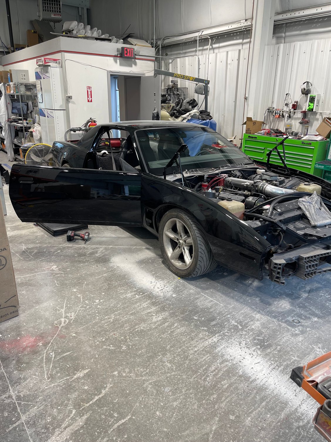

Looks like decisions were made for me by the body shop guys. They told me I should remove the front and rear bumpers plus the hatch and hood. Not sure if the doors are coming off to do the full jams but that might happen. I was surprised that I took it over for an estimate and the next day its being worked on. I lucked out when he said they were a bit slow right now.

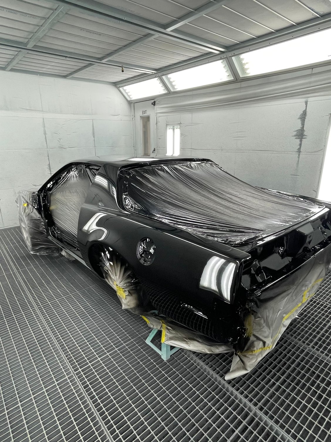

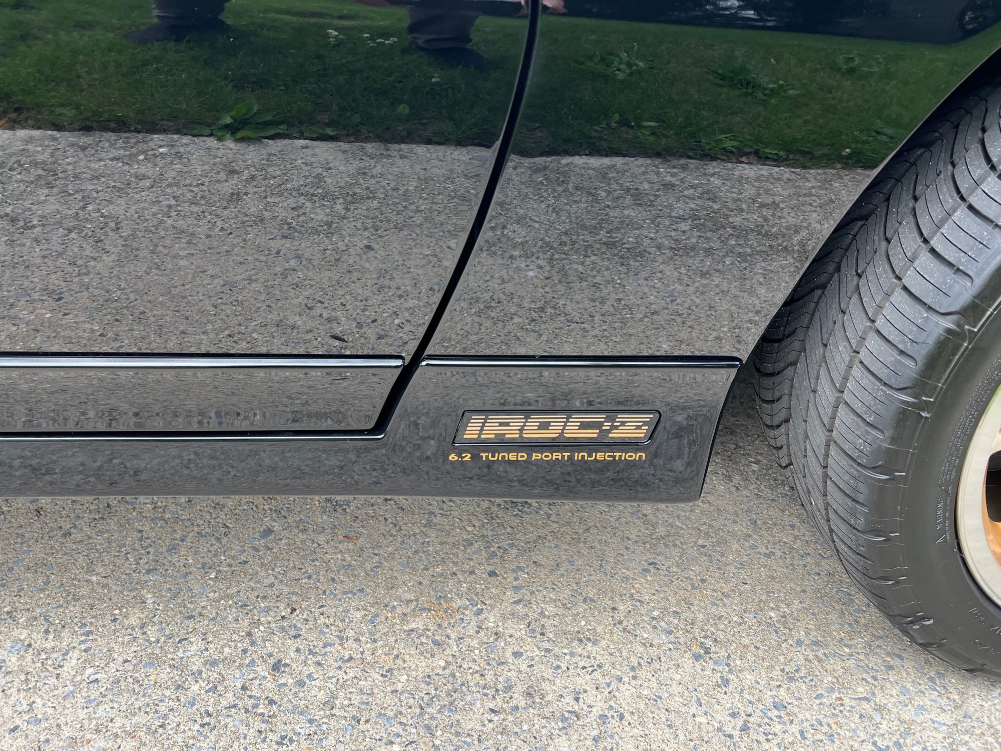

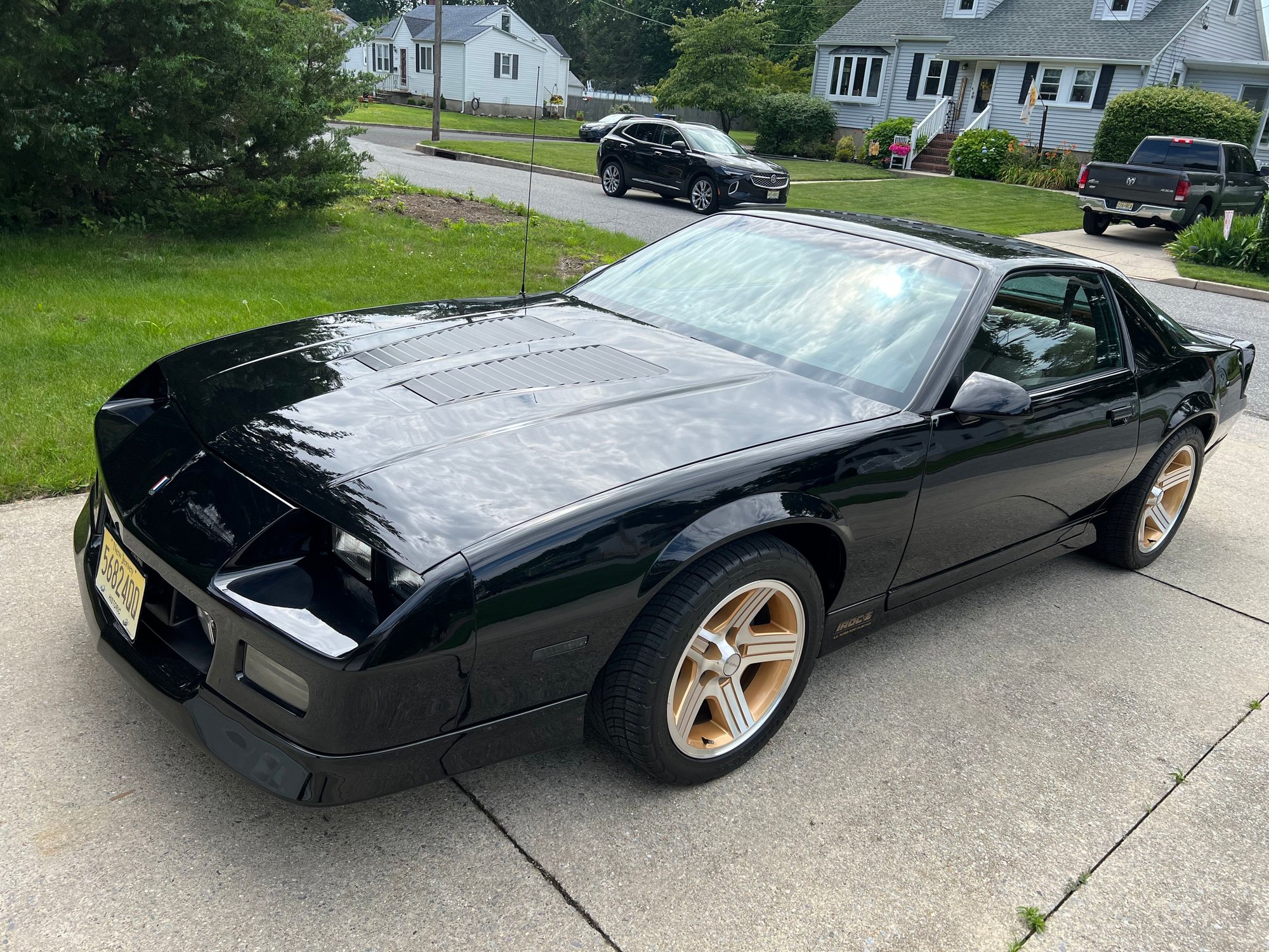

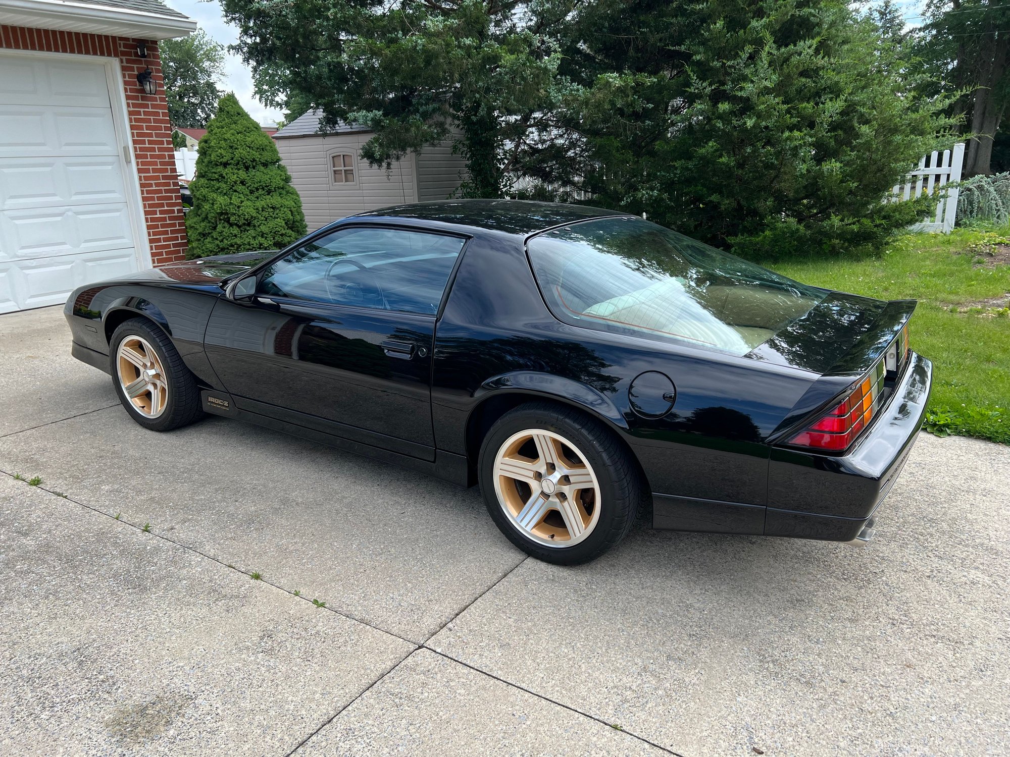

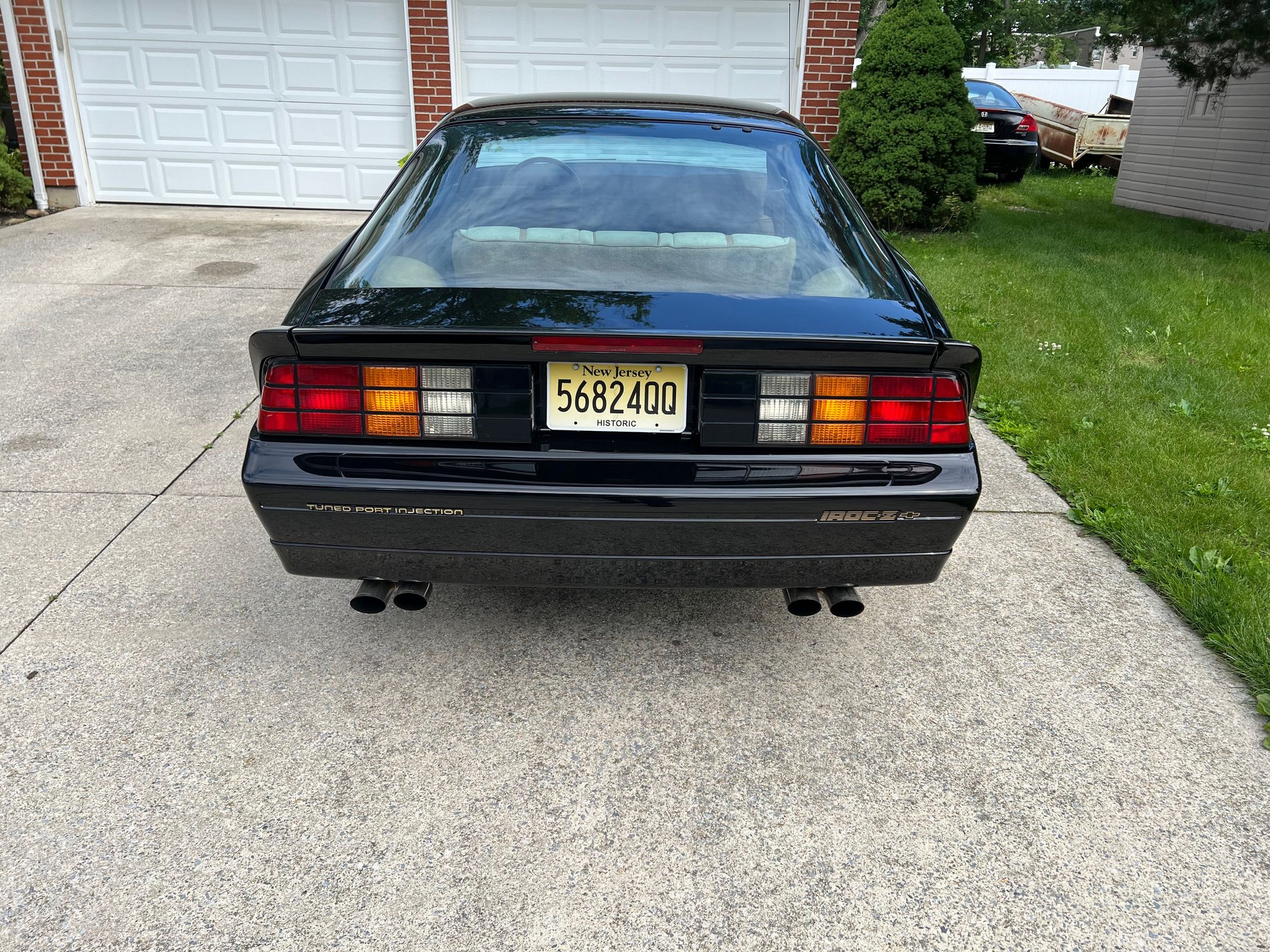

It’s finally painted!!!!
Old May 7, 2025 | 08:28 PM
TJQIROC's Avatar
Joined: Aug 2003
Posts: 333
Likes: 20
From: South Jersey
Car: '16 Camaro SS, '88 IROC
Engine: 6.2 Gen V
Transmission: 6 spd TR6060

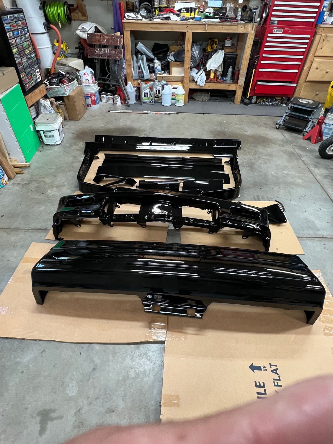

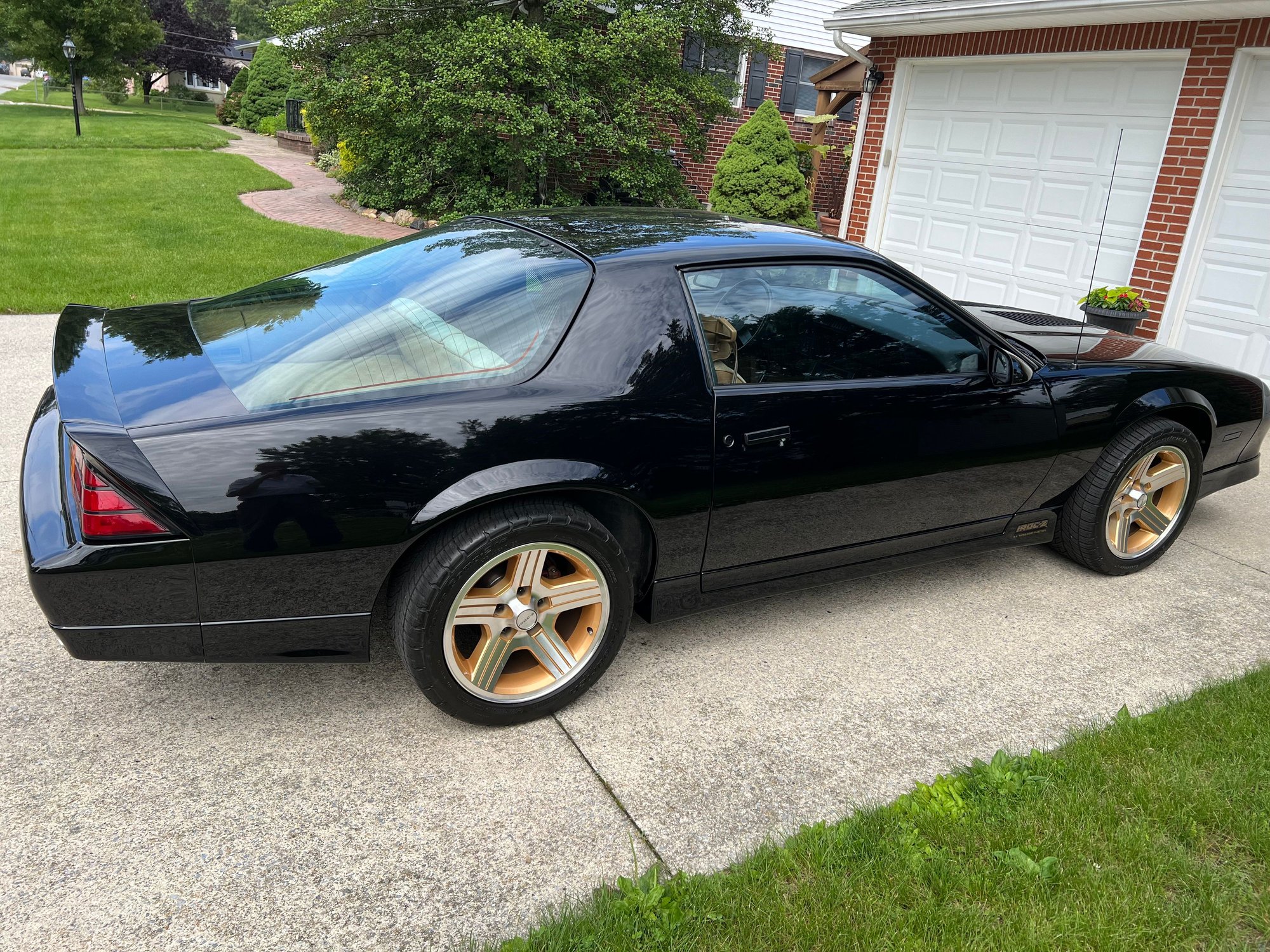

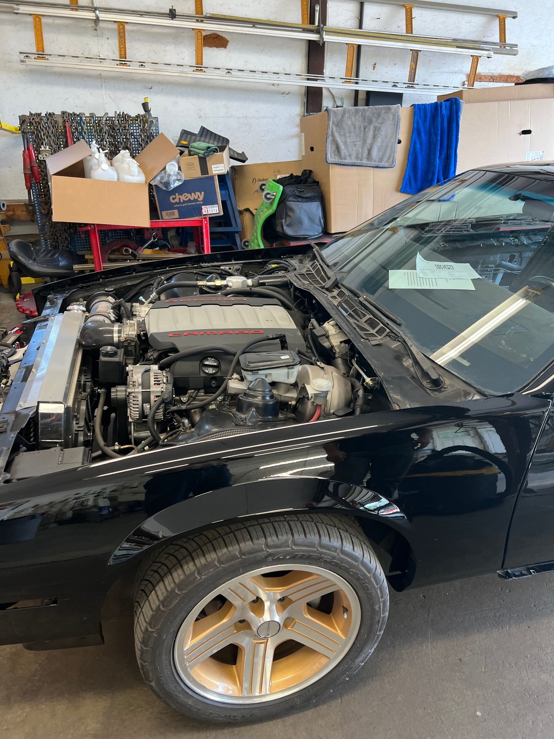

More pics
