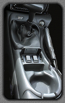

Old Jan 29, 2002 | 06:39 PM
Jims83TA's Avatar
Posts: 708
From: Long Island, NY U.S.
here is a pic...i think it is 86firebird's...the guy who painted his TA the prowler orange that looks like the 4th gen. He has the two switches in a 6 speed console...i personally like teh 6 speed one better...especially since you can have such better placement of the switches...it looks clean and as if it belongs in the car. DOES ANYBODY KNOW IF YOU CAN USE THE CIGARETTE LIGHTER FROM THE 4TH GEN IN YOUR 3RD? HOW HARD IS IT TO REWIRE?
James
Attached Thumbnails Exactly WHY won't an automatic 4th gen console work ?-console.gif
Old Jan 29, 2002 | 07:59 PM
Mongoose's Avatar
Joined: Nov 1999
Posts: 1,790
Likes: 22
From: Monroe,NC
Car: 90 Formula
Axle/Gears: 9 bolt/3.27
I believe that's Nosaints car. I'm planning to do something similar.

Old Jan 29, 2002 | 10:36 PM
GndPrx's Avatar
Posts: 528
From: Ft. Lauderdale, FL
All 3 switches will fit exactly end to end with no gap between or on the sides...
And regarding the cig lighter, you can cut the wire harness off of a 4th gen. It's just 2 wires +/- to a pigtail to each lighter outlet for the 97+ that has 2 lighters.
