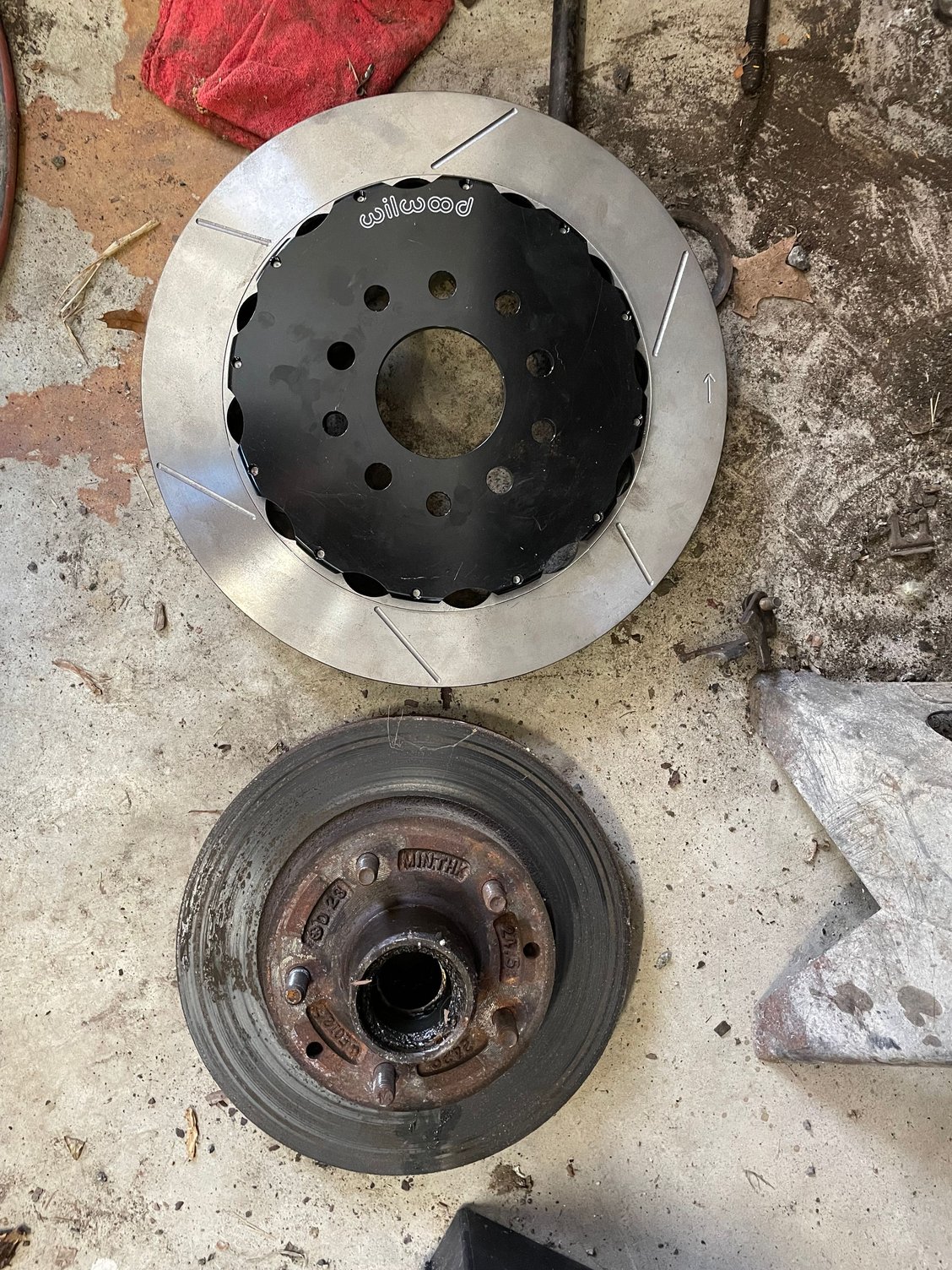

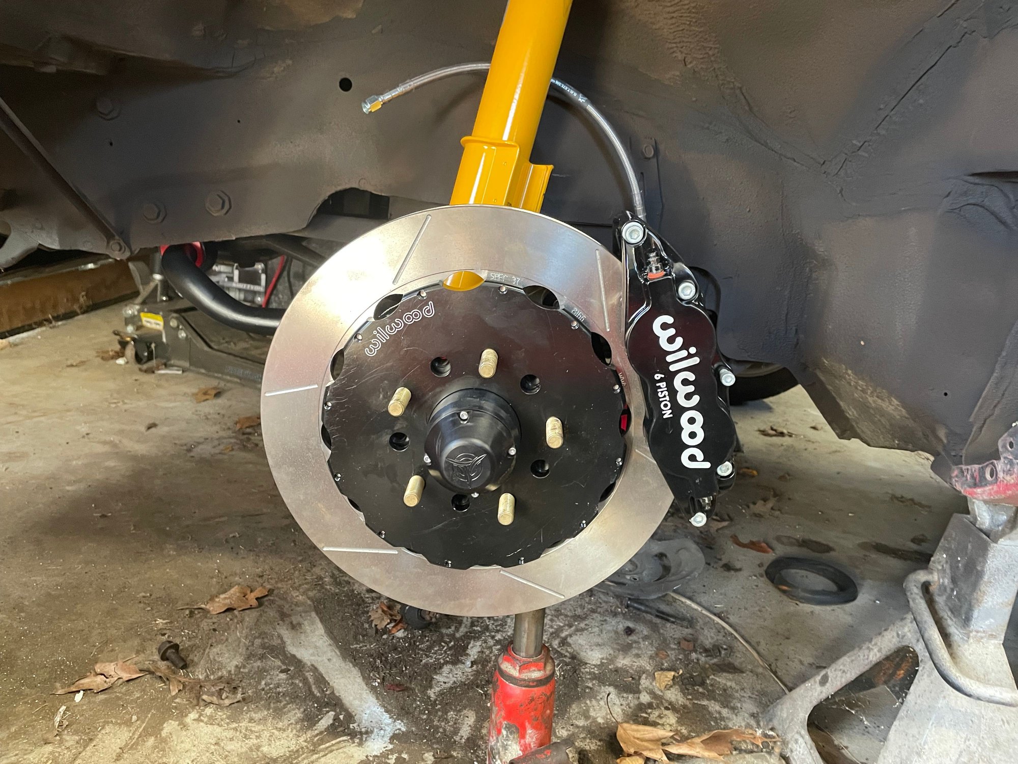

I have a set of Wilwood brakes up front and they are might and day better than the crap factory stuff and are half the weight. Install was as easy as could be. I use mine with a manual brake kit as well and the pedal feel is solid, brakes don't create too much dust but there are other compounds of pads that will bite harder than the ones I'm using. And lastly the rotors on these don't ever seem to wear at all they've been great since I put them on

Nothing wrong with Wilwood for street. I have 6p up front and 4p in rear. Rear e-brake is doable - everything is if you are determined. Listen to advice, then do your own informed thing.
Here is mine as it sits for this winter on Michelin PS4's all around - 245/45/17 front on narrowed 8" wheel, 265/40/17 rear on 9.5" wheel. After lots of internal debate, I allowed the 20mm offset as not too bad and got my tire choice.
Correction, the fronts were narrowed 1" to 8.5" by Weldcraft Wheels in Livonia MI.
Here is an excellent thread, enjoy: https://www.thirdgen.org/forums/brak...ake-kit-3.html
DSC00844sm
DSC00848sm
