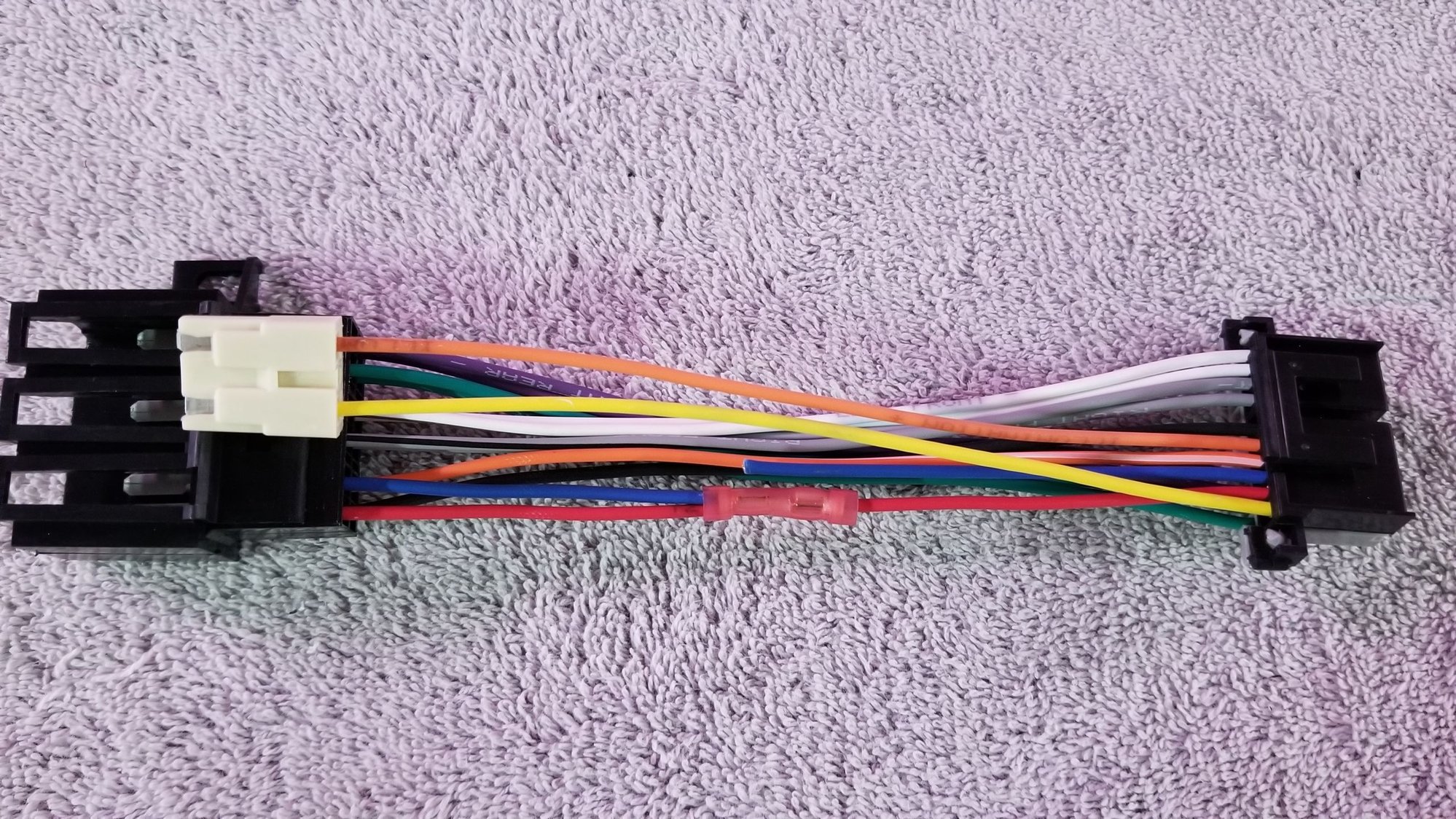

My guess is that your sub's amp is not getting any power. How did you accomplish the wiring from the car to the new head unit?
Here's an adapter harness for installing a 4thgen radio into my 87; I also have UQ7. The connector at the left end fits the car, and the connector at the right end fits the 4thgen radio. The blue wire at the car's end supplies power to the UQ7 amp, but since that wire on the 4thgen side does not supply power(probably not from your aftermarket head unit wiring either), that blue wire had to be cut and spliced into the red power wire on the car's side. I suspect that's your problem.

Pretty sure that would be the PINK wire on the factory plug,... 'switched' power OUT from the radio to AMP and power antenna.

Yes, the blue wire in the adapter harness connects to the car's pink wire. So power needs to get to the pink wire, or the sub's amp won't work.

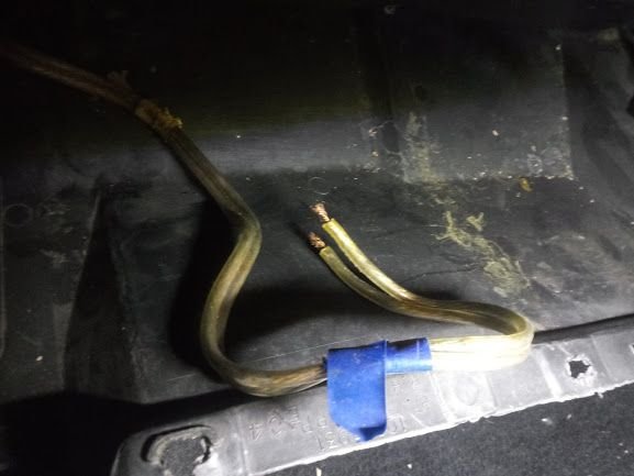

thank you everyone! the pictures and wiring descriptions have been a lot of help. I have the adapter harness hooked up, but the car side blue wire is connected to the blue/white wire for my head unit.
I will probably just use all new speakers and wires in the end but I am curious: these wires with blue tape running near the radio pod and under the pass side, they are for the subs right? do they need to connect to the crossover here in order to work?

The wires you're describing are user-installed not factory. going to have to follow them to find out where they go.

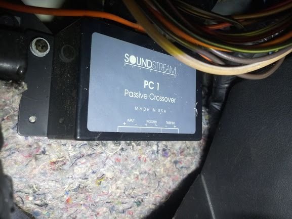

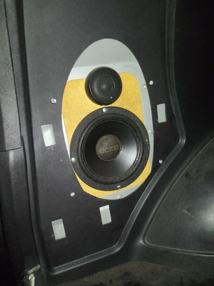

After talking with John in RI, it would seem I don't have UQ7 factory speakers! Pretty much just the amp and wiring harness are left from the UQ7 setup
Looks like these speakers are hooked to a passive crossover behind the board. The wire pictures i posted earlier seem to be connected to this crossover
