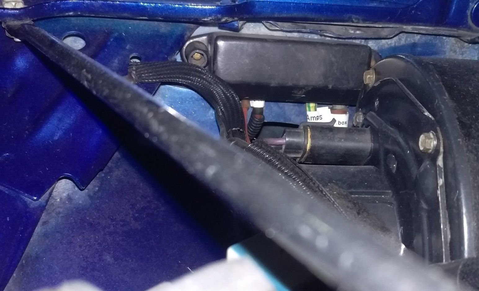

Looks like there may be 12V available at the fuse farm

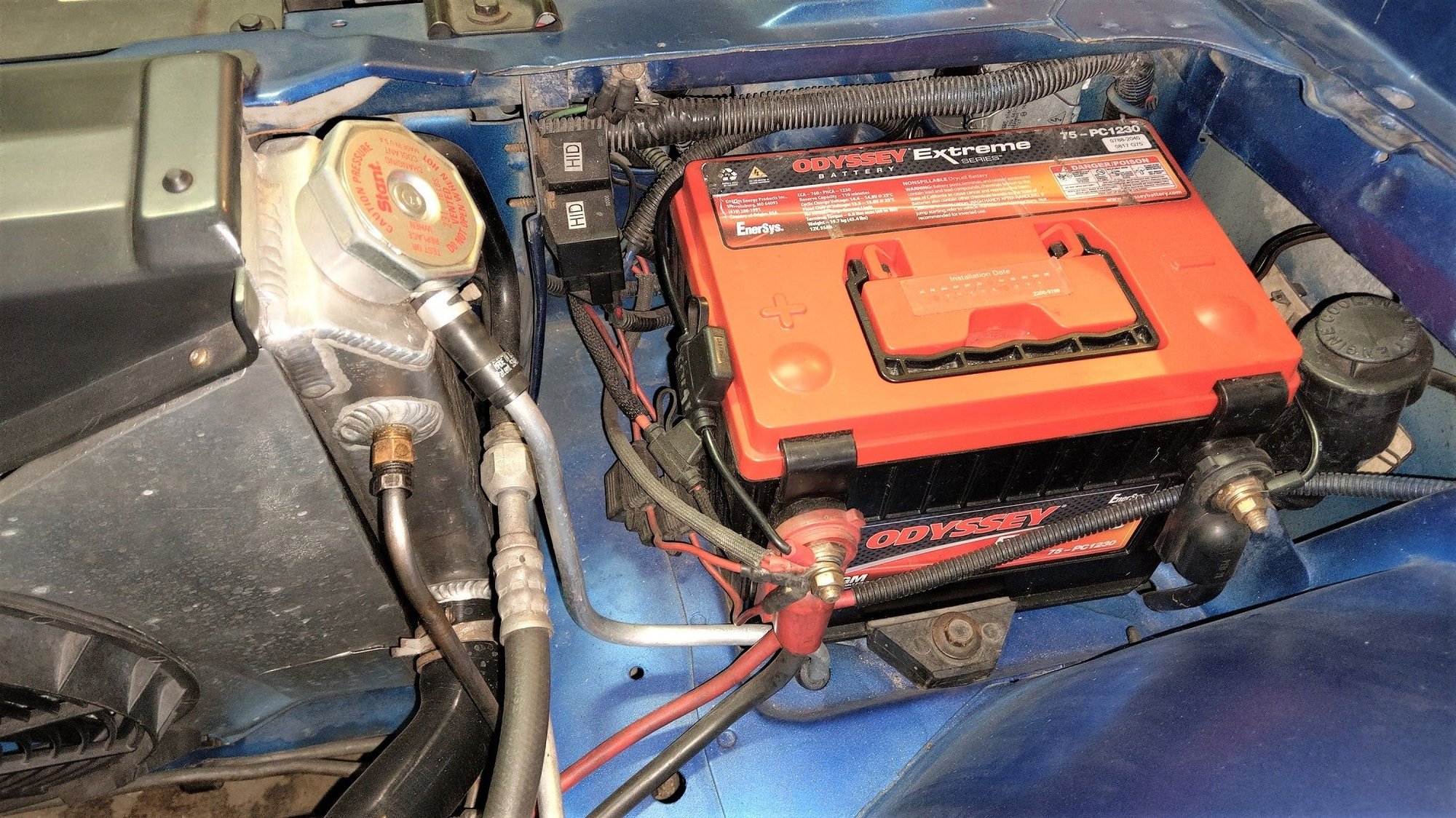

Re: Good spot to grab high current 12V for stereo
Pull the positive center part right out of the cable end.........install one as pictured above.........install power wire ring terminal on new extra threaded stud.

I don't know if it's there on all years/models of 3rd gen, but when I added an amp a few years ago, I pulled the power from the little distribution block behind the battery. Picks in my thread beginning HERE at post 223, and again at 237 and 242.
Interesting. I don't think I have that distribution block. Have to take a closer look. This is the sort of solution I'm looking for. I'm not interested in mangling my prized factory battery cable with some rigged up spoiler thing ala Gran Tornio !!!
It appears your battery tray is on passenger size of TA. I guess by 1990 they moved it to driver side.
DynoDave43's Trans Am is TBI and your Formula is TPI.
On Firebirds the TBI cars have the battery on the passenger side and TPI cars have the battery on the driver side.

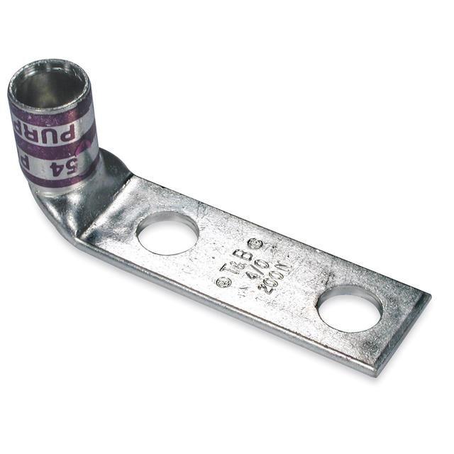

something like this appropriately sized would be perfect. slip it between the battery and battery cable.
That is close to what I was going to suggest next, is an O ring terminal and go between the battery and the cable. You're probably running a smaller amp so a 10 gauge wire to the amp would be sufficient and the yellow terminals are for 14-10 gauge if I remember correctly.
That would be ideal, but I haven't found one that has the 0 portion big enough, and the leg of it long enough to clear the battery post. I would need to be about 1.5" long or so. I may just end up fabricating something from a 1/2" x 3" sheet of brass, drill a hole on one end, and bend up the other end and solder the wire on to it. Or, I could just simply put the bare wire in-between the battery post and tighten. I have similar problem with battery maintainer, so something more permanent would be better.

And somehow you think that would look BETTER than a simple extended terminal??????? YIKES!!! Next thing ya know you'll be asking about the Iroc wheels you just put on your 'bird LOL!!
Since this really does seem to be a visual originality thing for you.........get it on a lift, bolt a new cable on at the starter, run the wire in through the firewall somewhere in the trans tunnel, add a fuse or breaker, DONE AND HIDDEN. All the 'mega' audio systems I've installed through the years had all the wiring hidden except for a short section at the battery. And usually, even a fuse or breaker can be hidden INSIDE a fender or Under the battery tray. Some clever placement of wire loom and it just vanishes.
On my wife's show truck I have triple fused relays UNDER the battery tray wired to double electric fans in a polished aluminum shroud. Wiring to the fans runs under the radiator support.......all hidden. We've had MANY discussions at the shows with other folks trying to figure out what controls the fans and how do they get power HA!

Originally Posted by skinny z
One fix I've used in a similar situation is to replace the battery bolt with a allen head cap screw..
If you wanted to be really stealthy about, you could use a reduced wrench size bolt like an ARP and get it in stainless.
Verify the length first.
