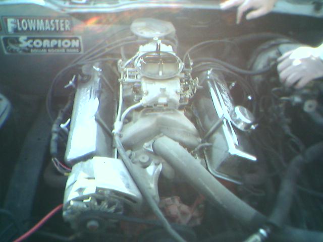

The other day my supervisor rode in my car and noticed that he didnt hear my secondaries open.. I said HMM.. So today We (my uncle and I) had a look and the secondaries are just staying open the whole time...
When I try and Punch it it boggs down for quite some time.. and i have read on here that means its running lean... My uncle said he hadnt workd on a carb. in ages but he said it looks like the linkage from the throttle (maybe) was missing to the secondaries he also said the the secondaries should be facing the windshied not the Nose but hes kinda old (to me im 20)
Heres some Pix
My carb. is a
Holly 750CFM DP
4779-7
3099
Any Help???

Pic 2
Pic 2
Of Whole Engine.. It was kinda bright today Sorry

Your secondaries are facing correctly toward the back of the car. Really need a pic of the linkage. I doubt your secondaries are open all the time. Your idle speed would be REALLY high.
P.S. I would try to reroute that fuel line away from the alt belt.

one more thing.... my vaccum advance is NOT hooked up because when i do it runs REALLY funny... so thats just another thing
you can see the blue cover in the upper right part of the Carb. In the Pic
