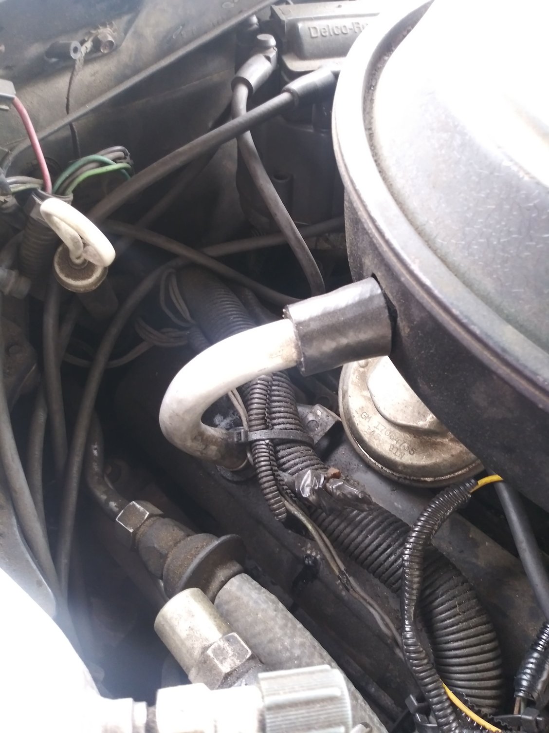

I currently have a closed air cleaner but wanted to switch to an open air cleaner. Having little to no knowledge there is a tube/pipe that runs from the engine to the closed air cleaner at the moment and wanted to know if its even possible to switch to an open air cleaner? My car is a 1985 Camaro z28 V8 5.0L. If any more info is needed will provide. Thank You.

Put a breather there. Run a drop base air cleaner

Ah ok cool thanks for the info. As for the other whole where the silver stretchy tube connects to the front of the air cleaner do i leave it open?
It's for the PCV system and it supplies the fresh air into the crankcase. You can use a chrome breather, it'll look prettier and is easier to deal with but it will emit oil vapor onto the vicinity of the breather. If it's not a an engine you try to keep clean this may not bother you but I became tired of wiping it so I drilled a hole in the bottom of my open air element and connected a line to it. No more oil coated valve covers. Some aftermarket open air elements have a knockout hole you can just punch out and connect the tube or they come with a little, cheap thermostat looking piece to use.

If you look inside the aircleaner, that tube jsut slips onto a breather that's clipped in the aircleaner (clip missing in OP's photo), so the fumes and whatnot are recycled through the engine, ie Emissions. Really you could just punch a hole in the bottom of any aircleaner and just slip the old breather through the hole and hook up the tube/hose. It's just easier to get the push in chrome breather next to the aircleaner and chrome valve covers and hippy foot gas peddle at the parts store. Just make sure the breather is the same size where it pushes in the valve cover grommet as the old tube. Whoa, I almost forgot the ******* boy-racer work around from the 70's and 80's... Just take the breather filter out of the aircleaner, push it back on the tube and swing it out of the way... The things you'd see on highschool hot rods......

I was wondering if I have to take the valve cover off to remove the PCV hose in order to put in a breather. Thanks in advance.

No, but the grommet is probably hard, so you might have to work at it to remove it.
A breather will use a different size grommet.

I used same grommet in several different cars swapping to breathers just have to check the fitment. Yours may be different though, I used a Spectre Performance 4300 3/4" Standard push in breather. Amazon has them.

Ah ok because I gave it a little tug but it wouldn't budge and didn't want to pull any harder without breaking something. Thanks for the advice.
