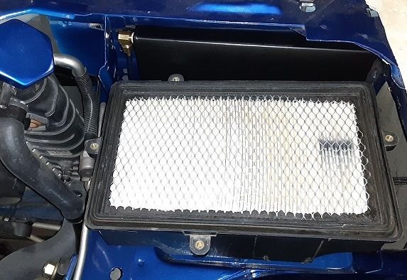

You'll never get it to fit under the tray and even if you did, the filler neck would not be very accessible.
My pass side undertray is already occupied with electricals and I wasn't interested in cutting the car
or modding another 4thgen overflow filler neck to fit on the driver side so... I made one to fit under the
radiator support lip and it is hidden out of sight when the filter box is put back in place. Exactly like I
wanted it. It holds 2 quarts. It is only test fit in the pictures.

1LE, I believe he literally wants the entire 4thgen tank (completely) under his current metal batt tray w/o cutting anything on the car and the filler neck poking up thru the side fender/frame rail opening (or so I gather).

Re: Overflow tank under battery tray?
Deadbird,
I really like your design!! That looks amazing! I may end up having one made similar to this, but with a filler neck of some sort (it may be small, but useful lol). Thank you very much for the idea, and feel free to make me one too!! haha But seriously, you wanna fab one up for me? I assume there is another 1/4npt fitting on the bottom somewhere, right?

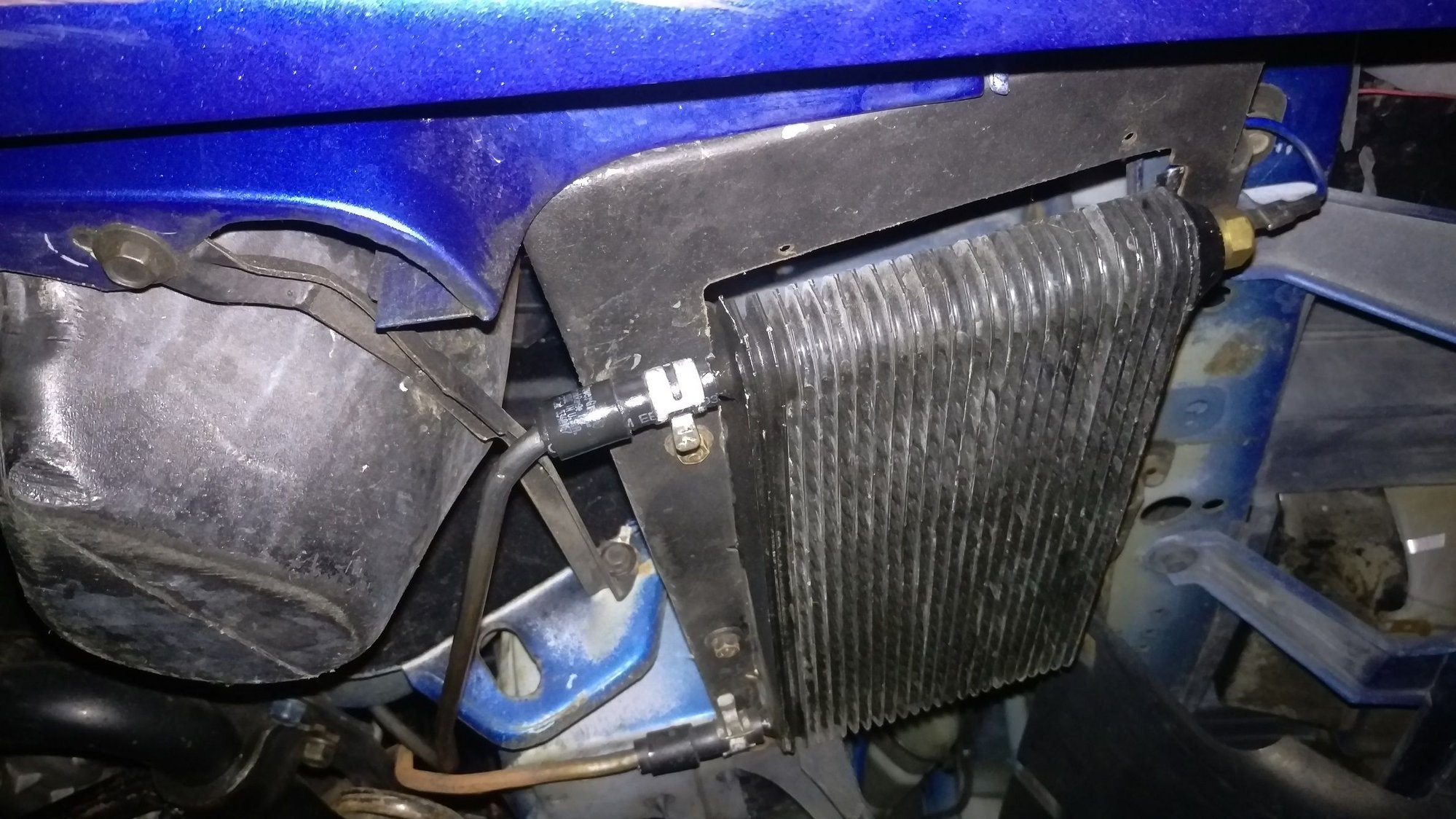

Thats how mine is mounted. From above the original battery hold down bolt doubles to hold up the 4th gen part below. Opposite that (not visible in pic) there is a 10mm bolt from below going up into a stock threaded bung on the 3rd gen batt tray to hold the expansion bottle up on that side.
Originally Posted by potterc32
84-1LE,
I am still intrigued about how the install actually took place. Did you remove the triangular shaped fender brace at the bottom? Has any sheet metal been cut for fitment? and Where does the filler neck come up? I tried like hell to make one fit. I even cut off the battery tray portion for more room, and still had a lot of trouble. This one is now, unfortunately, unusable. But would be willing to try again If I could see how it was done!!
Thank you both for the help!
If you mean that thin v-shaped bar, no, but i did have to tweak it. Here's my original thread, but the pics may not be up anymore. I know i dont have them any longer.
https://www.thirdgen.org/forums/body...her-fluid.html .It started as 4th gen windshield washer tank, but i added the 4th gen expansion bottle to it.
No cutting of any sheet metal. Only cutting was to the 4th gen piece

Well.. I'll be dammed. Apparently I had some stupid stuck in my eye to see you posted to his other thread , too. (I don't frequent A&D much).
Seeing your pics and despite owning a 91 for quite a bit, I forgot that underside the nose was open on the Camaro.
It was the final reason I abandoned the 4thgen tank on the 'bird.
potterc32
Due to some workplace changes, I don't (currently) have the ability to weld aluminum anymore and arc welding aluminum is no easy task (for me) since it's not something I have a lot of hours in doing.
Yes, there is a fitting behind the 'fluid level sight tube' that allows it to connect to the radiator and one at the top on back for venting/boil over.
I considered something for fill but, in a proper sealed cooling system, you really should never need to add coolant.

I think one could make it work on a bird with a little work. The bottle doesn't stick out past the gfx much. You almost have to get down the gfx level to see it.

Fender shouldn't contact the bottle, even at the bottom.If it is, then something is off. The v shaped brace at the bottom was modified for clearance, not to move the fender away from the bottle.
